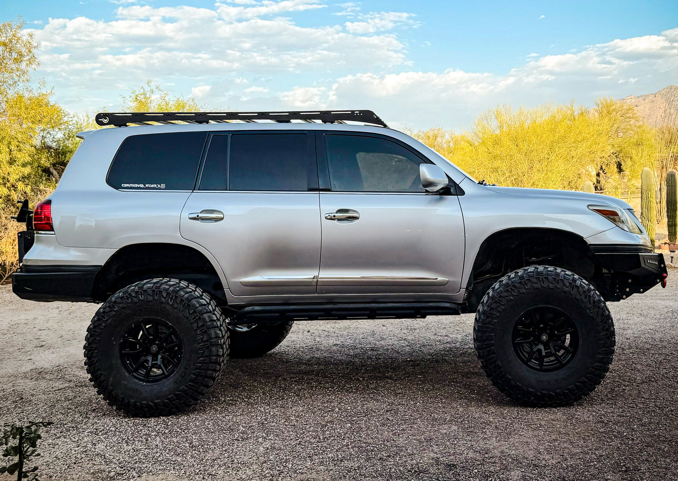

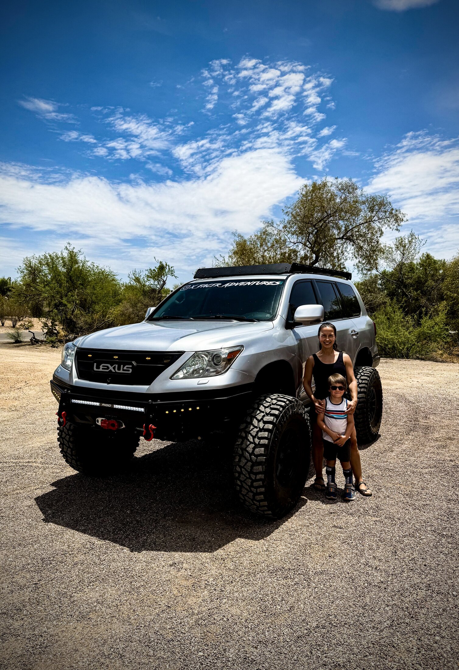

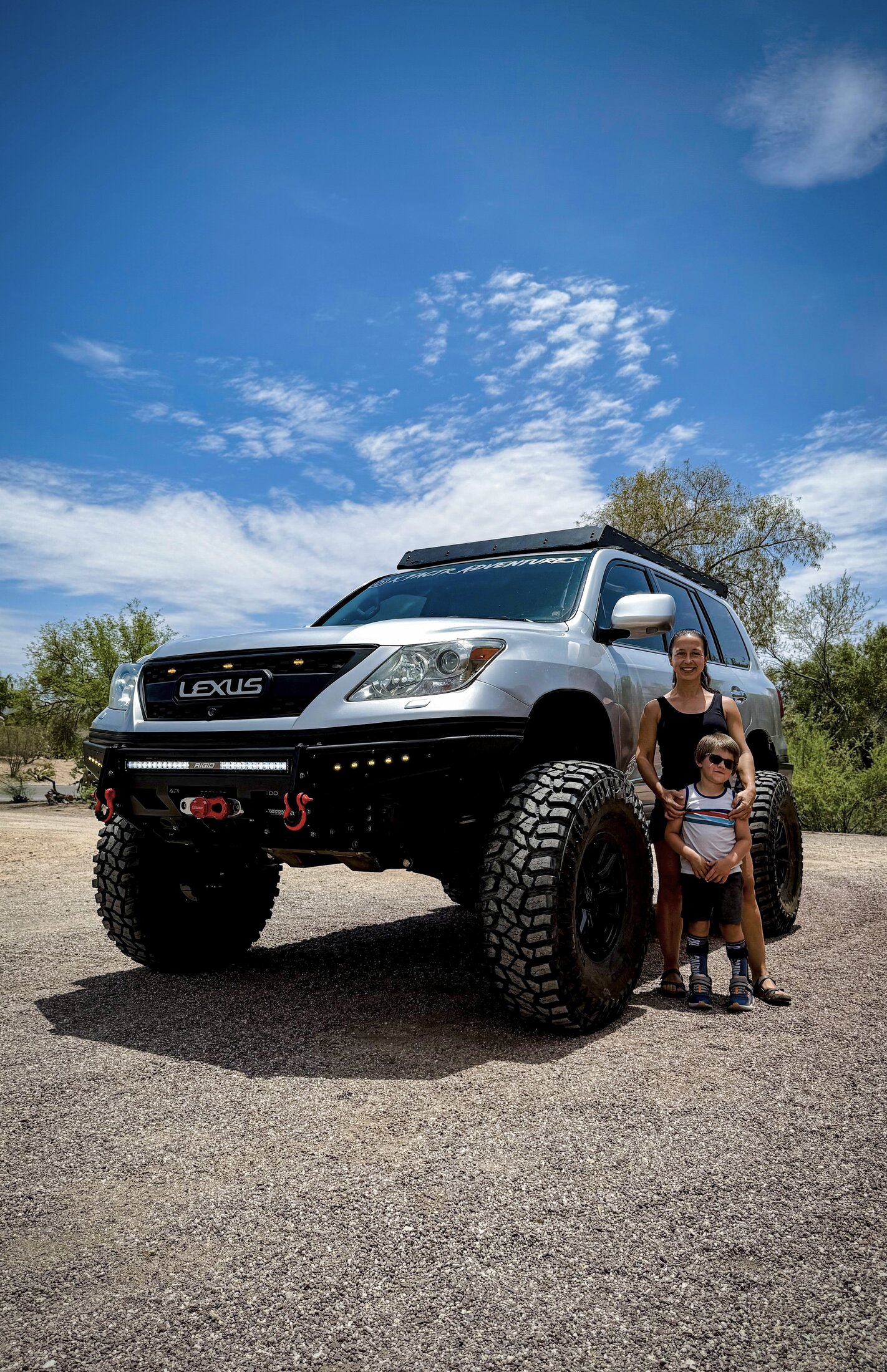

Got my portals and 40’s installed.
that sum poke raight there
Man I am so excited to see this! Did you stick with LX570 arms (not Tundra)? Hows was the clearance at full bump?

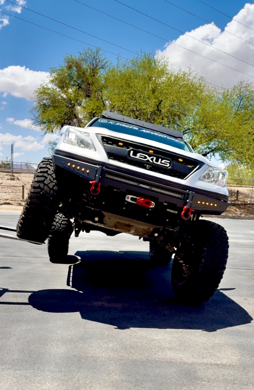

Ok AHC experts. Did a shake down run of the portals and 40s and swayed like a boat in a stormy sea, and bottomed out just going up steep inclines. I’ve added westcott preload collar lift already for support, and LX 450 rear springs (higher spring rate).
Have I just exceeded the capacity of AHC? What say you??
