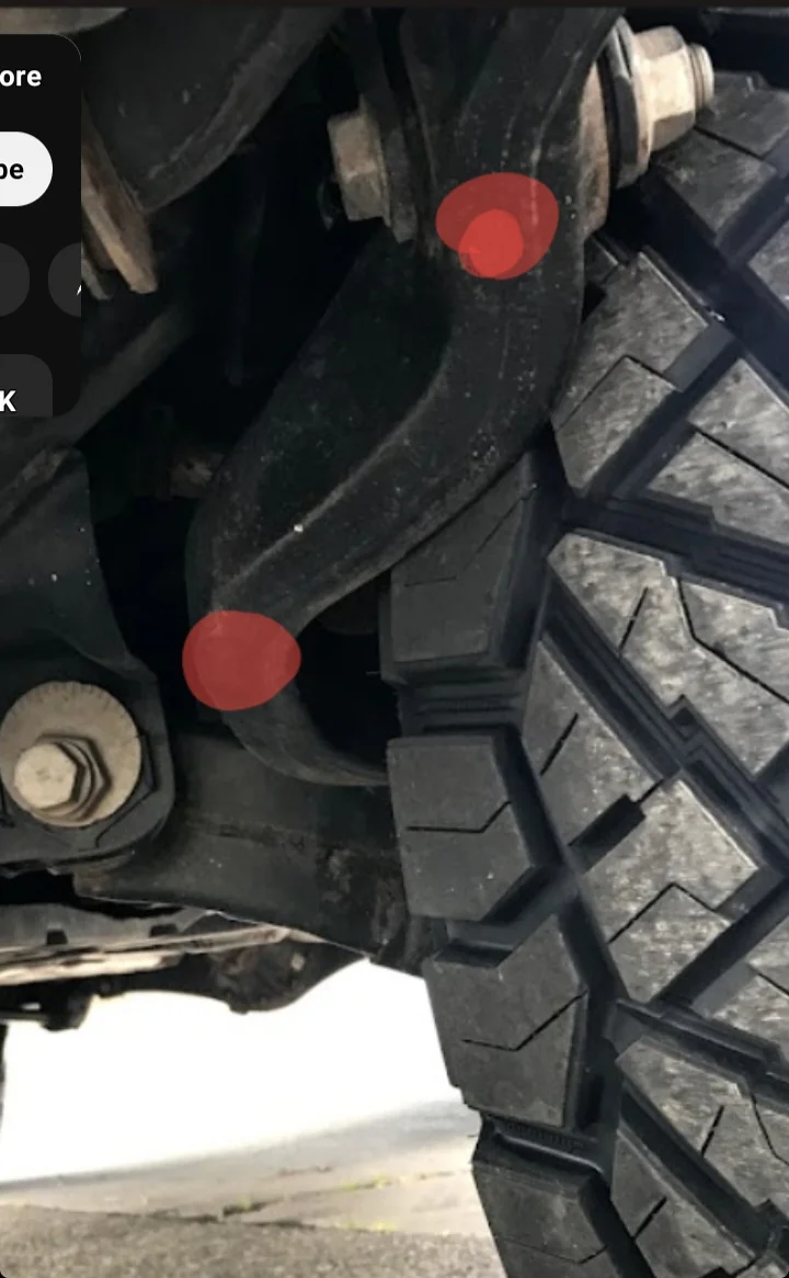

Not sure I'm understanding the 23mm cut and weld. If it's what I'm thinking, it'll change the motion ratio and effect the stiffness that KDSS imparts. In my mind, it'll greatly increase KDSS tension on the control arms which is probably not what more hardcore off-roaders want.
Seem to me, the standard relocation bracket is still the better solution. Combined with a modification to mount the end link out the outside of the basket of the LCA.
You'll need to do much thicker than 1/4" to handle the forces on the system. Note that the factory bar is approximately 1.25" thick in most places.
you are right, right after i hit post i was thinking 1/2" at min.
really needs a straight line between red dots. All mount holes still in same place .
And the lca bracket for kdss link.
Could it be modified so spaced out slightly to reduce binding.Like halfway between standard and on outside of bracket.

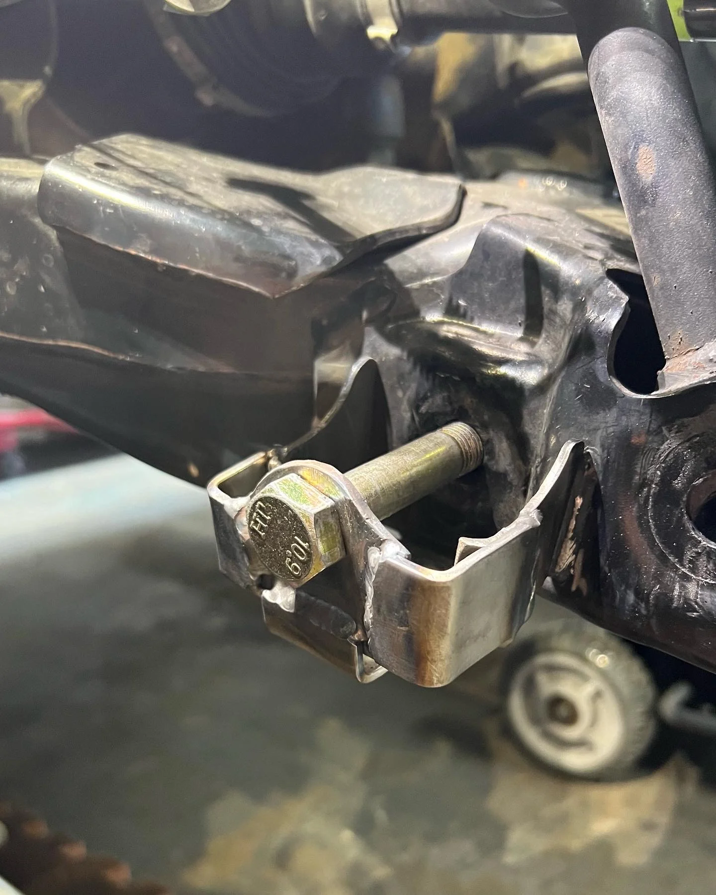

As you’re gathering parts, I’d recommend folks look at modifying the tundra LCA to double sheer the sway bar by extending the bucket out. I wish I had done that before installing as welding it up on the truck was a pain.
Could you please share a picture of your modification to the bucket? Thank you!

Thank you for sharing the pic, it's very helpful! With the bucket modified, about how much further out does the link now sit from the LCA? Half an inch?
The pic looks like you've fine tuned the link's distance from the LCA to minimize binding--achieving an angle better than mounting the link inside or outside an unmodified OEM bucket.
Plus, as you pointed out, you have the added safety margin of a dual-shear mount for the link.
