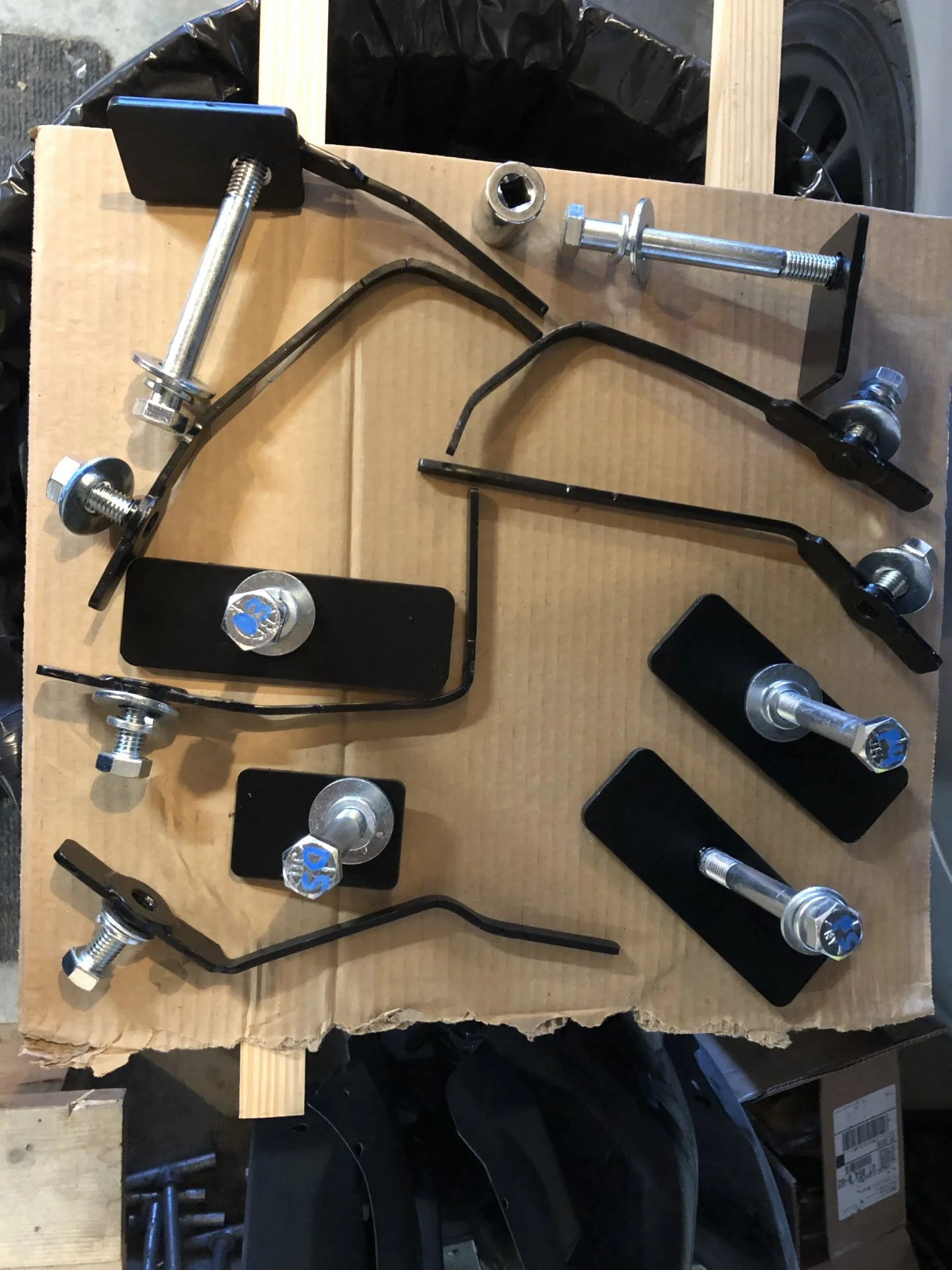

I didn't see any specifics about how they mount but it appears they just bolt to the outer frame rail somehow. If so, you'll likely just rip the bolts out if you hit them hard. If they use u-bolts the mounting system will be stronger but the brackets will need to hang a bit below the frame rail and turn into anchors. Other sliders sandwich the frame rail or wrap under it putting the most important bolts in shear.

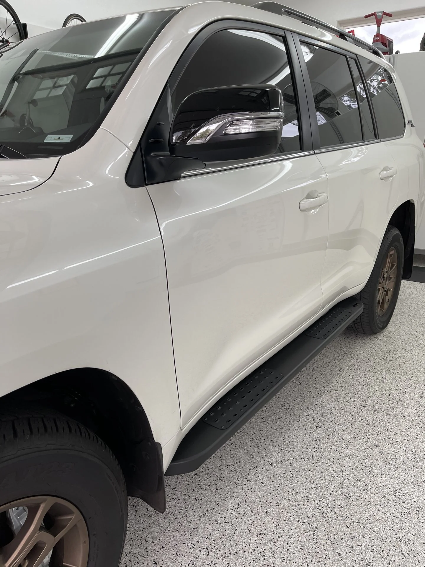

Just got the Slee sliders added last week. 2020 Heritage. I’m very happy and the customer service was top notch!

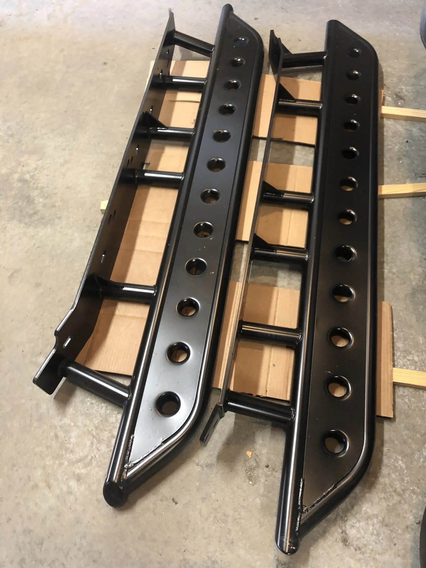

The outside is a massive continuous 3/8" plate. It is sandwiched to the frame with a combo of captured nuts on "lollipop" fitting, and through-bolts to 1/4" thick plates. The bolts are 5/8".

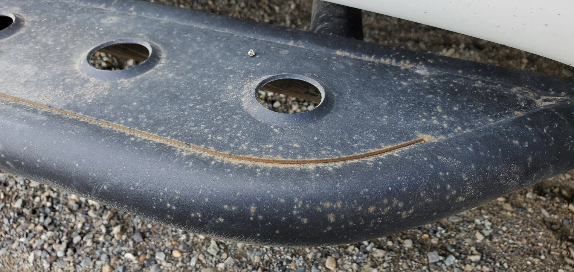

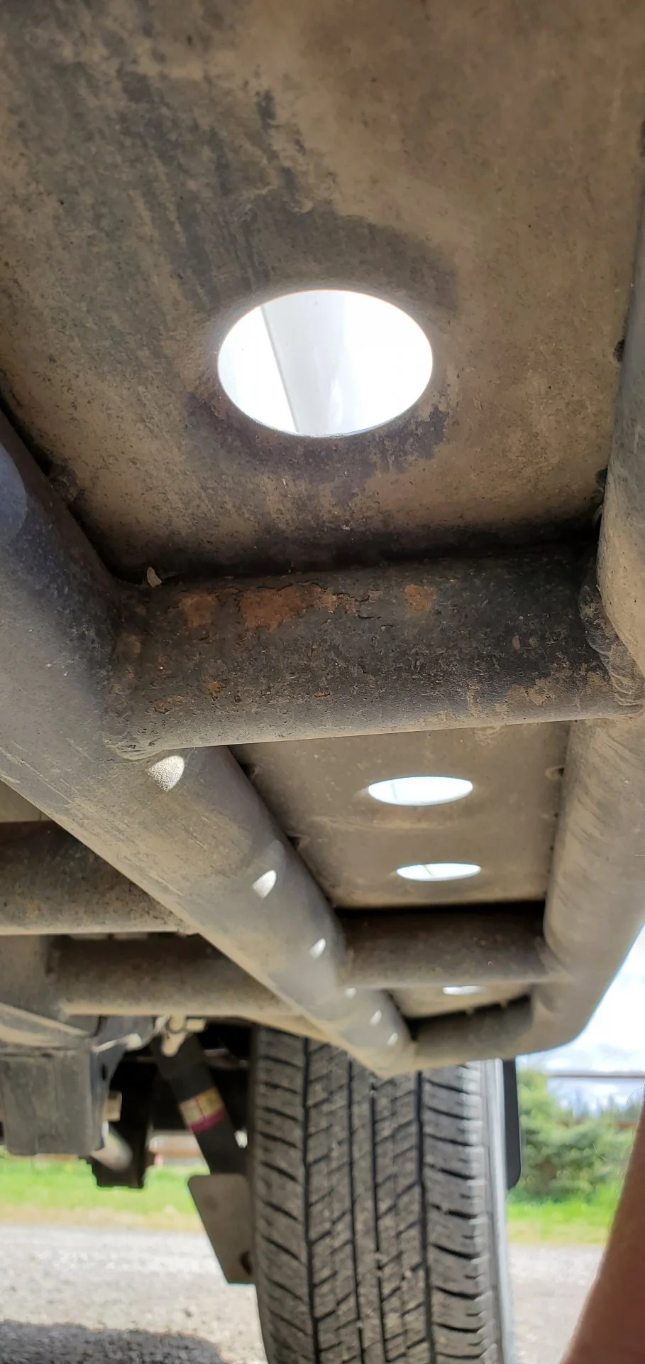

The finish on my Budbuilt sliders has been a bit lacking to put it mildly. This is after about 4.5 months of strictly on road use (with the exception of our gravel driveway). I'm still in the process of resolving this issue with Budbuilt. I have confidence that it will be made right.
The blame, if one wants to call it that, appears to be with whoever applied the finish be it paint or powder coat?
@RET2 I had the same thought.
@goldwater58 Someone else had a set that corroded quickly too and posted about it here recently. In their case, if I recall correctly, they were purchase with powder coat from Budbuilt. I think the issue Rob mentioned was too thin a coat of powder? They stood behind the issue, and Rob drove several hours to swap them out with a new set. If yours were purchased with powder coat already on them, have you reached out to Budbuilt? My perception is that they really stand behind their products and take care of people. If someone else finished them with paint or powder, I’d contact the person that did that work to see if they’ll stand behind it.
Also, fwiw, that photo above was my first set of Budbuilt step sliders. I had them prepped, primed and painted at a local body shop with etching primer and Imron auto paint. They seemed to chip pretty easily with stones blasting them constantly. They also came out more shiny than I was hoping for. I bought my second set powdercoated by Budbuilt’s coater. They’re a bit more flat, and the finish seems much more durable.
I had the finish applied by BudBuilt (or whoever they sub it out to). I did reach out to Rob and he mentioned some sort of refund, but I haven't heard from him in a few weeks since then. Again, I'm confident that I'll be taken care of.

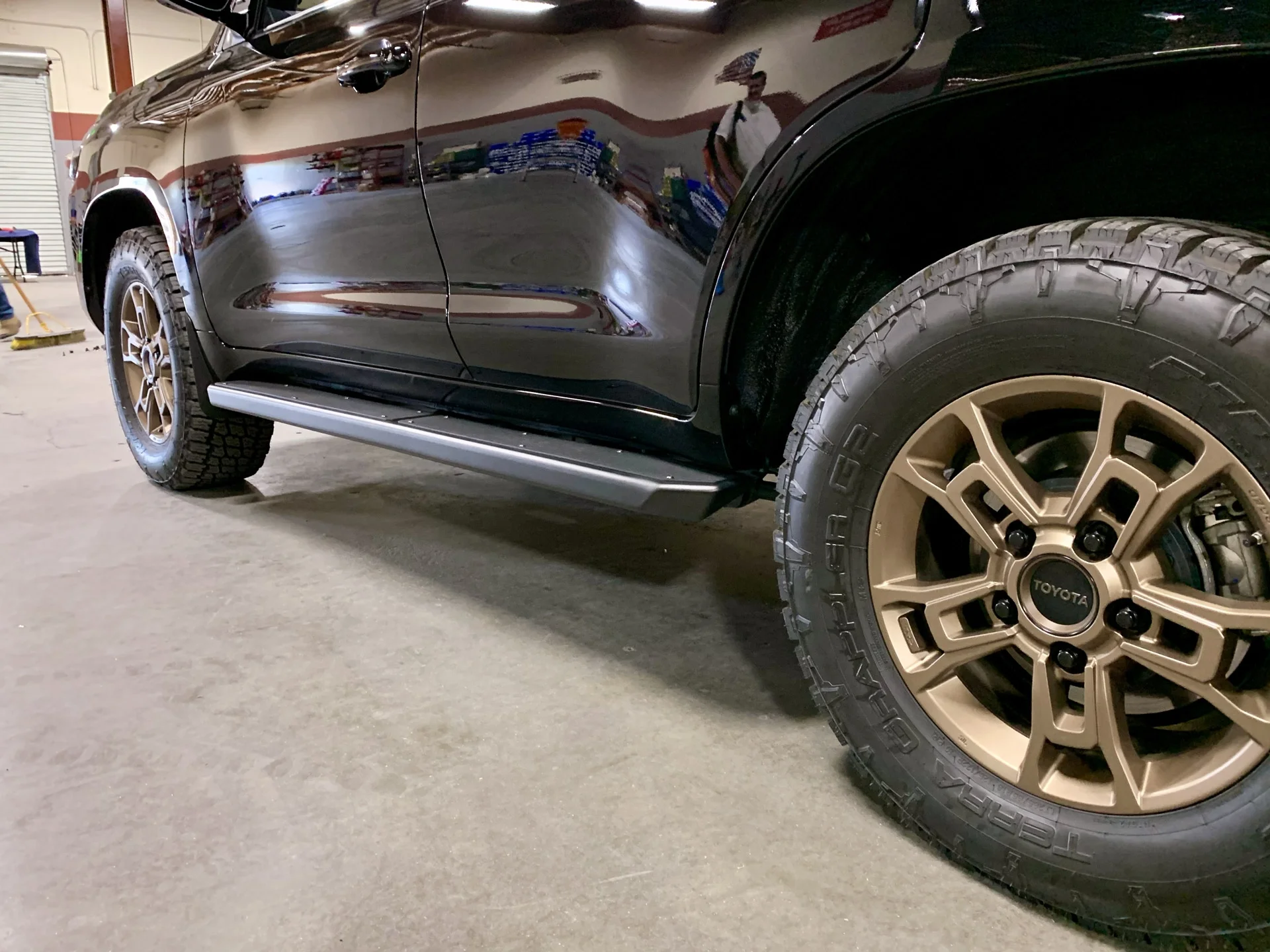

Filip from Dissent Off-road here,
Just wanted to chime in since this thread has been revived. Dissent Off-road makes aluminum step sliders for the 200 series. The frame brackets are steel, but we make the actual slider out of aluminum to save weight. Each side weighs 45lbs. Everything Dissent Off-road makes is manufactured in our facility in Colfax, CA, 100% Made in the USA.
And they do hold up off-road pretty well:
