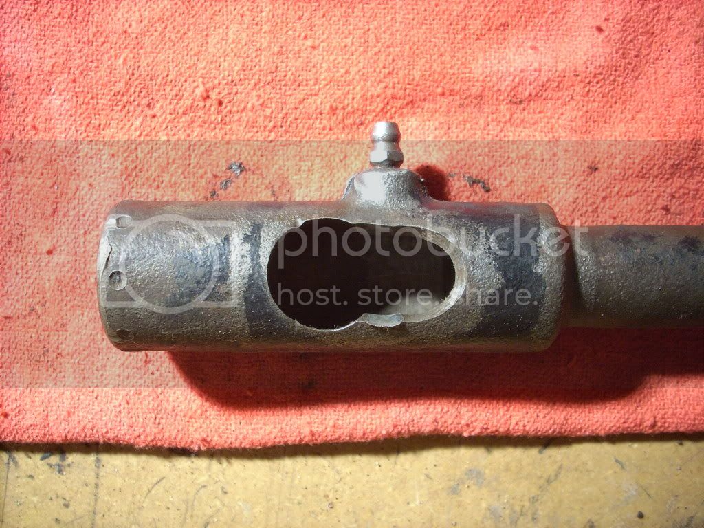

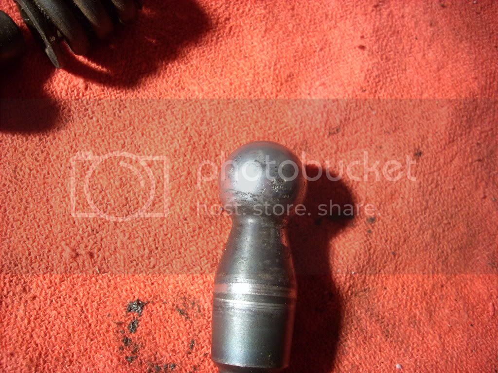

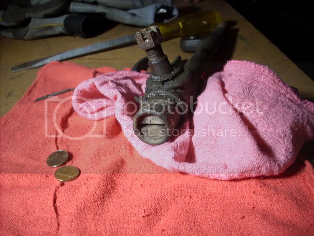

I was cleaning up in the garage last night and saw the relay rod end I replaced last week. I'm waiting on parts for all my projects so I tore it apart and took some pictures
Grungy but it's was going in the trash so I didn't fool with it too much
Pull the cotter pin out and unscrew this thingy

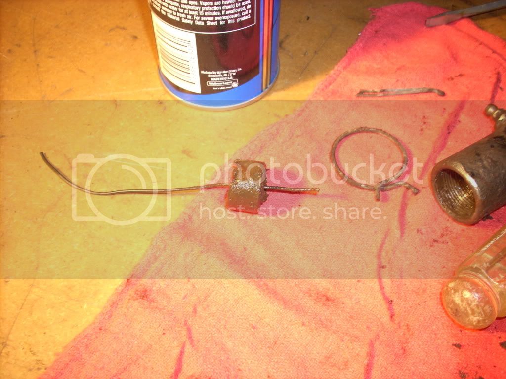

The parts were pretty much welded in mine, luckily I had the factory SST needed to remove the inner ball seat. (Don't be fooled into thinking it is a piece of bailing wire with a hook bent in the end.)

I'm really glad I replaced this.

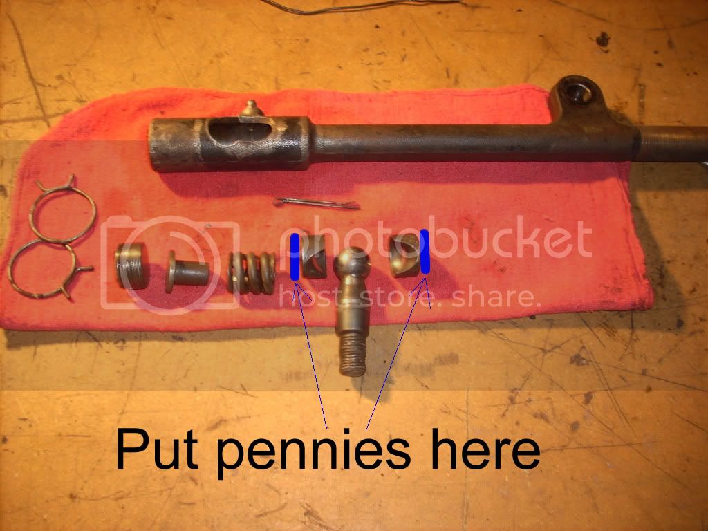

Okay, this isn't rocket science here is a sketch that shows where to put the pennies. Just take it apart and clean everything up. Put a penny inside the housing, install one ball seat, grease, install the other ball seat, grease,put the other penny in install spring, grease, install the Tee shaped spring seat, install the screw cap. Tighten until the screw bottoms out then back off 1 to 1-1/3 turn per the FSM, install the cotter pin. Done.
All they do is compensate for wear in the spring.
When do you put in that thing with the galled ball on the end?
It seems to me that the pennies are just going to make the screw bottom out sooner and regardless of the pennies, backing off 1 to 1-1/3 turns sets the spring tension, no matter how worn out the spring is. If the spring's in that bad of shape, maybe only back off 2/3 of a turn.
My thoughts also, however the right-hand penny (in the pic) would actually move the ball thingy physically to the left (aft wrt to the vehicle) by the thickness of the penny. The left penny would be the one to compensate for the reduction in spring load due to age. So what does moving the ball thingy aft do to the steering?
Also, how does this stay sealed (around the ball thingy in the slot)? I don't see any seal but I do see the grease zirk.
