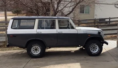

After years of saving and searching I came home with my first 55 last fall. While I was buying some parts I came home with a 2nd pig that was in even better condition (less rust) than the first. I used up all my hobby funds buying the 2nd one until some recent overtime has put me into business staring my first build on the 73. After i get her road worthy I’ll put some better care into the 69 like it deserves. I spent the last year reading all sorts of great build threads here on mud to help me get motivated and better informed. Now its time to get my project going.
The grey 73 will be my first project, to get it running reliable enough to drive to the trails.

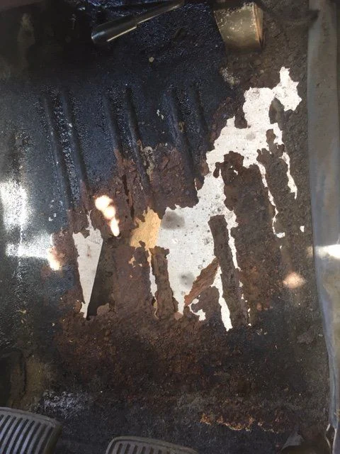

- Drivers floor board is flimsy, with carpet glued over a large soft spot, same on passenger side.

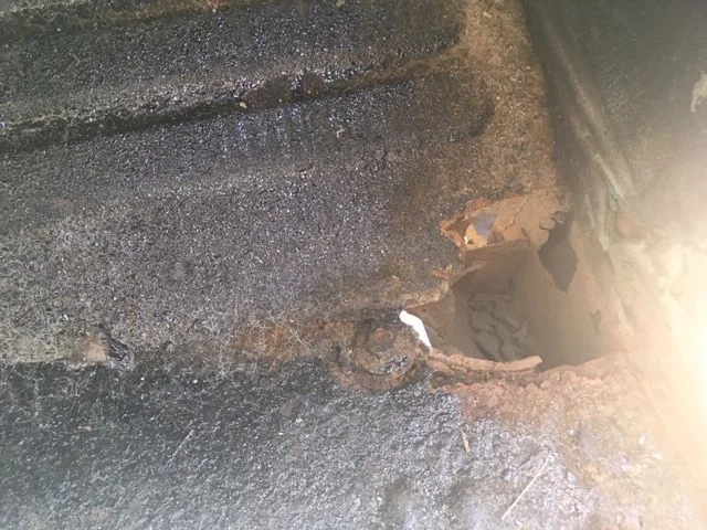

- Body mounts un radiator are solid
- A Pilar Mount on passenger side is completely gone
- A Pilar mount on driver side in 95% rusted away
- B Pilar support is a sheet metal structure that is solid across the frame but rusted away on both sides as it approaches the rockers. So no B Pilar support on either side
- C Pilar support from frame to body under the rear seat looks solid on on both sides
- D Pilar support under tailgate is completely gone on both sides. Body is resting directly on the chassis

Here is what is under the drivers feet. Pretty much gone.
Passenger not quite as bad.

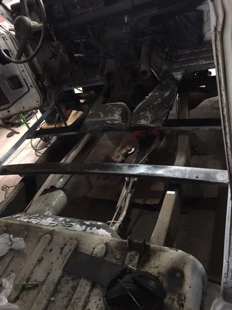

Time to do some cutting.

So i got busy with the die grinder today. Getting as much done with time off work as possible. I cut out all the rotten flooring that was pretty cancerous. Started fab on floors with the bead roller I bought few months back.
We’ll see how it all lines up this week...I hope.

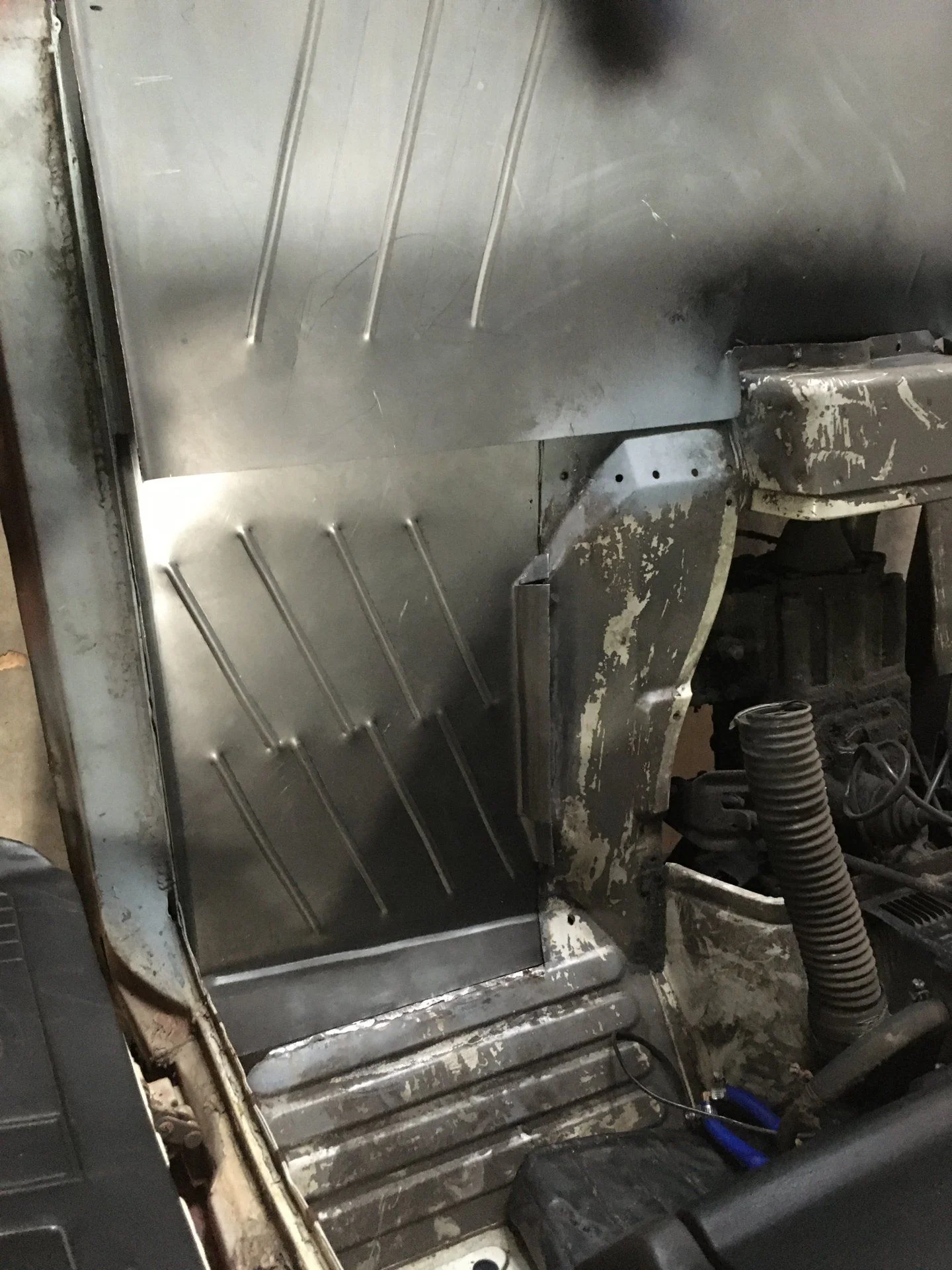

Well I got my floor panel fab done, the fit is good enough for this build. Took some time figuring out the bead roller (19” motorized from Eastwood) and what i really learned is it is going to take a lot of time to ever be any good. But these are good enough for a trail rig.

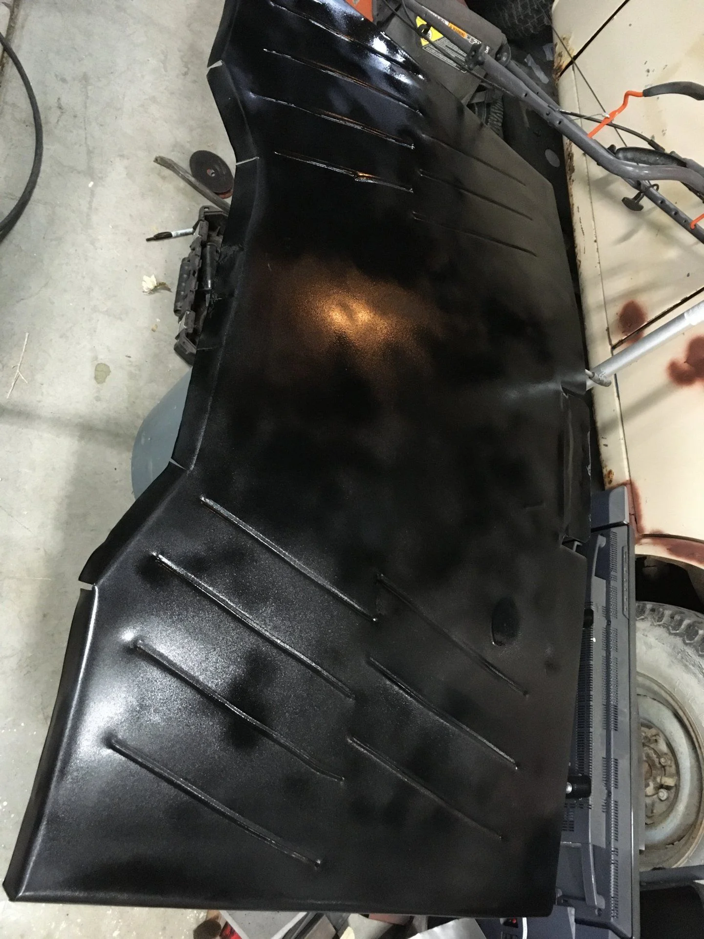

My biggest lesson learned (besides keeping bandaids and super glue around when doing sheet metal work) is welding 101, clean metal!!! I thought i was clever and painted the bottom side with a self priming truck bed liner. I dirtied up all the welds RUSH55 nailed it on the grinding wheels adding up. Used the 6 i had to smooth out some ugly welds.
Here is the bottom of the big pan after painting, it WAS a proud moment...
It still looks good from underneath, just contaminated the welds something fierce, and i am already not a very good welder.
