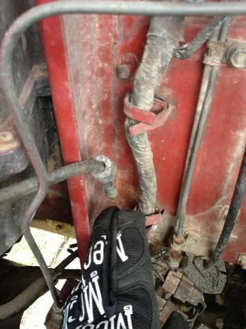

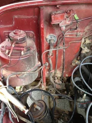

Mystery hard line - why is this second line that appears to come from the gas tank just hanging loose in my engine bay? There is of course a primary fuel line, but then there is this.
It is the hard line that is between the red vertical seam on the firewall and the wire bundle coming out of the firewall. Close up here:
Looks like the fuel return line, which is missing due to the Weber. Doesn't really look like it's in the right spot though. Where does it go on the other end?
It is most likely a return line, or some other part of the '76 emissions control system. My truck has a hard line or two chopped on that side too, since they were incompatible with the 350 SBC.
There's a clutch hardline right there and charcoal canister hardlines on your firewall right there too.
But that line with the flare nut is a fuel line, either supply or return. Can you trace your supply and return lines and post up some pictures (including the fuel filter and fuel pump)?
I have a return line that is no longer being used right there as well. I have a Trollhole carb and no need for the return! I capped mine because I'm too lazy to trace it back right now!
Yes, It must be a fuel return line. I have a Weber carb in there - very good subzali! Makes me darn (sorry anti-cursing filter) nervous when I see all these loose connections.

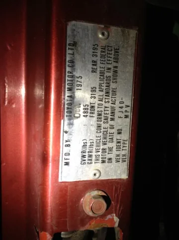

I assume you mean front disks? They never had rear disks, stock, to my knowledge...
I believe they changed over to front disks just prior to 1976, I believe it was around September of '75. So sounds like your truck might have just made the cut. Just like my June '75 just barely didn't make the cut :bang:
So sounds like yours would be a 76 year model, built in late 75.
Yip. Yours is a '76. You would have some of the very first disks Toyota (or Araco, more specifically) made for the cruiser. My '76 was April I believe so not even close to the pop out rear vents.
Rear disks? What are you talking about RWB? :wink:
