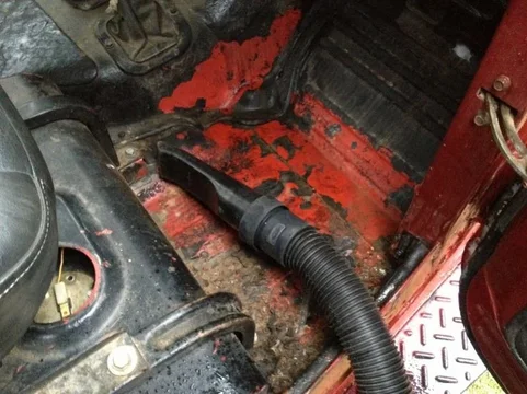

Got the trusty shop vac out yesterday, and, even though it was raining all day, started the work to get the 1/4" of mud and grime out of the bottom of the floorboard. First real work on the 40! I couldn't stand it any more and went after it. Got my rain coat on, put the vacuum in the rear of the truck, and got to it.
First I cut out the old but not original rubber, uni-mat floor mat (Toyota branded - thought about keeping it, but it was nasty, so, nah). Then, started vacuuming and scraping.
Interesting that on the passenger side, the "high quality" black spray tan that the PPO (prior, prior owner) put inside the vehicle just vacuumed right up.
Didn't look much better when I was done, but I was able to assess the floor board and see how much real rust. There is some, but we are pretty structurally sound, so back to worrying about getting it to start, stop, and drive.
