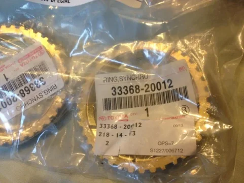

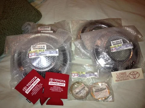

I also sent in an order to Beno (Onur) at Lowe Toyota for 2 synchros for the transmission (no knowledge they were even needed till I got to the point of measuring and when asking about tolerances, some kind folks informed me about replacing the 3 & 4 synchros). Also ordered the hubcaps for all 5 wheels.
Then I can finish the tranny, and put the transfer and tranny back together.

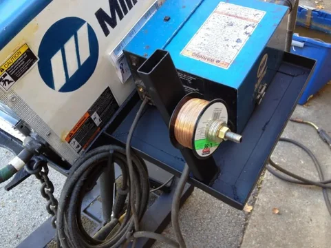

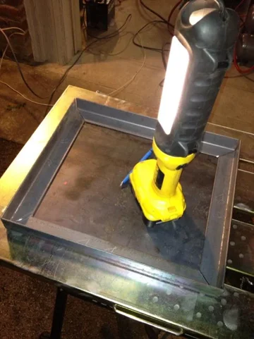

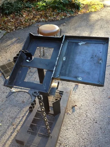

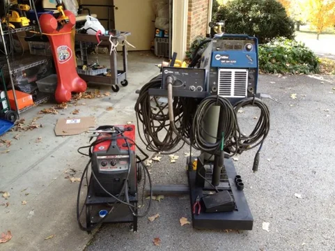

Progress: worked on fabbing up an addition to my welding cart for the Miller S-22A MIG Welder. It sits on the Miler XMT 304 CC/CV Welder so I can now TIG, MIG and stick weld anything but Al.
Waiting on the synchro rings fro the tranny from Beno at Lowe Toyota. He said they shipped Friday from his place (I think. They had to come from Japan).

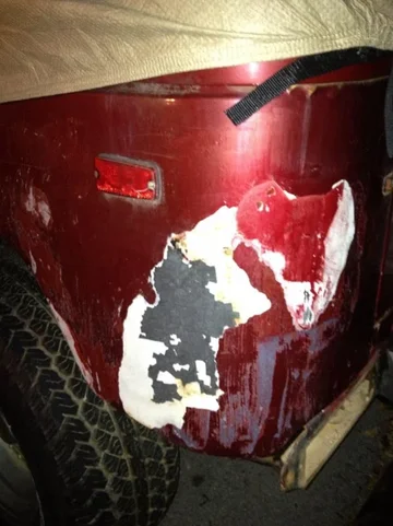

So, in planning on body panel welding repairs, I got some paint strip and tested it on the rear quarter. Wanted to see what's under it in different places.
Bondo city. Nice clean metal beneath that. The PO just did a crappy paint job. Bondo did not like that paint, it chips off in large chunks.
Wondering if I should strip the paint over the winter, weld spots that need it, and cover up bare metal with a rust preventer. Then I could get the last bit blasted, saving me some cash, and get it ready for primer/paint shortly thereafter once it gets warm.
Or, leave as much paint on as possible, weld as needed, blast and prime it in the spring.

10/24/2013 $140.00 $12,985.11 Lowe Toyota, Beno, 5 hubcaps, 2 transmission synchros

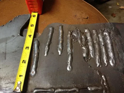

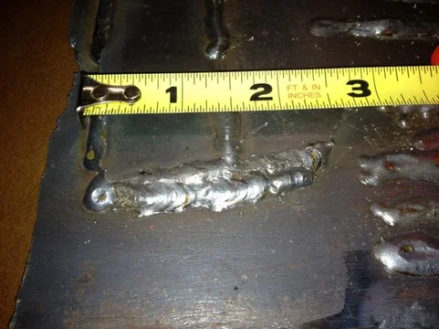

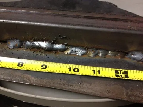

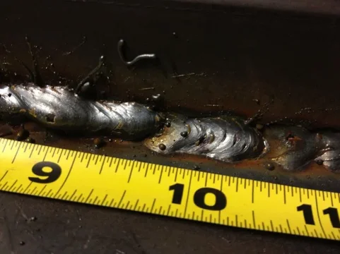

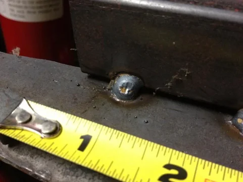

Also finally got my Miller S22-A, 220V/50 amp MIG welder all rigged up and did some test welds tonight. Wow, what a difference a few amps and a few volts makes. I was able to lay down both spray transfer welds and good old bacon frying welds. Took me a few welds to learn how to vary the wire speed and the voltage to get the right bead. Can't stack a dime but who needs to when I can lay down clean beads like these - literally as my first beads. (All you pro welders, shut the hell up.)
Test welds varying voltage and wire speed. 10 ga steel, single layer welds.
Fairly clean, deep, and controllable thickness

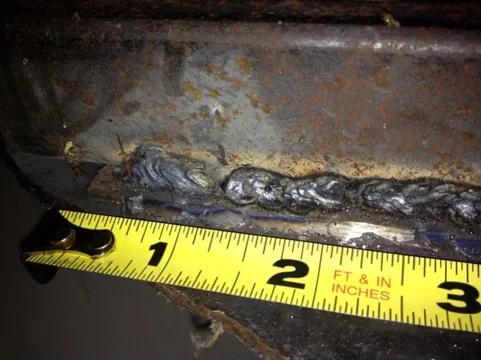

As compared to welds from the 120V Lincoln MIG. Underpowered for this ga steel.
Welds from Miller on opposite side.

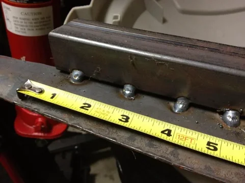

Spot/tach weld over a large 1/8" gap, close up.
Thick weld at 9" mark, thin at 10" mark.
Awesome work VV. My dad is a pro welder and he scoffs at my poor attempt at welding. I remind him that a good grinder can make anyone's welds look like a pro!
Hope you are staying warm up there in Nashvegas. Its cold as a witches teet down here in Chatt.
Hey Man,
I'll be down in your neck of the woods next week for work - first time in Nashville - PM me with some locales for food/booze! Not sure how much free time I'll have but I'm hoping I can get "out on the town" at least a couple of nights.
I'm also going to need to buy a welder soon - or make friends with someone up here who has one. I'm still not clear on the advantages/disadvantages to MIG vs. TIG - I understand the difference between the two systems, I just don't understand when one would choose one over the other.
Your welds looks pretty good! Far better than the blobs my PO laid down on seemingly every part of my truck (remember the power steering nightmare, prior to chopping it off). Heck, even my junkyard bench seat is welded to the factory seat mounts.
