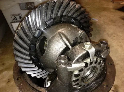

This is my first of two 3.70 3rd members arriving. Yee Ha.
Yea, it is fricking heavy.
Thanks Super40.

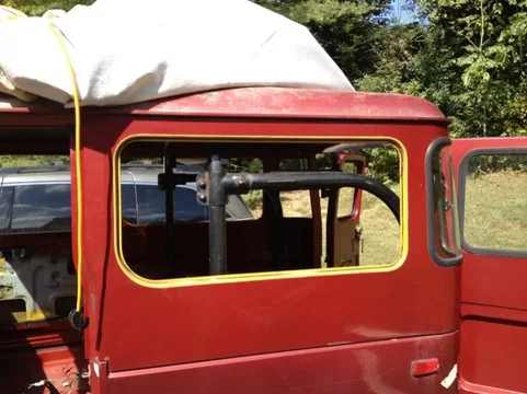

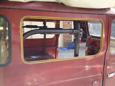

2 Windows removed

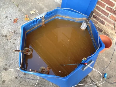

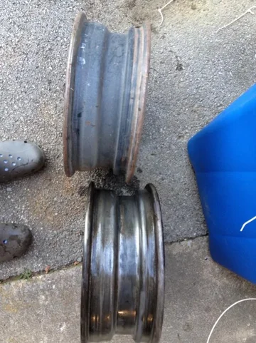

More wheels in the electrolysis tank.
Bought some Arm & Hammer "Super Washing Soda" at the grocery: $3.50 per 3.5 lb box. Cheaper than the pool chemicals by about 75%. Same stuff. Sodium Carbonate.
Finding I have to recharge the tank every time I remove a wheel. Strange. Not getting above 3 amps.

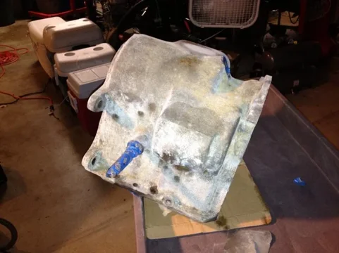

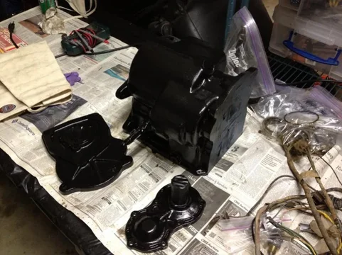

Transmission case painted.

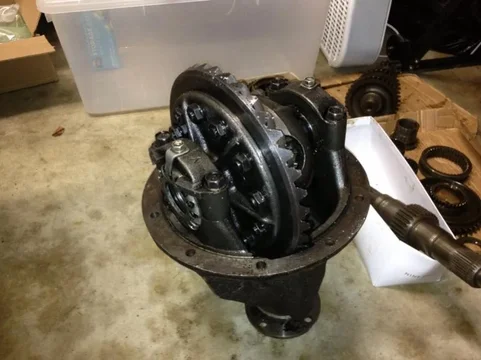

3.70 Diff-in-a-Bucket unpacked. Looks clean.

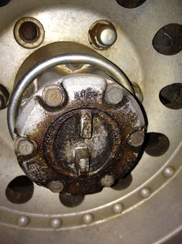

I have this type of hubs - ASCO.
Should I replace with Aisin if I can find some old ones? Going for very close to stock remember.
I believe those are stock for '76. Am I right Tom, Eddy or living in the past?

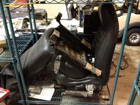

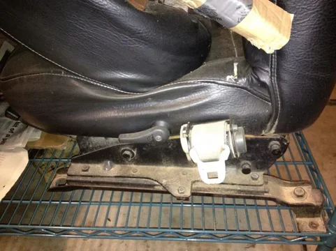

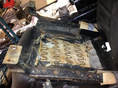

Those seats don't look stock to me. I believe stock seats in 1976 were not full-back seats (no integrated head-rest like those have).
I think you could get adjustable headrests (not sure about that) but the seats themselves were low-back. I also believe the stitching in the fabric was vertical, as opposed to horizontal.
Those look somewhat similar to the aftermarket seats offered by CCOT, but the stitching isn't right for those either...
http://coolfj40.stores.yahoo.net/seatsfj40.html
EDIT:
This is a good example of what the stock buckets should look like for a 76 (I think)
http://www.cruisercorps.com/seat-covers-front-free-hog-ring-kit-1972-1978.html
Those seats don't look stock to me. I believe stock seats in 1976 were not full-back seats (no integrated head-rest like those have). I think you could get adjustable headrests (not sure about that) but the seats themselves were low-back. I also believe the stitching in the fabric was vertical, as opposed to horizontal. Those look somewhat similar to the aftermarket seats offered by CCOT, but the stitching isn't right for those either... http://coolfj40.stores.yahoo.net/seatsfj40.html EDIT: This is a good example of what the stock buckets should look like for a 76 (I think) http://www.cruisercorps.com/seat-covers-front-free-hog-ring-kit-1972-1978.html

Well, no response from them yet, but at least I'll research this before buying any used hubs.
I believe AISAN is the same thing as ASCO. I think I read somewhere that the full company name for AISAN is Aisan Sekei Co. (ASCO)... Food for thought - I may be misspelling all of that badly.
