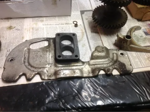

Remind me: Is this carb adapter / manifold insulator for the stock carb and manifold? I was under the impression it is.
I had a Weber 38 on my 40 when I got it.

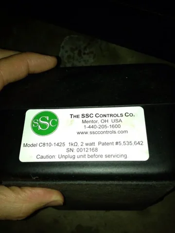

I don't think the XMT has 2T or 4T. I do have a nice new pedal - SCC Controls makes it. The XMT is just not great about lift arc and scratch starts and of course I suck with the pedal. It has those modes, but I would always ding the tungsten when doing it.
Pedal

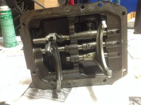

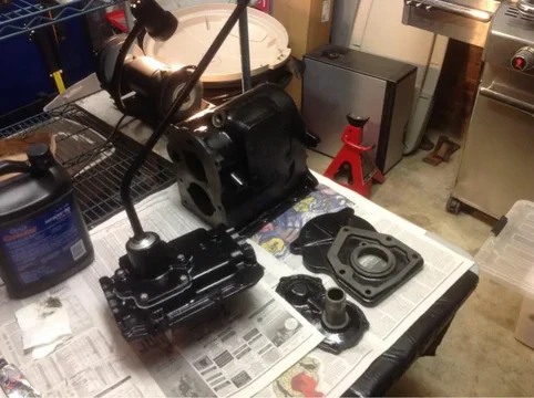

Worked on the Tranny tonight.
Got to this point:
Ready for gears and shafts next.

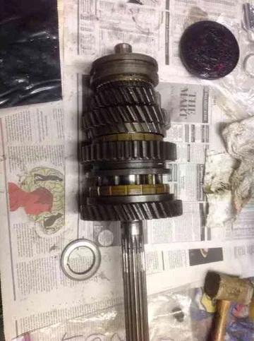

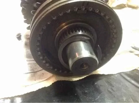

Working on the tranny again. Got here and stopped by a stupid snap ring. Had to get online and find a tool. Got a high quality Knipex 4510170 plier. The little pointed ones just don't cut it.
Got the main shaft done.

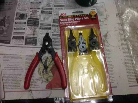

But can't get this on without a real snap ring plier.
These don't work
