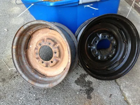

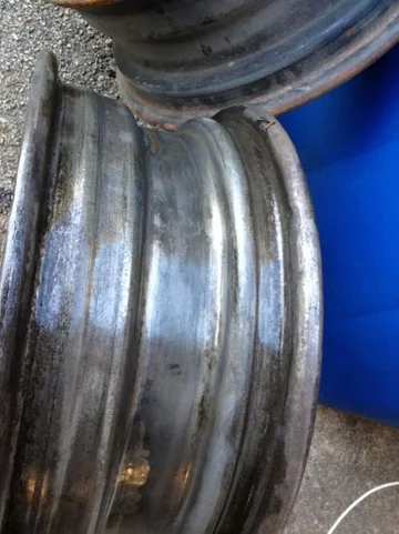

Yea - but lookie here at that rusty set of wheels you sold me: image-3275024730.webpimage-2809500459.webpimage-2640046247.webp
The one on the right spent the night in the tank. Clearly that is slowing me down.
