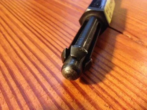

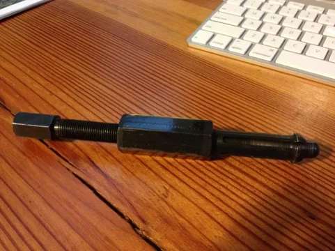

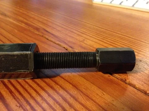

Just picked up this tool for $25. Wonder if it'll work to remove the pilot bearing without having to stuff bread in it?
Any bets?
End slips in hole, then the post is screwed in to both secure the end from coming out, and pushes on whatever the heck is behind the pilot bearing.
May have to grind down the ears a bit , but it should be able to work . One of the tool companies at one time made one like that in a kit with several sizes of heads that screwed onto the tip , wish I had bought that thing when I saw it then ....now can't find one .

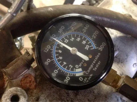

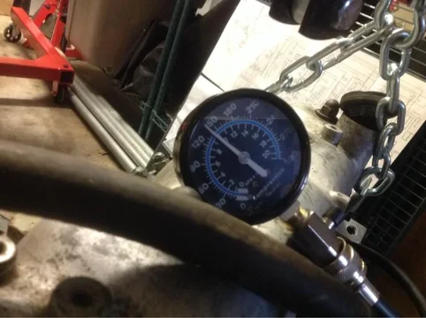

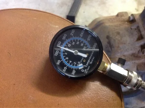

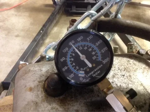

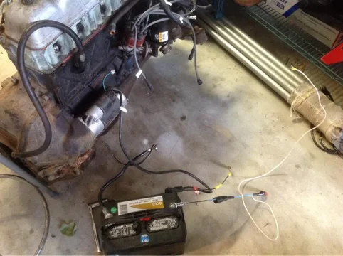

First task is to get the starter to turn the motor over to check compression.

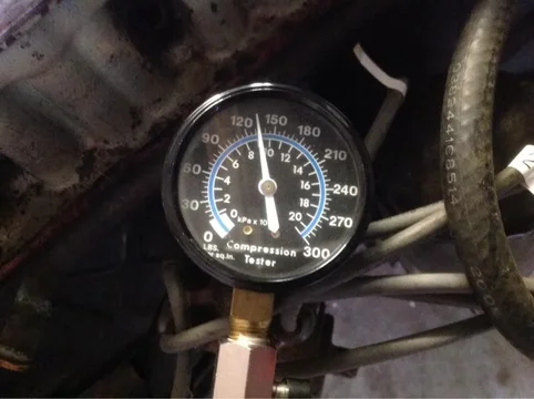

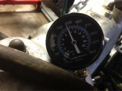

Ok, checked compression. Good news 150, 130, 150, 150, 145, 140. image-1828701080.webp Thanks Craig (vtgbeemer) for the setup instructions image-1496845511.webp 1 image-4245316949.webp 2 image-2387581453.webp 3 image-1962878724.webp 4 image-1508042042.webp 5 image-3617287169.webp 6
Once, the engine/starter/battery combo decided to just keep on keeping on. I had to shock it again to get it to quit. Pretty funny if it weren't about to wallow itself out of the garage.
Great numbers . Now you can set your plan on how to proceed.
Great news on the compression! I just ran mine and my #6 is down to 75 but others are 130 to 145. Before I bought my cruiser I remember reading on MUD about how someone should never buy a 40 unless they are ready to dump a ton of cash in it. Man, they were correct!!!
