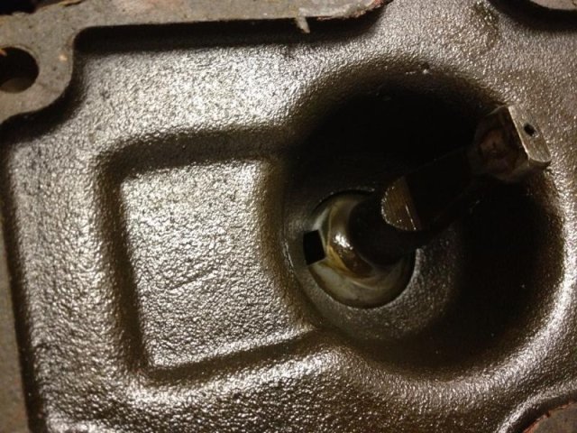

Step 3: Shift lever removal
I had trouble with this. I did not have or make a tool to do this task, so I tried a vice grip to push down on the shift lever and to turn it clockwise. Did not work. This may come back to bite me, but I just removed the whole unit as one by removing the cover plate.
