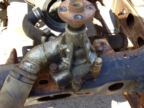

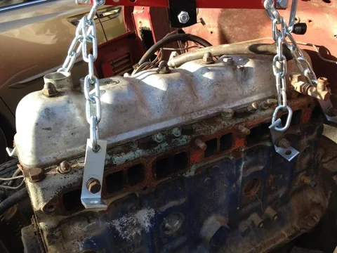

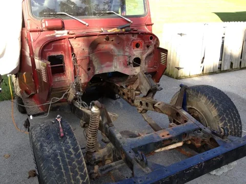

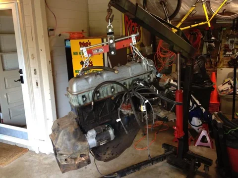

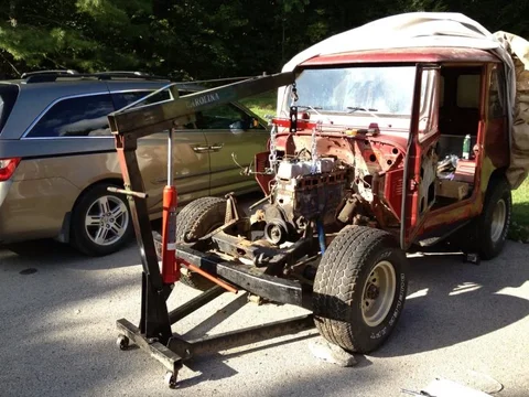

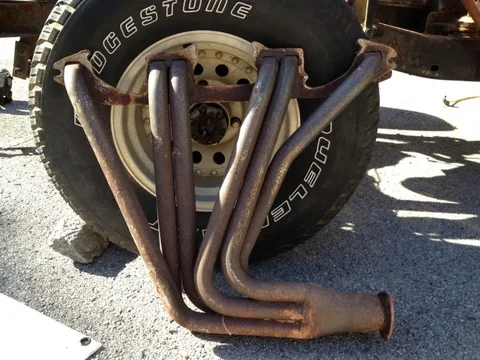

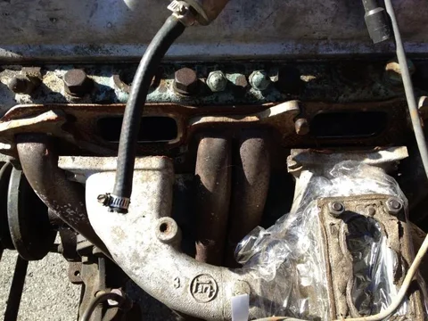

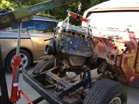

Progress: received the engine hooks donated to the cause by LandCrusher909 (thank you! I'll pay them forward). Once I got these, I said "Ok, time to pull the motor." I removed the alternator, the water pump, exhaust and intake, put the hooks on, took the hooks back off, connected the leveler directly to the engine block, and lifted it right out. The Carolina ShopHand 4000 worked great.
Water pump

Showing how I connected the leveler to the block
Ready to roll away
Looks like when a kid loses a tooth
Rolled it into the garage. Need to put it in the ground for safety.
After all that prep, it was easy.

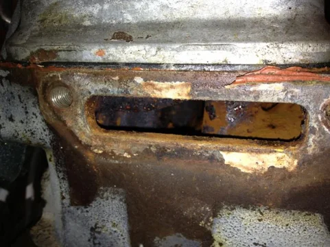

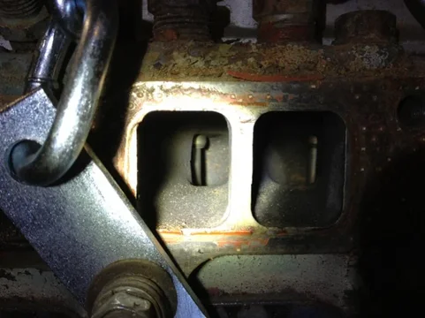

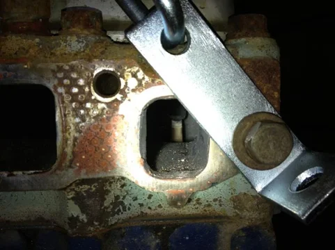

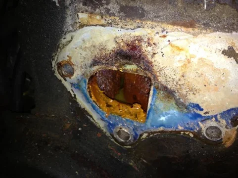

So what do I do with the engine now that it is out? It is very rusty inside. Can I flush it if I hook up the water pump and piping? Have CLR, will travel.
Rust
Exhaust
Intake
