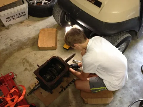

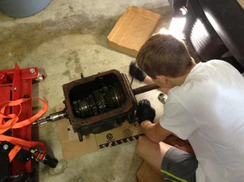

Started the tranny rebuild today. Got my son to help (actually he came to me for the first time and said, "Let's work on the truck, what can I do?")
Going to try to make a decent How To thread since I cannot find a complete one for an H42 version. Will need everyone's help to ensure it is correct since I have no idea what I'm doing :cheers:
Here is a link to the thread: https://forum.ih8mud.com/40-55-series-tech/758634-h42-transmission-rebuild-76-fj40.html
And photos of the boy at work. Wish I had learned what a tranny looked like at 13.

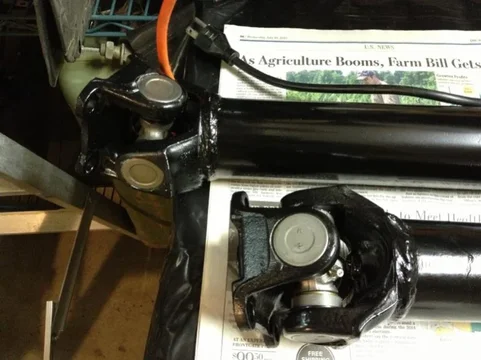

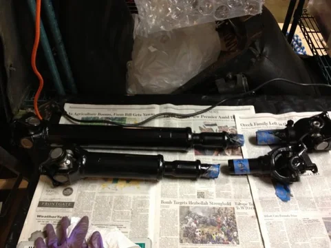

Finished the ujoints on my drive shafts except for the one needle bearing that I've got to find somehow. Got my second pair from Kurt and Bryce at CruiserCorp. Matsuba.
Ujoints

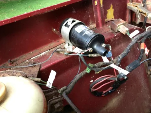

Started marking wires on my wiring harness with a label maker. Getting ready to pull things off to get the engine out, and for body and frame refurbish.
Labels

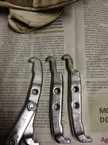

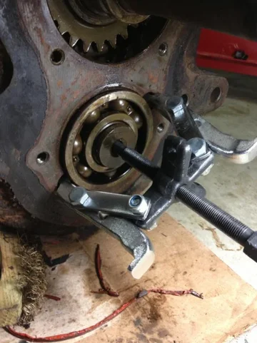

Then, had an idea to grind down the claws on a bearing puller to fit into the transmission case for the counter shaft bearings and darn if it didn't work! Pulled both PITA bearings right out. I won't be returning that puller to Autozone who loaned it to me though. Guess I bought it.
OEM Brand Puller model 27011
Ground 2 of the claws
Viola!
Pretty stoked about all that. Weather was so nice today I didn't break a sweat at 4pm. WTH?
That puller is a fantastic idea. Once my power steering debacle is over, the next thing on my list is the transmission/bellhousing/clutch/rear main seal. I also don't think I'm going to "outsource" this to a mechanic, as my friend has offered up his little brother and his garage :hillbilly:
I doubt I'm going to go as far as to replace the bearings in the transmission, but if I do - I am stealing this idea!

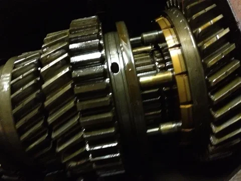

Back from my fishing trip, and back working on the tranny. It's good to be back - ha ha, not really.
Synchros and Gears and Bushings, oh my!

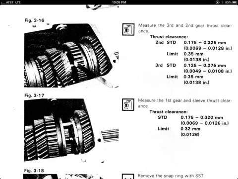

Does that FSM have a better description of where to place the gap tool between the synchros and gears? The FSM I have is a scan in a PDF that is kind of dark. See below for a screen clip of it.
The Haynes manual talks about doing the gap measurement AFTER you take the gears off the output shaft. FSM says do it before you remove the Output shaft from the case but just isn't clear where to measure.
If I could just see what to measure I could figure it out.

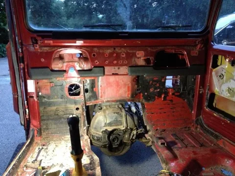

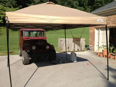

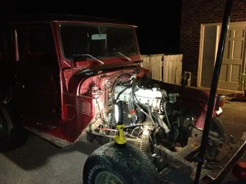

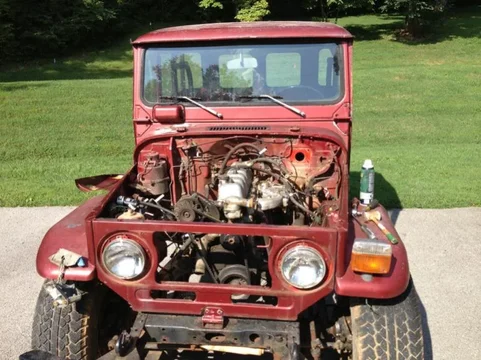

While I'm figuring out how I'm going to pull that bearing from the tranny, I decided to kick the body and frame blasting/painting into high gear. I want to get this thing into blasting by 10/1, which will be hard, since my time is constrained by family and work.

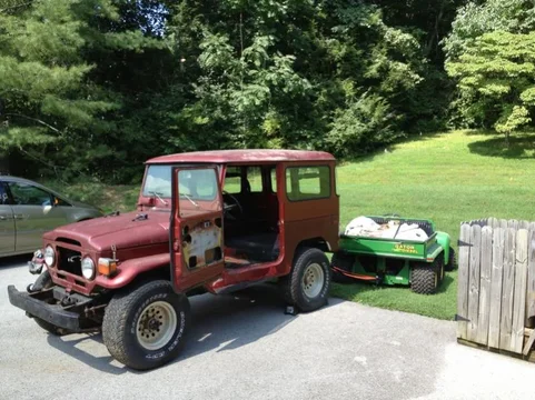

I moved the vehicle with the aid of the Gator by the garage so that when I pull the engine, it won't have to move far.
New Location
Got smart and put up the tent.

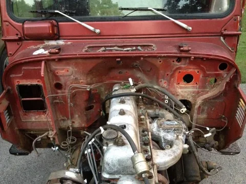

Then I started pulling body panels. Pretty easy. These things are such simple vehicles.
Hood First

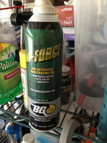

Screws came out fairly easily. Used some In-Force to get them started. This stuff seems to work very well.
In-Force

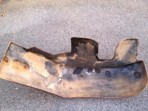

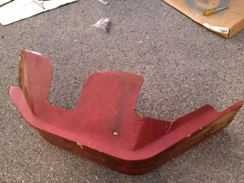

Hood, bib, left fender and that... other... panel (forget the name) is off.

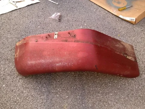

Fenders are fiberglass. They are for sale. In great shape (no rust - LOL). I'm hoping for some steel ones.

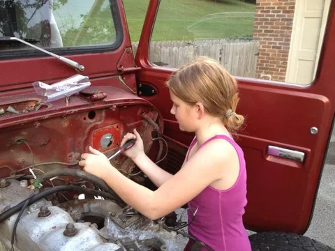

No work today but had my 9 YO daughter out again last night helping pull the fenders off. I know removing these large pieces will be a great memory for her.
She's learning the names of the tools, how the car is built, and begging to help me again! Great memories.
Got a couple of these I'm selling. In great shape. Fiberglass.
Looking like an old hot rod.

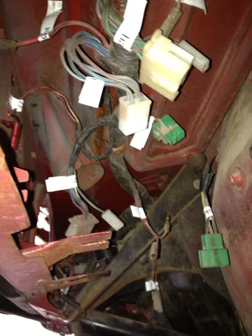

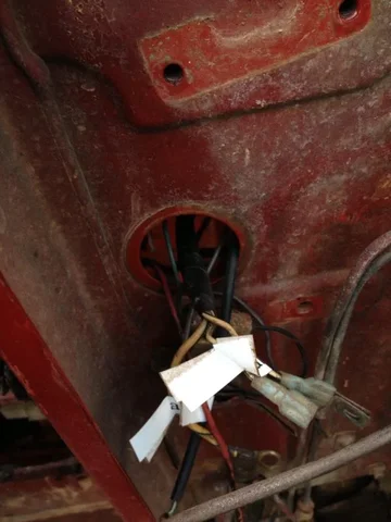

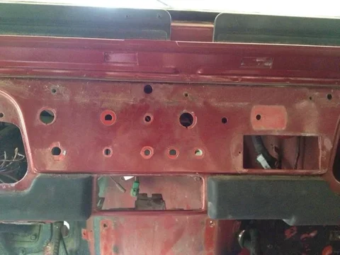

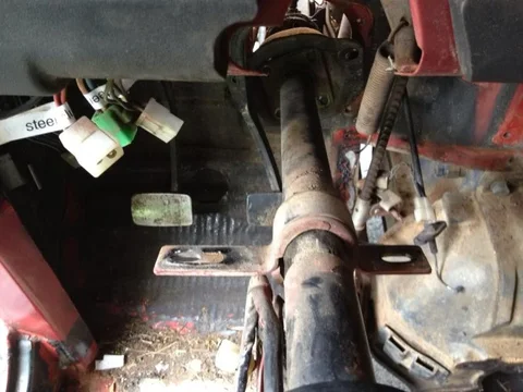

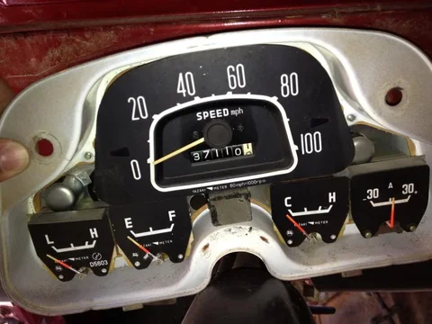

Still removing stuff on the inside to remove the body. Labeling the wiring harness as I go so I can remember how to undo what I did.
Labels
Instruments
Knobs
Steering Column

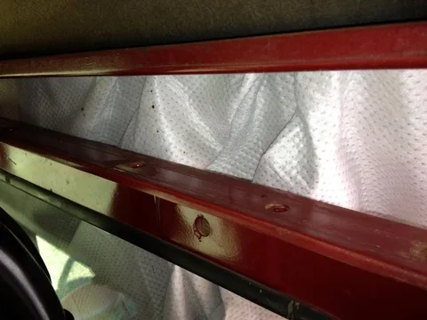

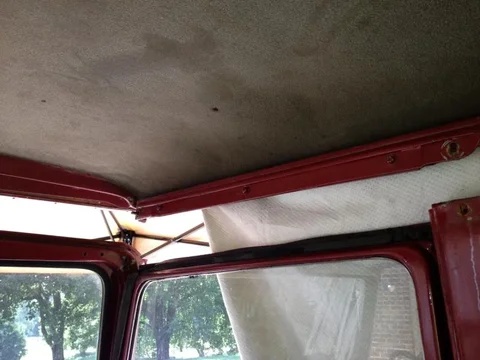

Top is loose
And rust free (x fingers)

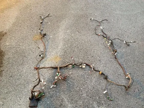

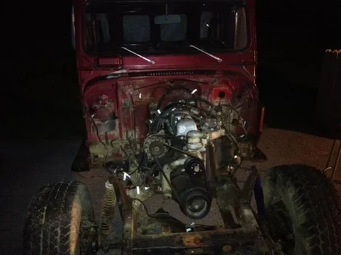

Got back to it today. Removed the front wiring harness. Gotta admit I was a little freaked out to do it, but it was a piece of cake. Everything was labeled, and already loose, so I just slid both sides out and it came right out of the dash.
Even got the munchkin to help remove the clips on the hard lines.
She's a cute one. She said "When I learn to drive, if it still runs, I claim it."
I need to get back to the tranny, and I need to pull the engine.
QUESTION: Should I pull the engine, then remove the flywheel, bell housing and such, or do all that first, and then pull just the engine? I guess I need to pull the alternator and the header and manifold before I can pull the engine, so that will be next.
Ah, frame off, here we come.
