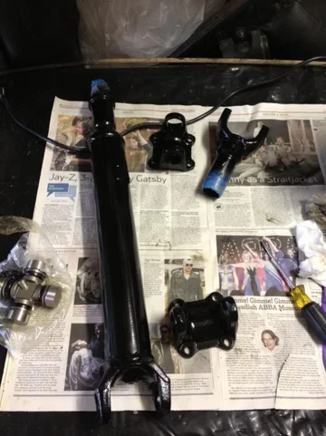

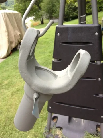

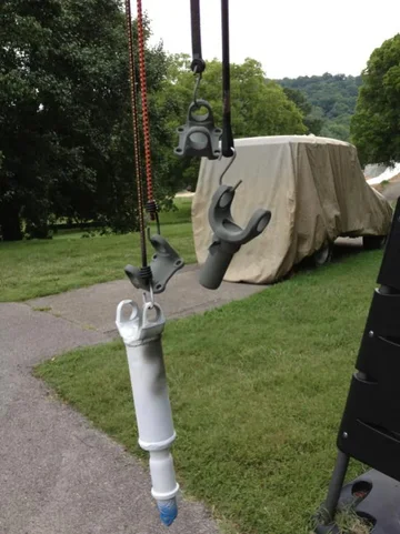

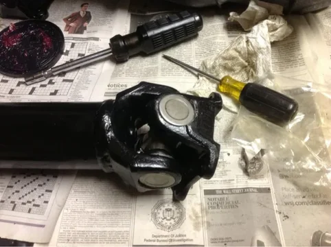

Trying to finish drive shaft rebuilds. Been out pounding the last ujoint out this pm. Have cleaned and primed the front shaft. Rear shaft is ready for re-assy.
One of the last 3 cups decided to be difficult and got a bearing between the body of the ujoint and the cup. It made it about 3mm longer and thus I couldn't get it out (I couldn't pound it out since it was cushioning the cup). Had to grind off the cup edge and finally slip it out of the joint. What a pain. (I know that makes no sense. Too hard to describe accurately. Trust me it was a pain.)
Used this as my how-to: http://www.pirate4x4.com/articles2/tech/ujoint_install
One step forward...
Got the rebuild done on the front drive shaft, but I'm short one needle bearing. Sigh. Old ones didn't match.
Oh well. I'll get a replacement from where I bought it.
Ready for the road
Rear shaft will be in the next week as I'm waiting on two more u joints.
