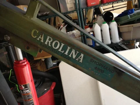

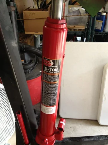

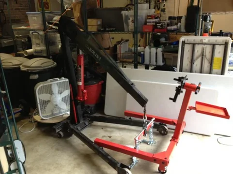

Sigh. Slow going. Gathering parts/equip to pull engine. Found a great old Carolina ShopHand 4000 engine hoist for $37 at a local auction. Had a blown cylinder, so got a new one for $70.

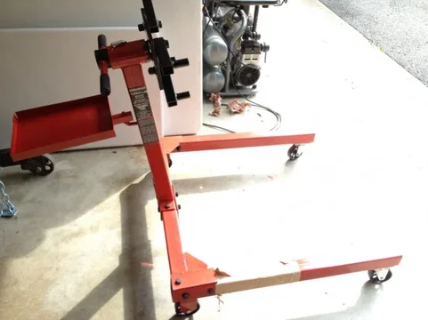

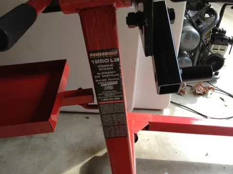

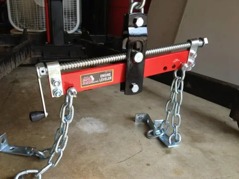

Now have a $100 US made hoist that'll last another 20 years. Bought a new 1250# engine stand (PowerBuilt) for $100 and an engine/load leveler (Torin) for $50?. Both were really good quality. I was pleased.

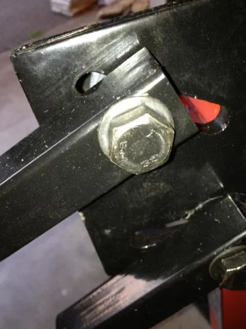

Also purchased 4 M12 x 1.75 x 160mm bolts for the engine stand to hold the engine from BallerBolts.com. Pretty cool hardware site. They are Allen caps.
http://www.ballerbolts.com/asc-12160.html
Fastenal and other sites were about the same cost, but shipping was cheaper and I liked the 10.9 strength of these. Just looked it up. 10.9 metric strength bolts in M12 have a Proof Load of 830MPa where 1MPa = 1N/mm^2 = 145 lb/in^2, so that's ummmm, 120,350 lb/in^2.
I think that'll hold it.

I'm thinking you may want to extend the legs on that engine stand. The 2f will extend well beyond those front wheels. I'm a scaredy cat when it comes to having that much cantilever. You're right about your fasteners. Those guys will never fail.

Hmmm. Yea, stand is not as beefy as the hoist. Not as pretty either. Although I'm sure it'll hold a 2F without the tranny and transfer on it, I plan to put them back on outside the vehicle. In that scenario, it will be 6' of engine hanging on 4 bolts - probably 2' past the end of the legs. Dang it Fish, now you got me thinkin'.
I guess I can keep the hoist on it or do as you suggest and extend the legs if it is rickety. We will see. The 2F is topping out at 800# loaded, as best as I can determine from reading here.

I think your stand will be fine for doing the engine work and once completed, it is easy to lift it from the stand with your hoist, lower it to rest on the floor or wooden blocks and then install the bellhousing, clutch, and trans. That is when your hoist and leveler will get a real workout. I don't see any occasion where the engine and trans would need to be on the stand.
So do the clutch on the stand but put tranny/tcase on the ground.
On an inline 6 like your 2F I always strip the rear of the engine to the bare block (no bellhousing or flywheel) and bolt the rear of the block to the engine stand. That allows you to work on the engine with full access to most everything. You may not achieve 360 degrees of rotation but you should be able to access things safely.
Once you have completed the engine you can remove it from the stand and secure it with your hoist to install components from the flywheel back.

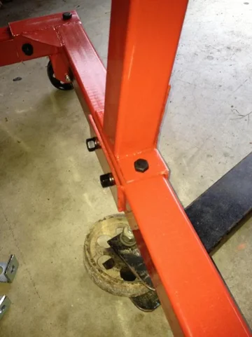

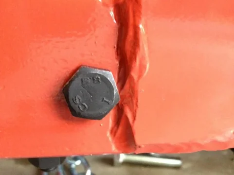

Be very careful with that type of engine stand , an inline 6 @800lbs can create some serious leverage against the main leg where it's bolted to the rear support member . Make sure those are good grade bolts and properly torqued , a lot of manufacturers use cheap hardware here - not a good idea .

Thanks Sarge. I'll go slow and be careful. Stand has hefty hardware. It is 8.8 stuff. The engine bolts i bought are 10.9.

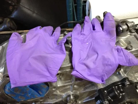

Found some great gloves I've got to tell about. Bought a box of expensive gloves ($16) from Home Depot a month or two ago. I was not impressed.
$16 for these, and not satisfied with the quality.
I own restaurants so I know that gloves can be bought much cheaper so I hated to get the $16 box. The ones we use in our restaurants are about $4/box, and vinyl, not nitrile, so I couldn't use them. Too loose.
The nitriles were nice, kept me clean and had good grip. The only problem was they broke really easily. 5 - 10 minutes and I'd have a hole somewhere.
When the black gloves started to run out, I went to the Internet and started looking, convinced I'd buy some for $8 box. Read about approximately 50 brands of nitrile and settled on the Kimberly Clarke. They were about $12/box, which I still thought was high. But on reading the reviews, people just bragged on the quality of these. (Amazon of course).
When I got these, I realized the reviews were right. These are far superior to the cheap but pricey Home Depot/Autozone ones. They are so thick that I've yet to break a pair, or even get a hole in them (not exaggerating). They are still very responsive (I can pick things up, feel what I'm doing, etc). I'm throwing them away only after they get so disgusting that I can't bear to clean them any more. I've only used two pairs in 2 days (couple of hours each day) but I'd normally go thru 5-6 pairs in that time. The 3rd pair is on the table waiting for me to put them back on. I bought 3 boxes of 100 pcs. Probably never use them all.
Used pair waiting on my return
Just thought I'd share.
Cracks me up - I used to work for a scientific company that distributed Kimberly Clark products. Those purple nitrile gloves are awesome. Superior to their blue nitrile ones. Having spent the majority of my working life in a lab, they have saved me from getting nasty carcinogenic chemicals, strong acids, etc. on myself quite a few times. Never thought I would see them put to automotive work!
That is great to know. I bought a box at Horrible Freight and go through them like condoms at a brothel; I so much as look at a sharp object and they rip.
