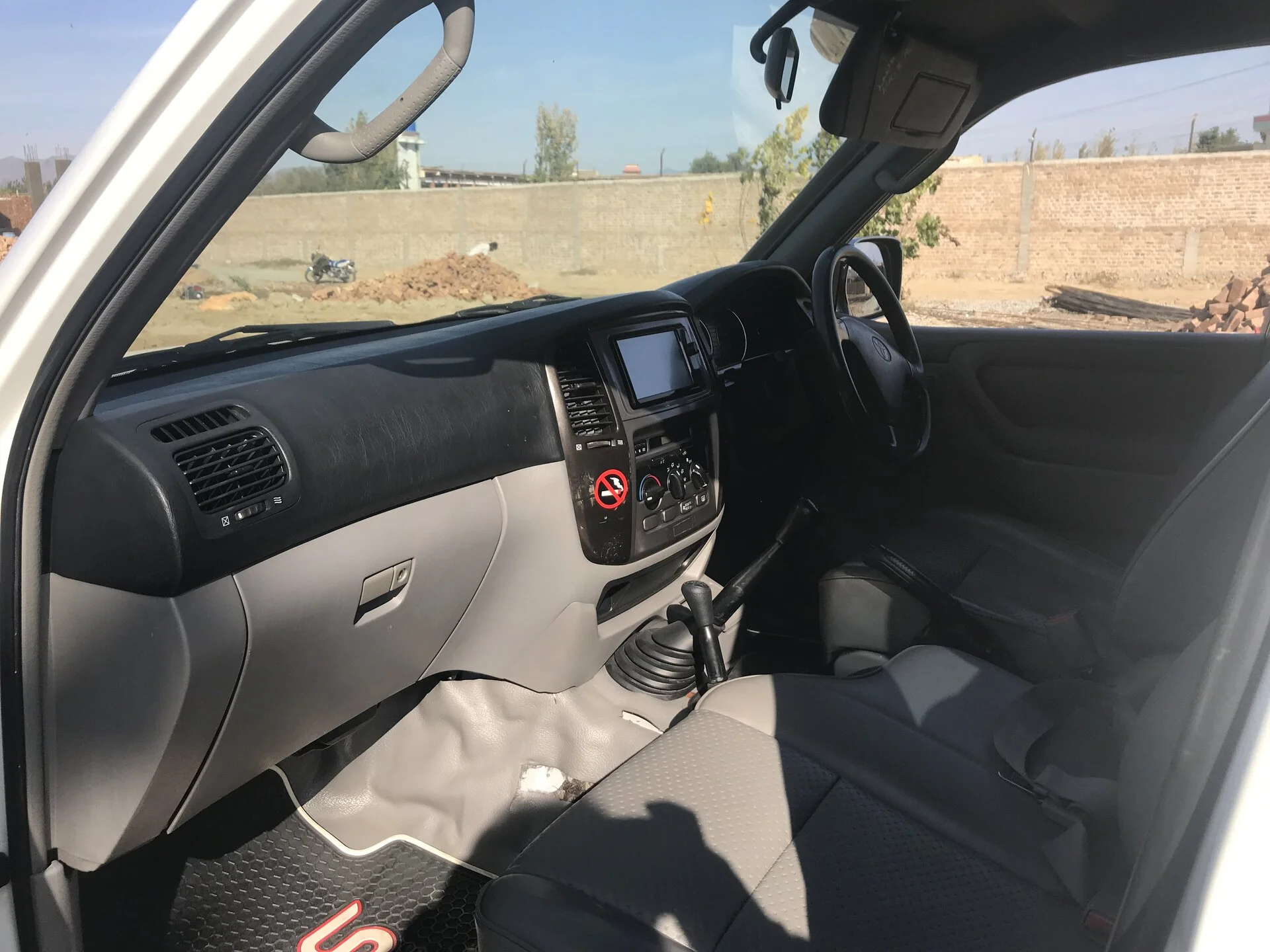

So R and H15x’s come in two flavors for 100/105. Separated seat (rear shift) and forward shift. The emergence for a R rear is different from H for rear. Thus changes in sheet metal. Thence changes in flooring.

Here is the picture from inside.
