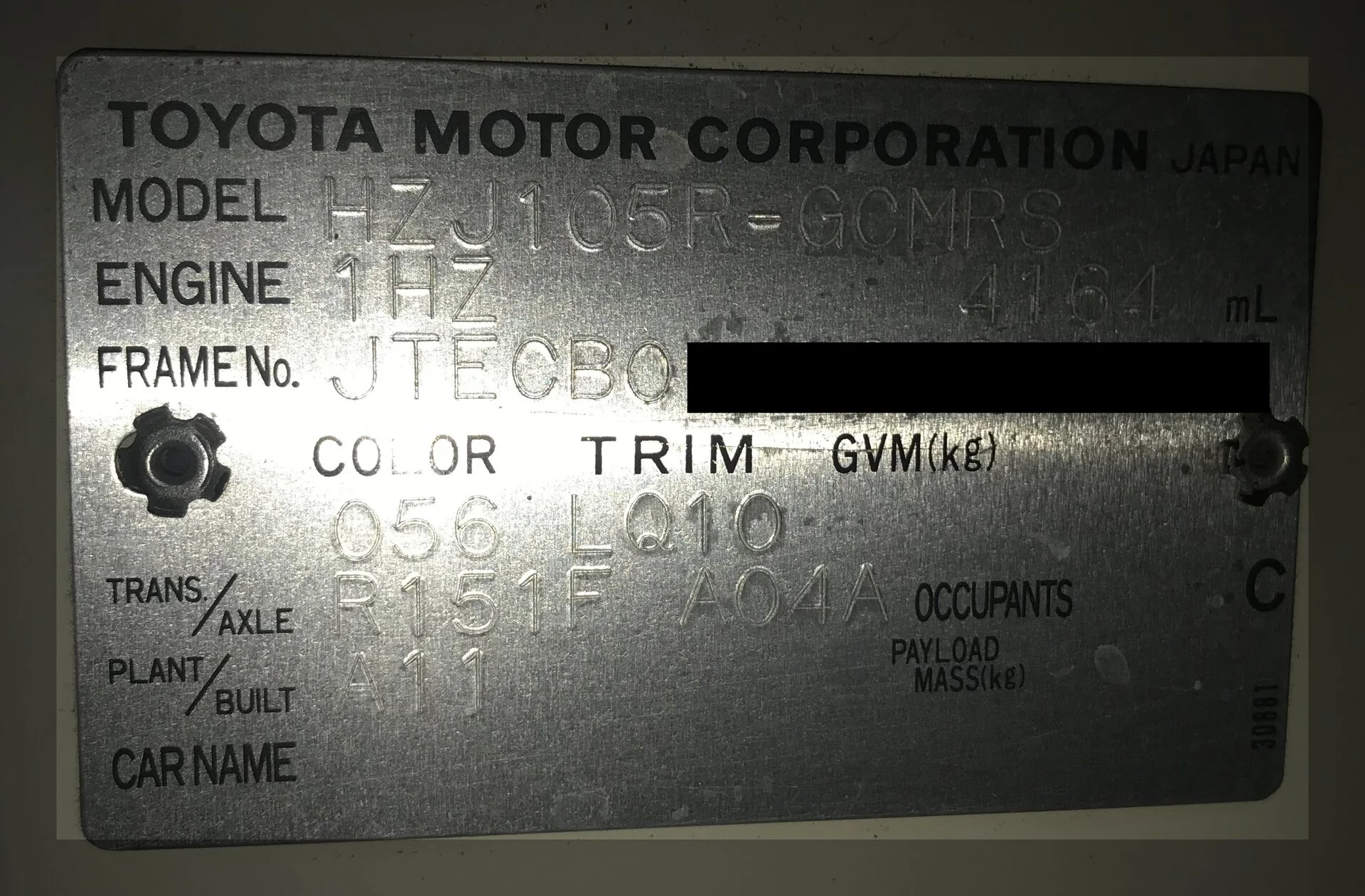

It seems you have an HZJ105...?
Yes, it's 2005 manual 105. It has R 151F Transmission. I think H series transmission is in 1hdt.
I found two engines in used car parts marketplace. 2UZ and 1HDFTE with wiring and ECU for 5 grand each, but If somehow I can fix this high rev problem, then I don't like burning money on replacing engine and transmission.
Is it swapped? I'd find it hard to believe there's an R series transmission mated to that thing.
