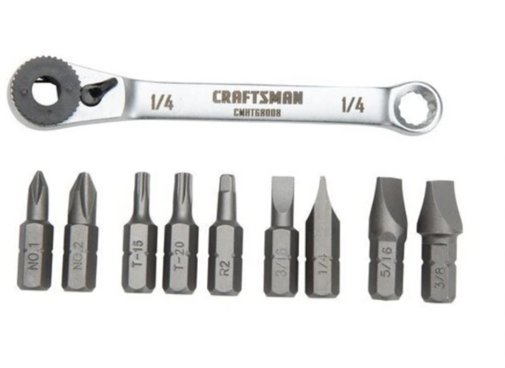

How on earth do i remove the TPS from the injection pump? I cannot remove the screw closest to the engine. Is there a special tool?

I used a small bit ratchet to get that one off. Enough space to push down on bit as you loosen. $15 or so for it.
