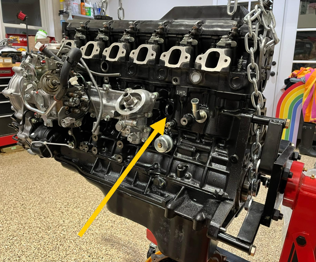

I read a post here that installed a block heater (Toyota Part C0140-00126-S2) into a 1HDT on the LH (pump side). They used the 2nd from rear freeze plug.

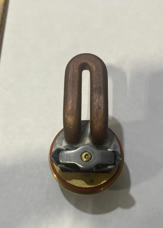

While my motor is out, I went to install the heater into the same location as depicted below. However, to my surprise the heating element would not fit. It would interfere with internal casting of the block. Behind the freeze plug there is a stiffener that the element is hitting. It will not fit in this location.
My only thought is that this is a new block, part number 11400-17073, and the one in above thread is a earlier year/casting.

Where I tried to install it:
