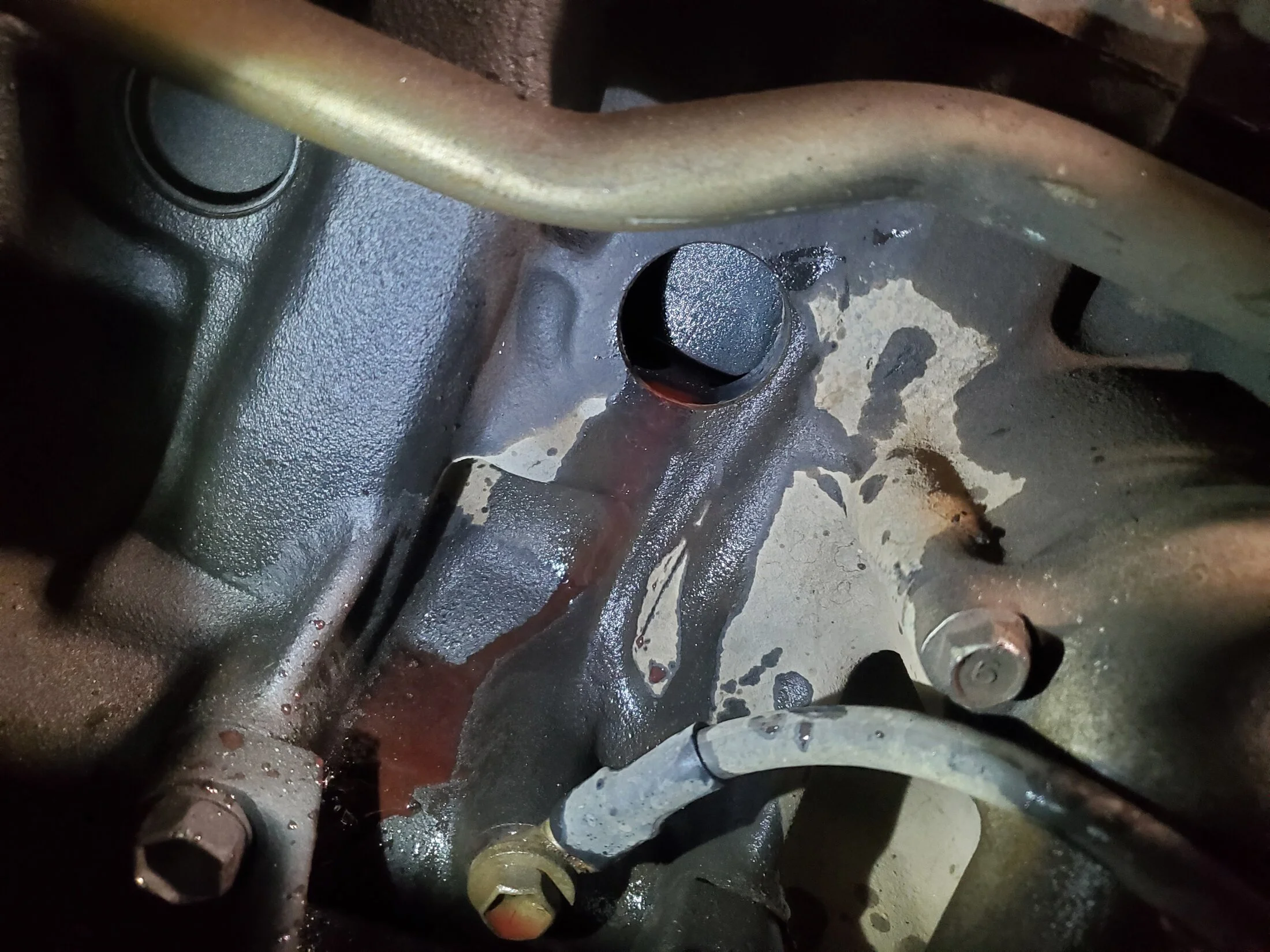

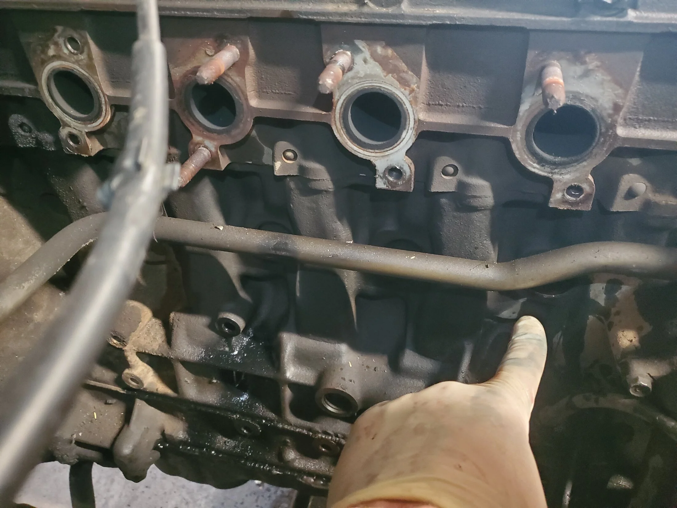

Right side has four 35mm freeze plugs. I pulled my turbo out of the way, and popped out the front freeze plug.
I discovered that the elemement of the heater protrudes too far for this spot. I measured approximately 23mm of space from plug lip to back of the coolant passage. The heater is 25.5mm from element to seating lip.
Does anyone have helpful suggestions/experience in this area. I am thinking of returning this heater and switching to a different 35mm heater with a recessed element. Zerostart #3100098.

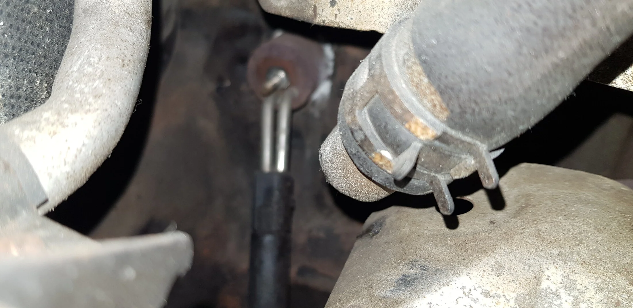

I have a Calix block heater on the exhaust side rear plug that was installed and used by the original owner. Don't have the connecting cable right now but do wanna install their inlet port cable somewhere in the engine bay one day for easy access. I do know it's a swedish quality product used by many truck manufacturers as a factory option for block heating.
Not sure which one is the right variant to fit the 1HD/HZ engine
Excuse the blurry picture
