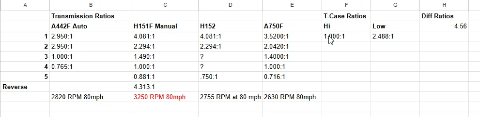

I threw this together a while back when kicking around some ideas:
Curious, what diff ratios are you running and tire size? What's your engine speed when clocking 80 mph down the highway?
I also wonder if 2630rpm in 5th @ 80 mph with the auto 5 speed is a bit overboard since the FTE should be into the torque by say, 2k rpm.
I'm on 4.10 gearing with just under 33s and running 75 mph at about 2900 rpm with an h151 and the FT. Although next month I'm going up to true 35s.

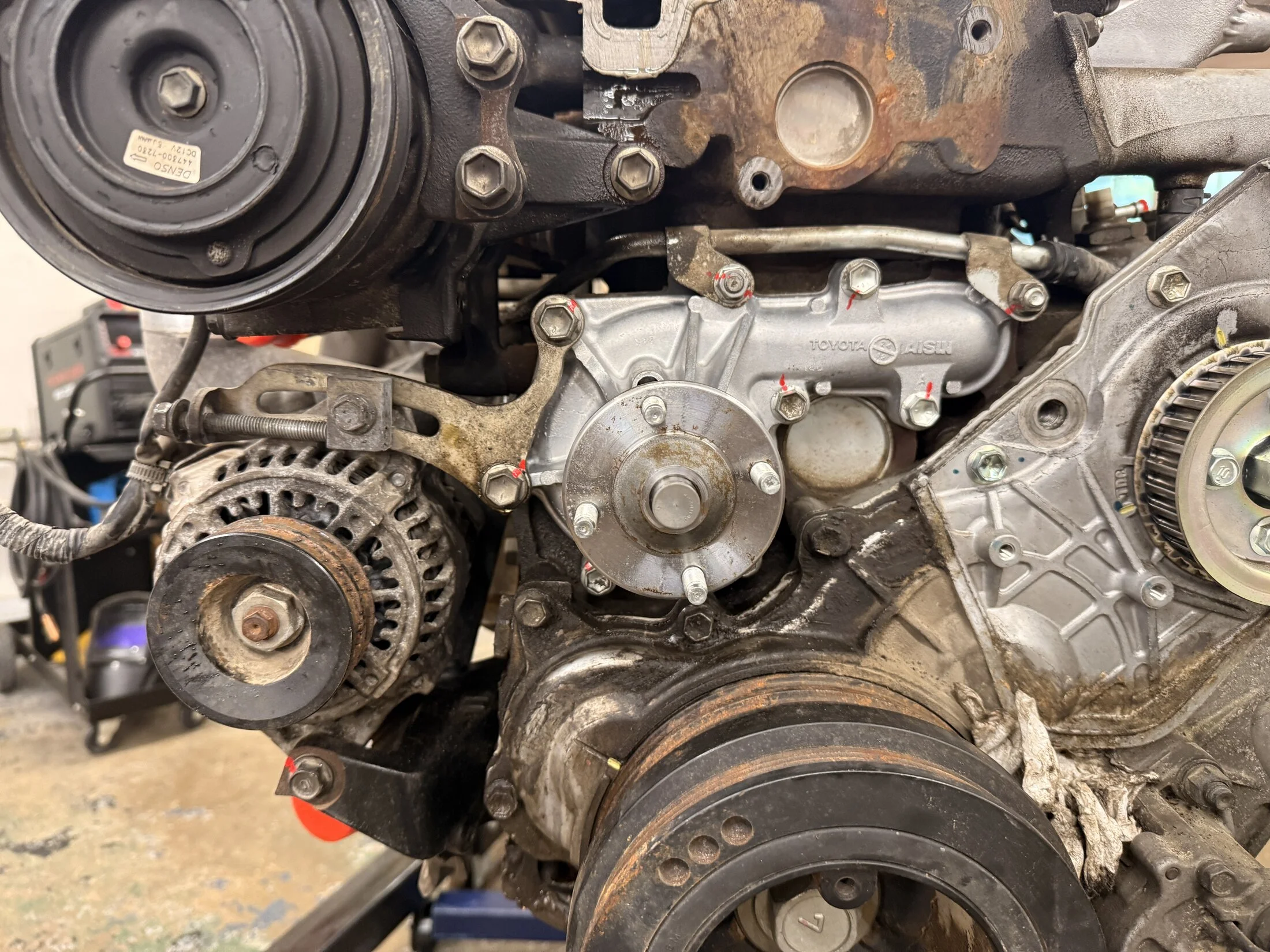

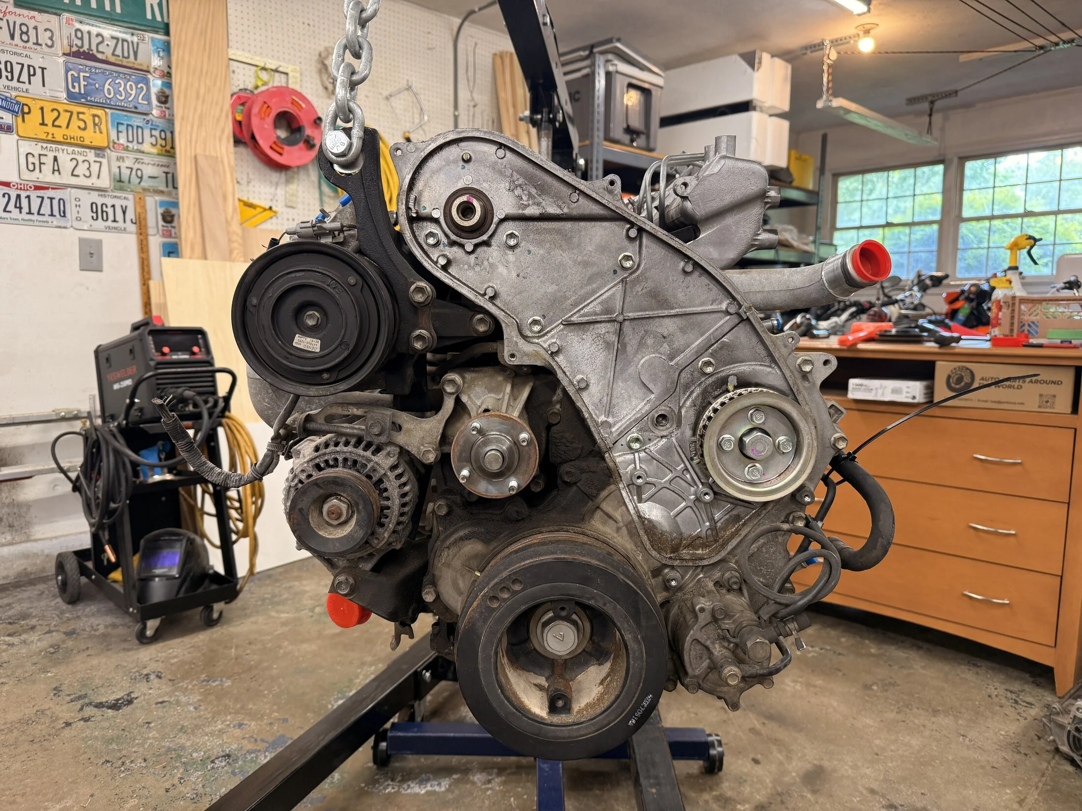

Small update here, did the timing belt, water pump, tensioner, cam pulley and t-stat last night. She should be ready to roll. :cool:
Oh and I carved out what seems like a pound of very fine dried silt from the back of the fan pulley and from the harmonic balancer.
Next will be oil pickup and pan. Working on sourcing those now. Sounds like Dave over at japan4x4 has a hookup (thanks for the recommendation @ikarus). Need to source an EGT sensor setup, was thinking something like this. Open to suggestions if there’s other options folks have liked.

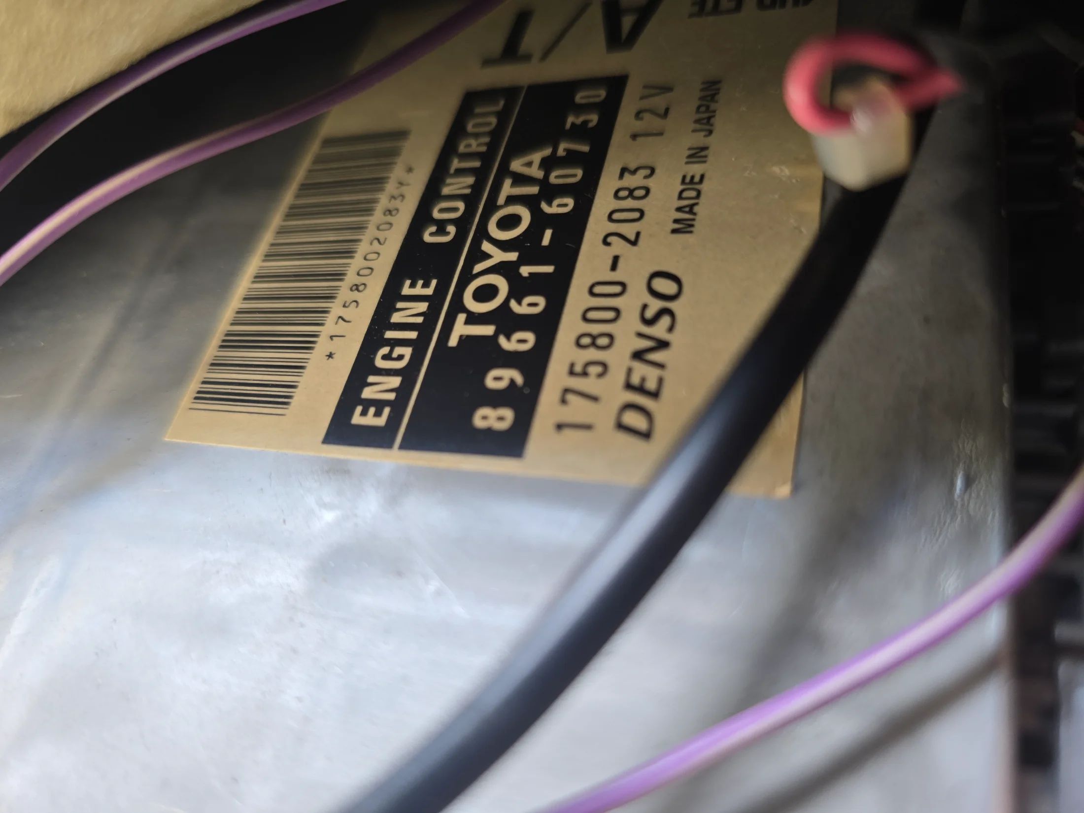

So here's where I need some information and help as well, I have an 1hdfte auto 4 speed ECU.
Im leaning towards the h152f, Ive asked Mick the guy making my harness if running the manual on the auto ecu is possible, he's said its perfect, and didn't really add anything else to that.
Anyone have experience running an auto ecu with a manual setup? Im assuming itll probably throw some kind of engine light since itll be looking for auto transmission inputs that arent there.
I know that this doesn't really help but I've done it on an MR2 and it was fine. I would think it would be fine on your project but just throw a bunch of fault codes.
