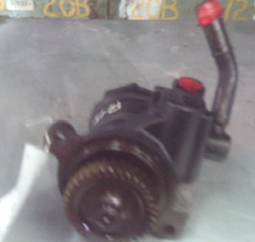

Ok, in regards to my last thread about the engine knock, I have concluded that it is not something internal. I unbolted the crank pulley and the noise stops. Even though there is some slight wobble in my crank pulley, I don't believe it could be making that much noise.
Also, I unbolted the PS pump from the two studs and pulled it off about ran the engine for about 5 seconds- noise still there.
So, my question is- are there any other gears that have to do with the driving of the power steering pump that do not come out when you pull the pump off the engine? Being that the PS pump doesn't run when the crank pulley isn't installed makes me think that this is could be the culprit.

That would be awesome... Like I said- I pulled the pump off the studs after I took off the 2 14mm nuts and ran the motor with the same noise. There may be more to the pump that I didn't take off...
Here is a picture of what I pulled off-
In between the PS pump and the crankshaft pulley/harmonic damper is just the oil pump... :eek:
