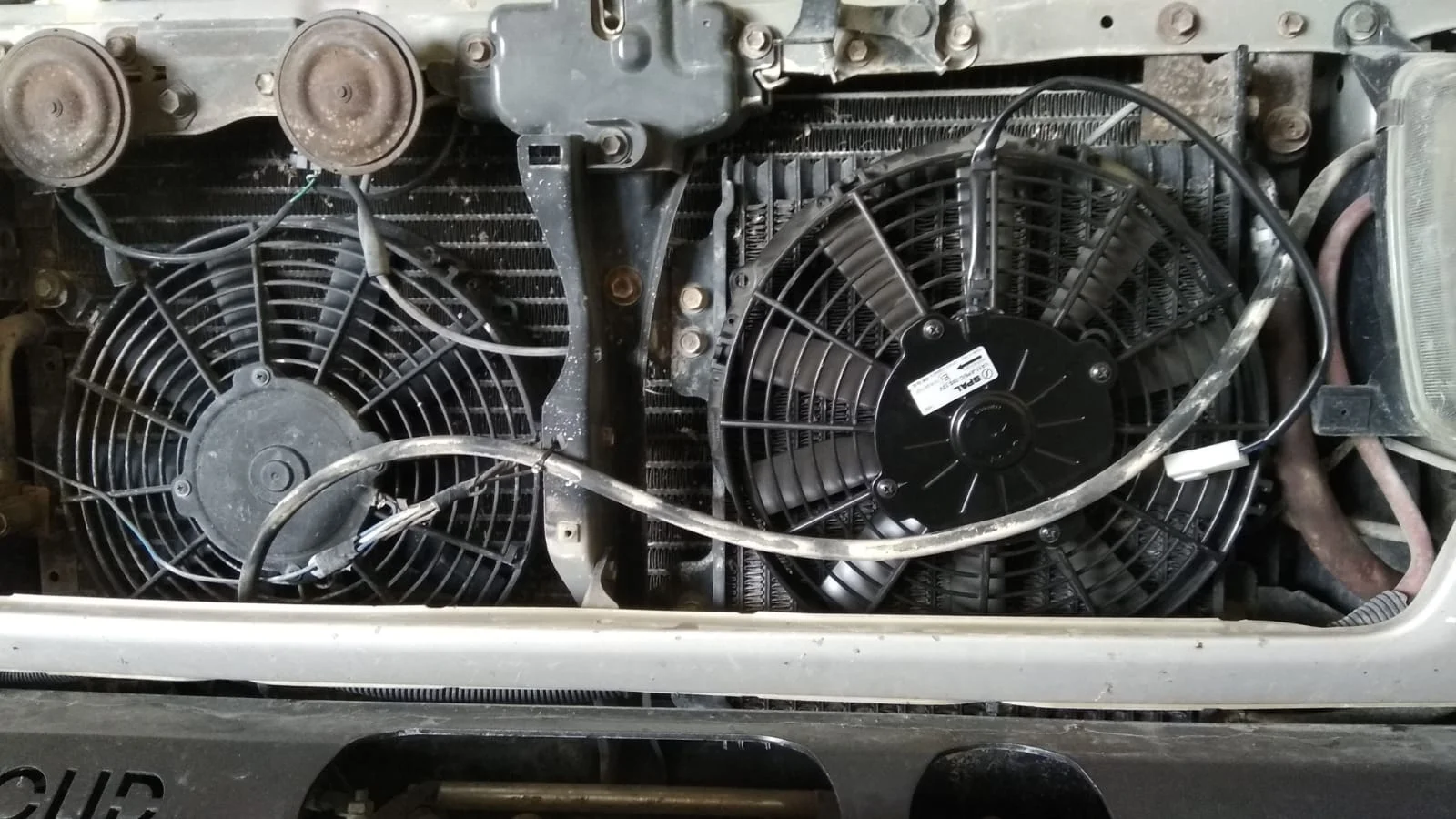

Yes, I totally agree with you guys @Marco Lau and @DAILY80 Full Alum rad is the best,
I couldn't justify putting a 2600$ rad (the price of an R D radiator, it will cost me to bring one to Israel)
Yes plastic rad tanks can have a catastrophic failure and I will be better with all Alum
But failures we see are from main two reasons bad installation or screws that got open or old age since plastic become brittle with time just like heater valve.
So here is the deal I change 10 TYC rads in the price of 1 R D all Alum rad

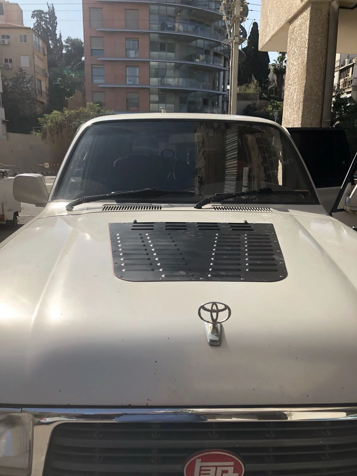

Plus, I have my one year CSF for back up. One of my friends will have to go into my back yard fight with my guard dog and bring it to me or my son will take my daily drive SUV and bring it to the nearest pavement.
My guard dog
