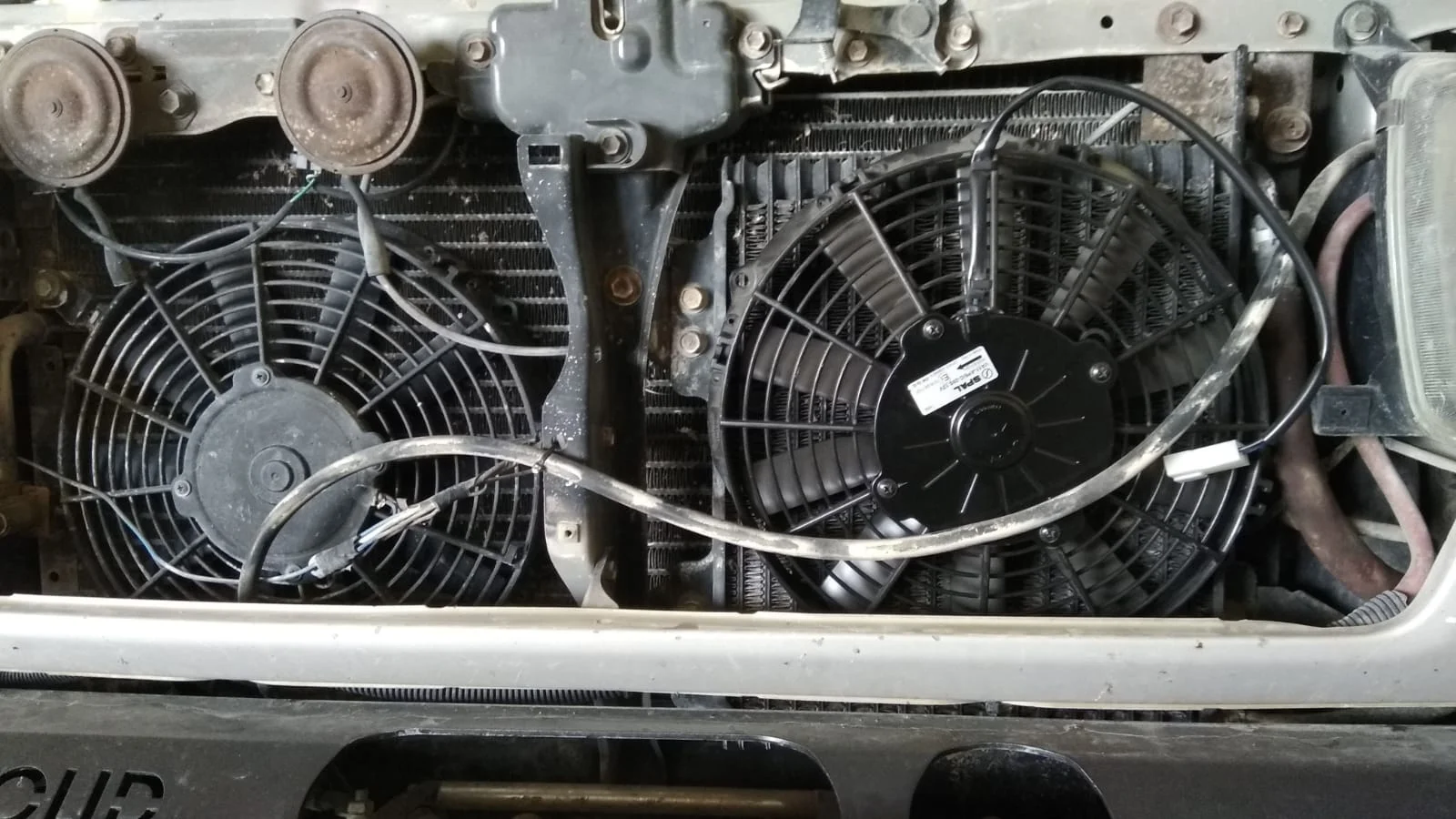

1FZ-FE The Big Overheating Experiment. TESTED SOLVED!!!
here are a few pictures of my Ron Davis when i un boxed it..

How does your aux fan come on? This is the one on the left of the above picture and directly in front of the a/c condenser. Does it come on when the a/c is turned on?
