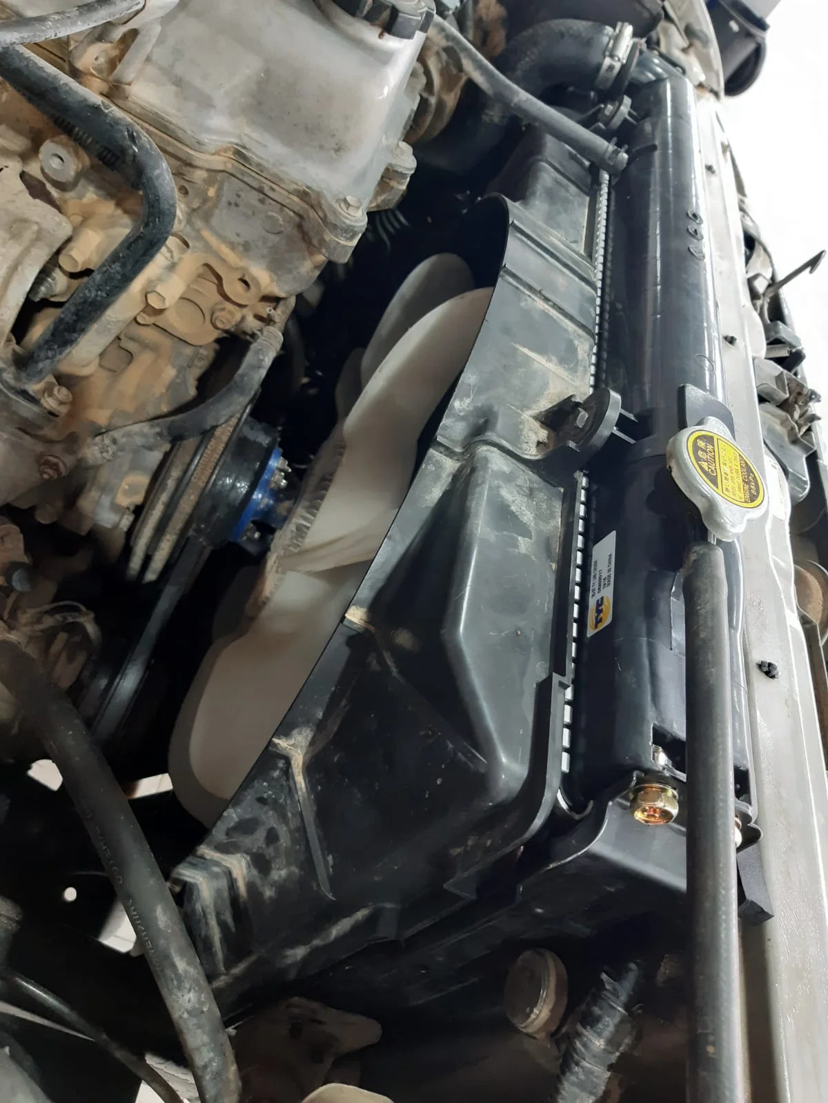

It was winter time and I didn't like the temperature I was reading on my OBD and the dry contact thermometer installed on the engine head.
When the hot season came it was impossible to drive with AC on, The AC will cut off and the temp would pick to 221 F on steep trails, on the road I got at 80mph 210

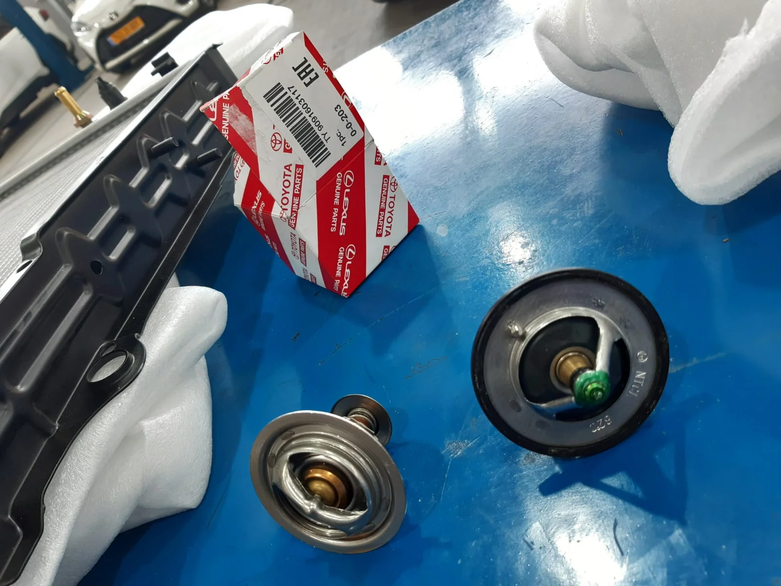

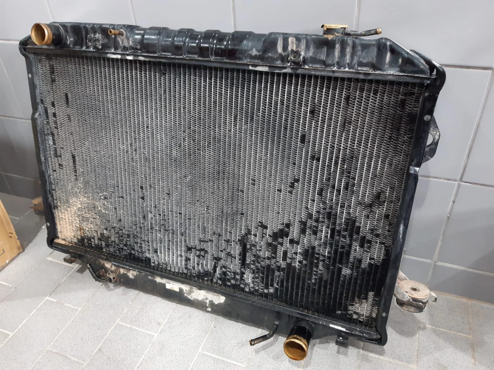

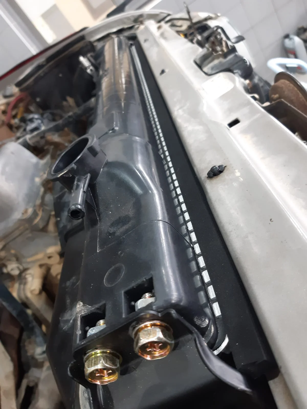

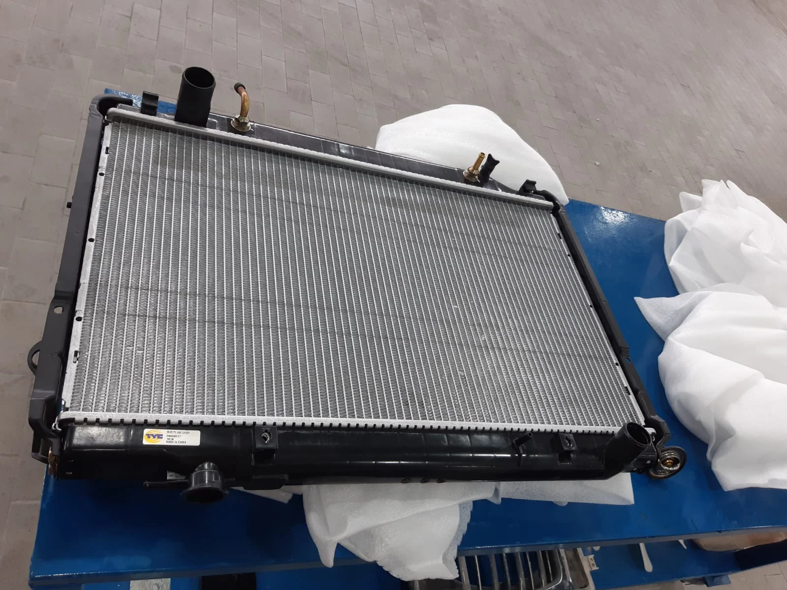

If you look at my build thread you will see that all the Heating/Cooling system was OEM and new, except for the parts like PHH bypass that i got from @NLXTACY, the thermostat was non OEM cooler 176 vs 180 OEM, and the new radiator I installed was CSF 2517 copper radiator.
Coolant is allwayes Toyota Red
I added hood louver and at September 2018 I did after consulting with @Tools R Us I finally did :
Blue Fen Clutch mode 30K 50ml 40 C
New Toyota OEM electrical AC electrical fan
Extra SPAL electrical fan manual controlled
It was winter and everything was honey and milk the temp was 180-190 with picks 194 this i liked very much.
The last two expeditions were in the extreme level in desert hot temp of 104 F i got on the highway up to 203F and in one case on the trail I got 217F for a minute or two. This I didn't like so much.
