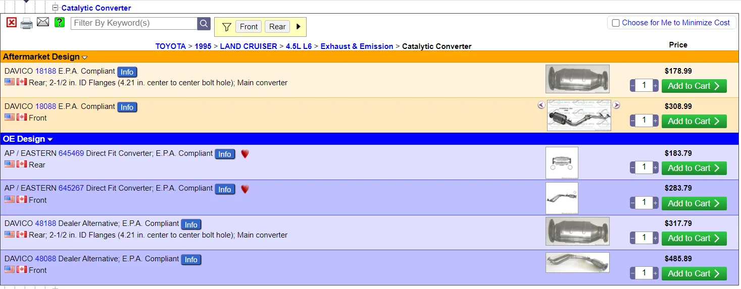

I need to replace the cats and forward on my exhaust. it's all leaky and the previous owner cobbled together a bunch of mismatched parts to make it work. Does anyone have good brands for the downpipe and cats? I found these on Rockauto but I'm not familiar with the brands. has anyone had any experience with them? Thanks for the info
OEM parts are still available if you can stomach the cost.
Oh that may be an option.
it seems like $500 for Davico / AP Eastern
$950 for Magnaflow
and I would guess $1400 for Toyota parts...

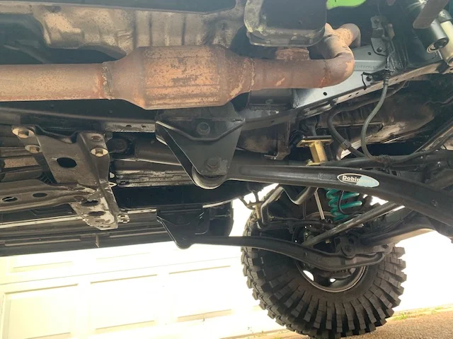

I got a new (front to back) Manta SS 2.5 from Australia. Working well (other than have leak from stretched manifold bolt that need to Helicoil). Added a single Magnaflow cat ; seems ok. Did have to get bung for O2 sensors

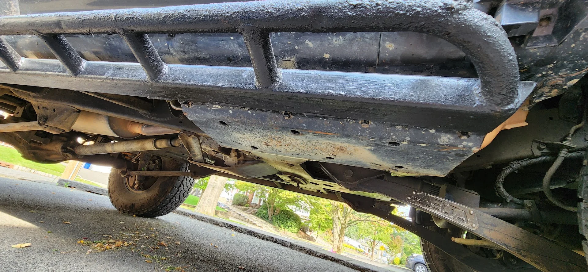

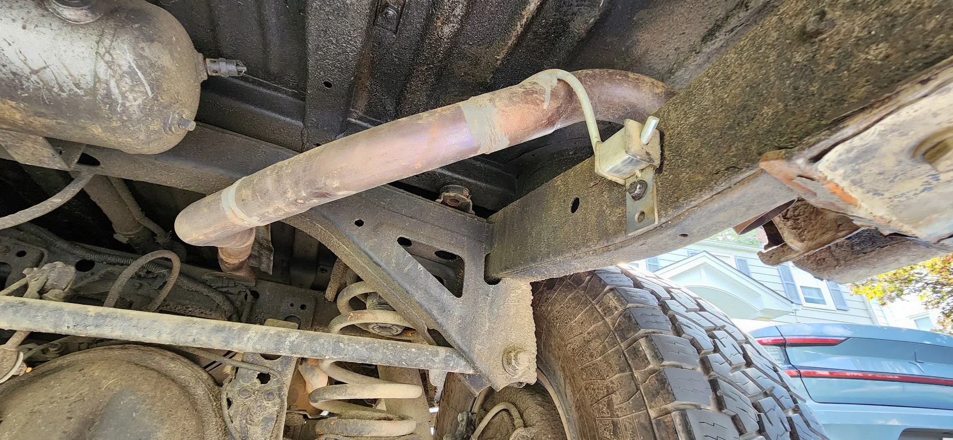

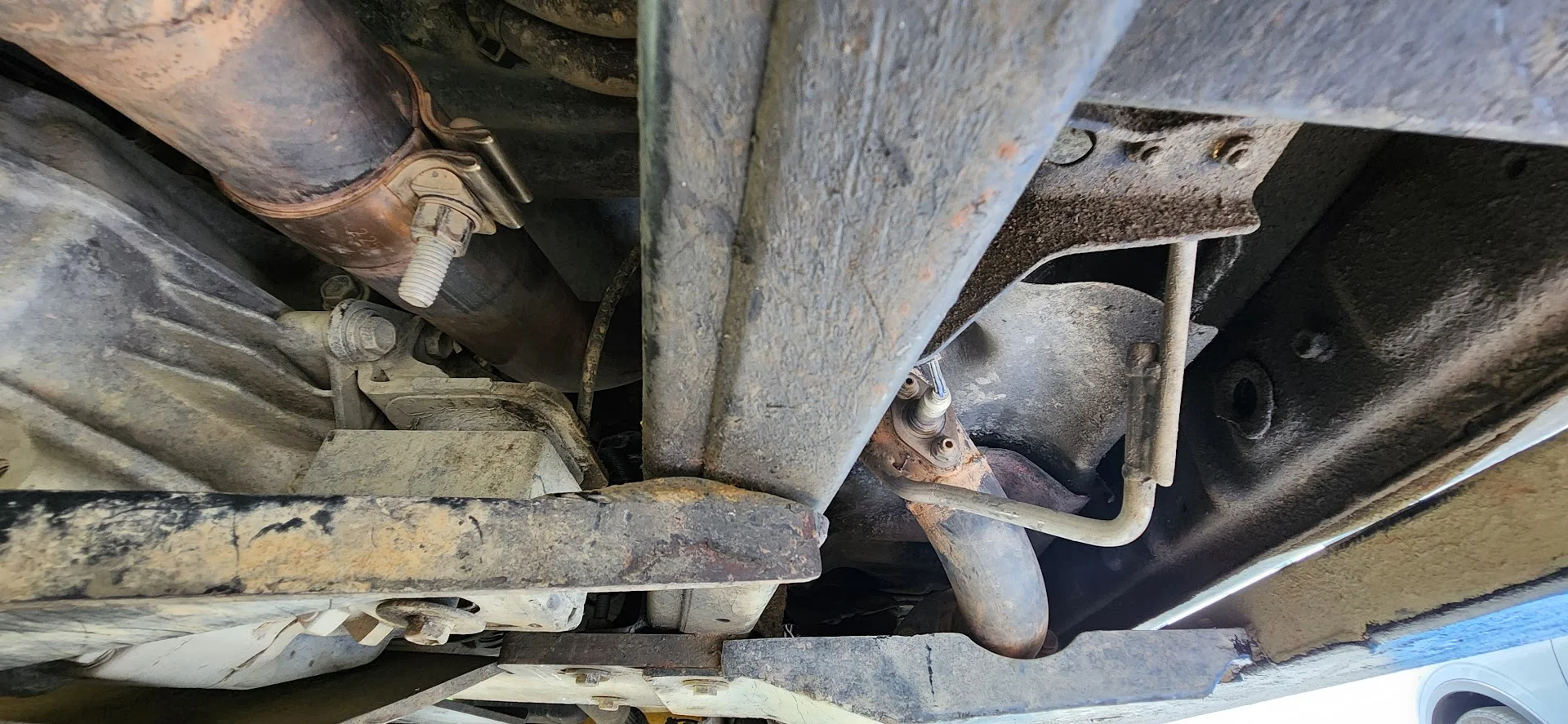

Difficult to get decent pics without putting her on a lift and removing skids. Basically out of the Magnaflow cat, up and over the frame to the muffler.
Out of the muffler, following the OEM path, over the right rear frame rail and exit just shy of the bottom of the frame.
Cat skid plate.
