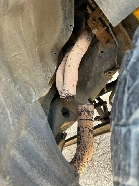

I just picked up a 97’ LX450 and it desperately needs a new exhaust system. What options are out there ? Any advice? I did a search but it doesn’t seem there’s really anything available. TIA

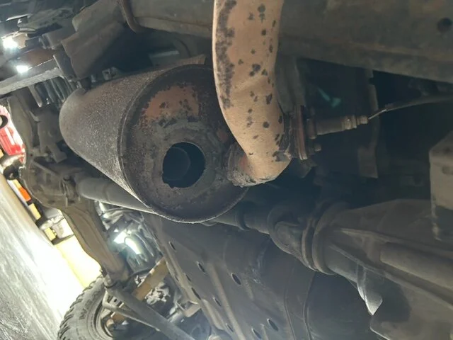

Haven’t done the back yet, but would consider this vs custom…

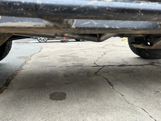

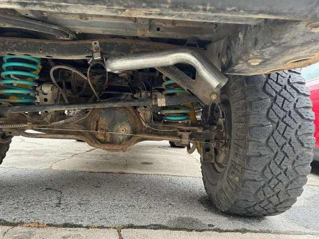

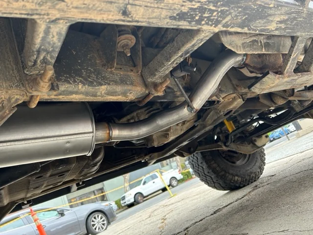

Just picked up my rig with new custom exhaust. my white knuckle slider mounts right in the spot where we would have been able to go over the frame. oh well. hopefully I don't bash that muffler on a rock, time will tell. but damn it sounds good. $780 and I had to supply the magnaflow downpipe + 1st cat; 2nd cat was reused from the old system. all my exhaust hanger mounts were toast and they had to cut out and weld on the 2nd 02 bung on the exhaust. Price included the new muffler too. pretty happy with it. :)
