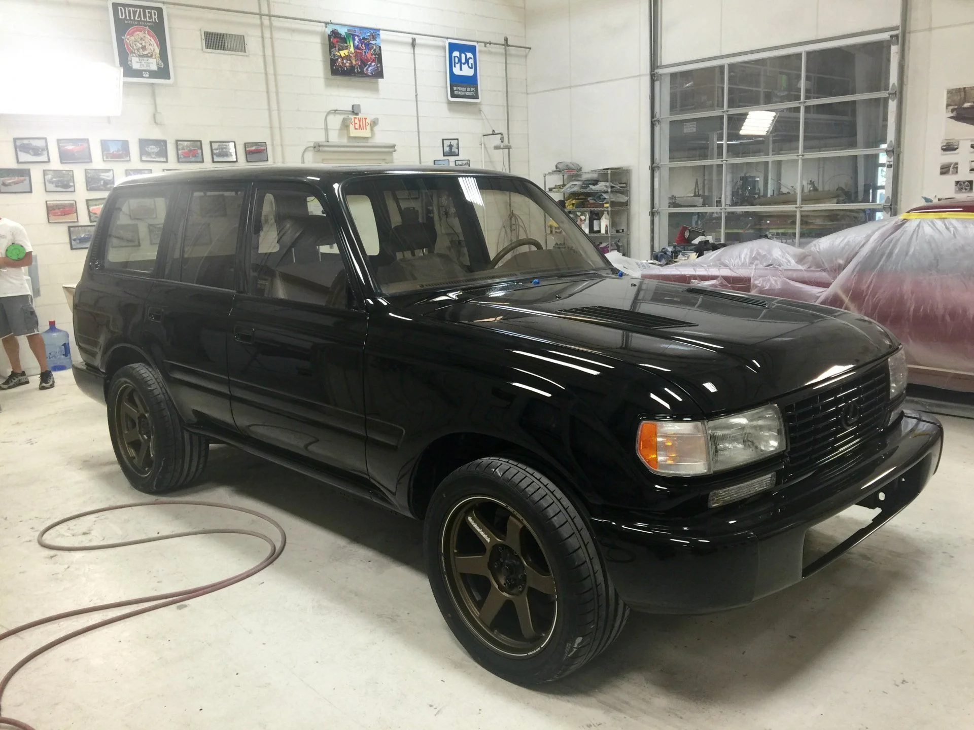

My engine is on hold for a bit. My $6,000-7,000 paint job ended up costing me close to $13,000. So the funds for the build are MIA right now. Lol. Should have known better when I took it into the shop and they told me most of their customers are millionaires. Ugh. I did have a few custom touches done. The front bumper has been cut and rolled for an intercooler, the hood had vents installed, the sunroof was patched closed, and a little trick one was the metal kick out on the bottom of the body below the doors that's a custom piece. But I wouldn't spend that kind of money again. The shop just put multiple guys on the job full time and ran the bill up before I had a chance to stop them. Lol.
Well you do get what you pay for and it looks absolutely great!
