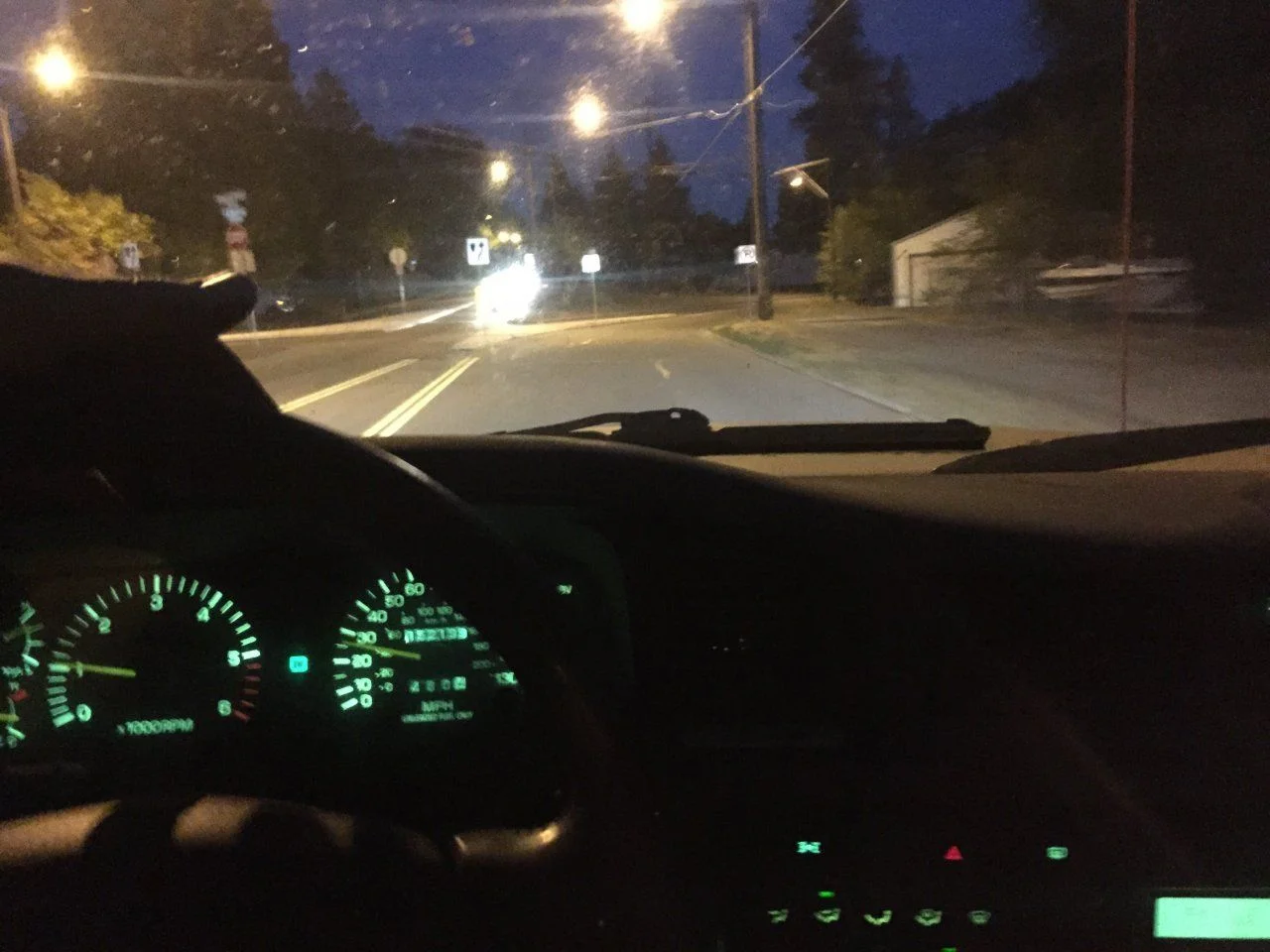

I got the tail lights bolted in and the wires wrapped this evening.
Then, I threw on what's probably the best engineered part in the cab at this point:
Finally, the important part:
She's a driver.
