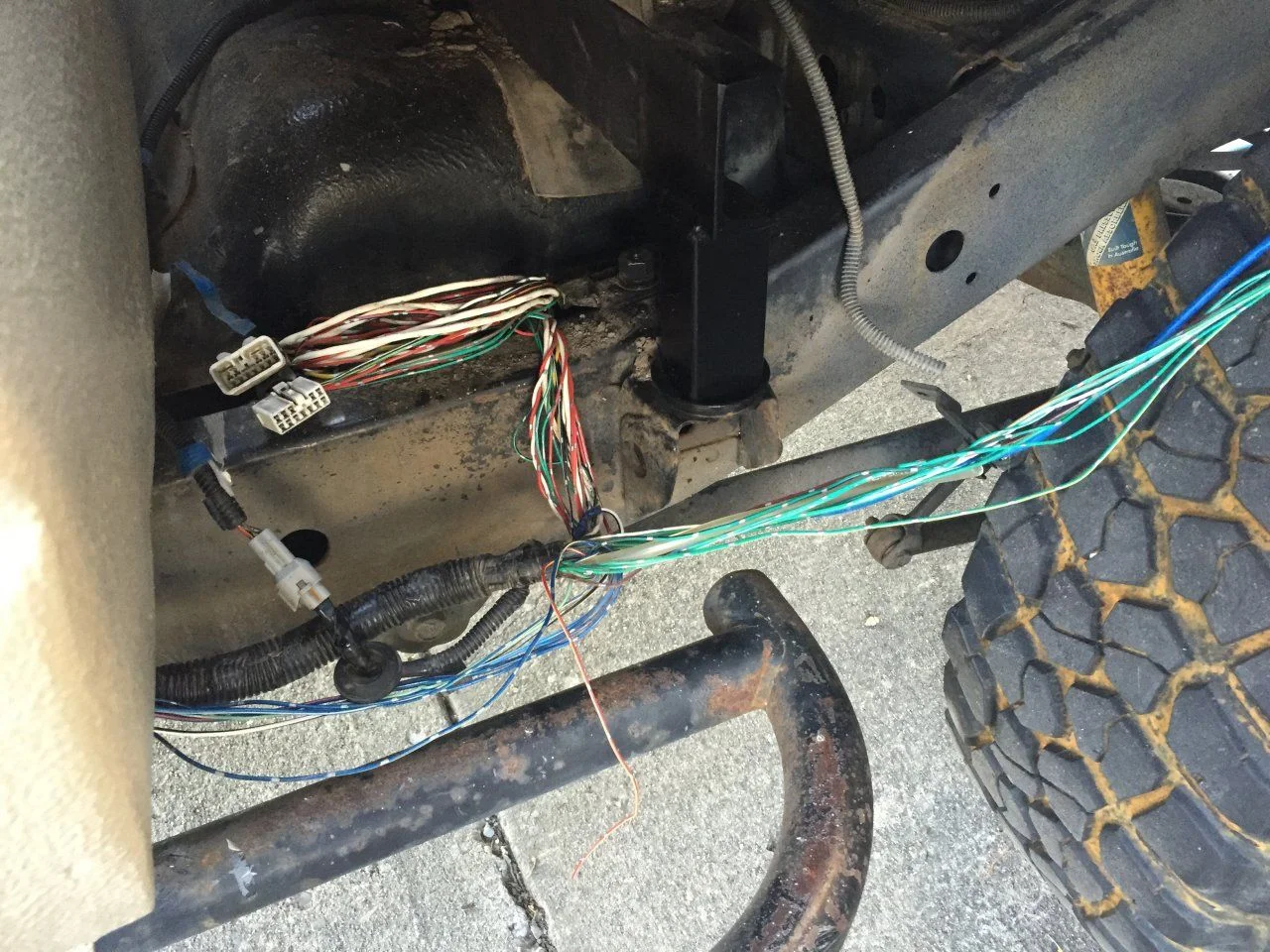

Some wiring tom foolery... I can't stand electrical stuff but I wanted the third brake light and the rear wiper to work. So, apart the harness came.
The bundle of red and white wires is all unused. Speakers, lights, etc. Once things are settled down I may find a use for some of the powered wires back in the bed.

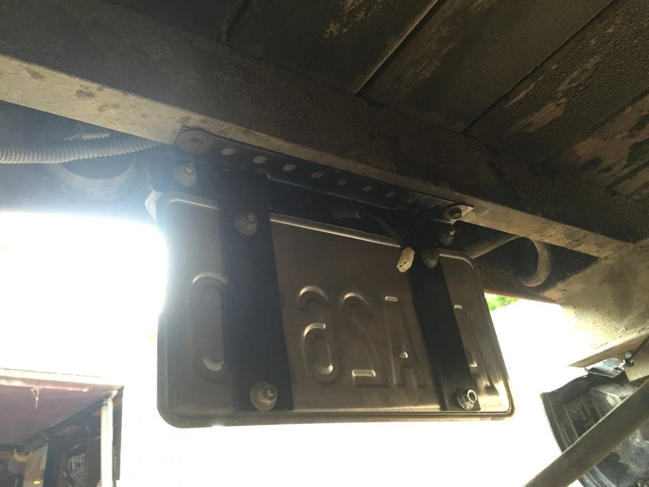

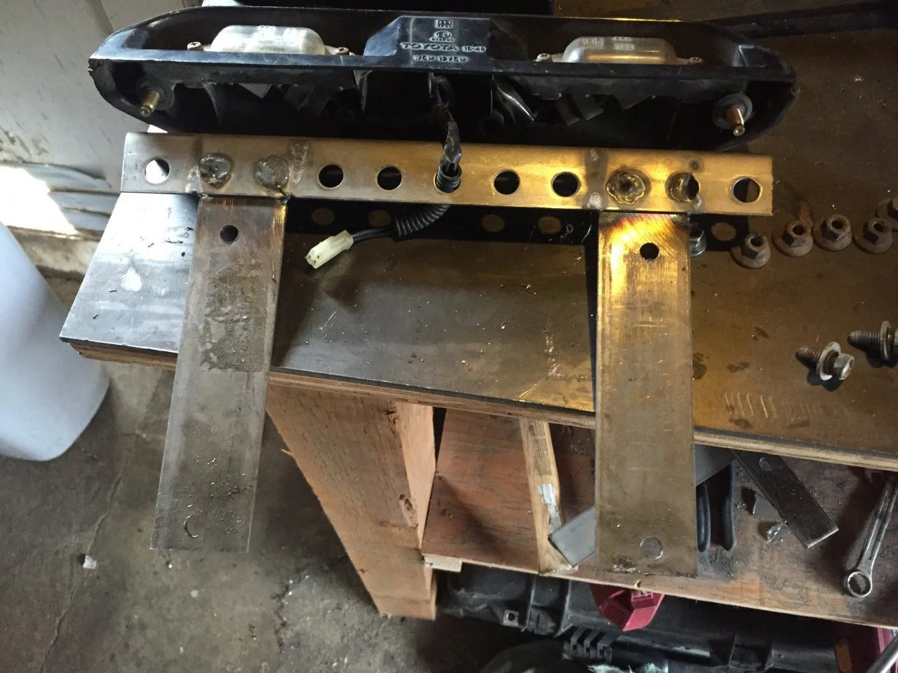

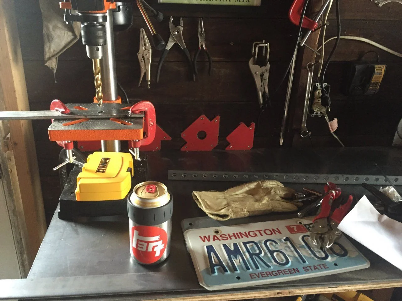

Some more yohavos fab... welded up a little license plate bracket that incorporates the OEM license plate light:
My bucket of OEM bolts from every land cruiser I've ever owned supplied all the mounting hardware.

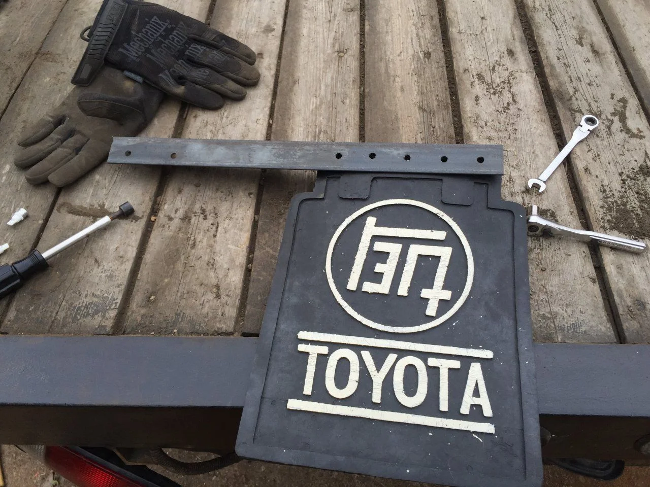

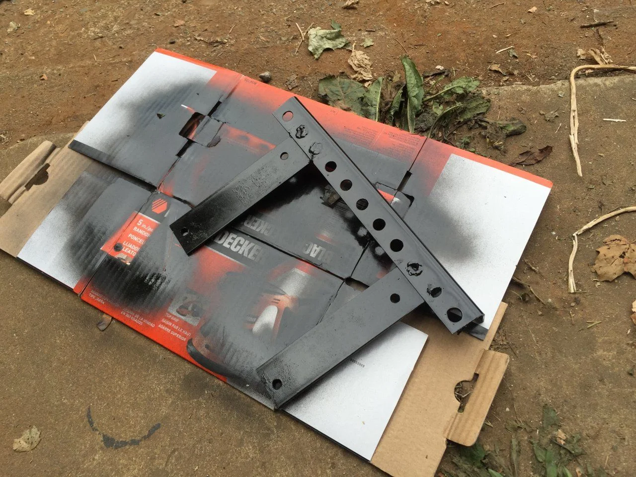

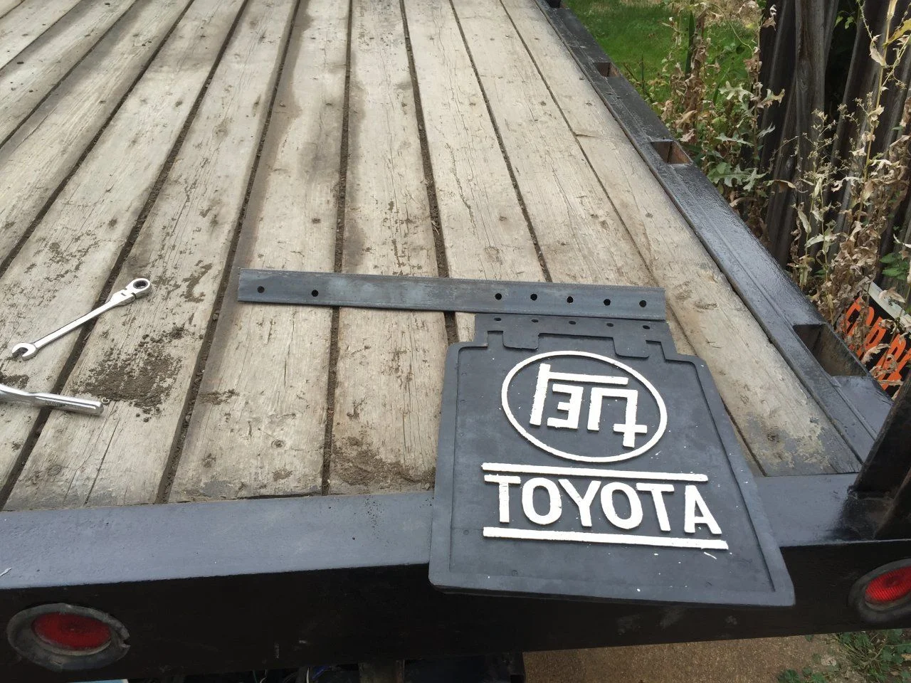

Then, on to some removable mud flaps... these will either be bolted or held on with tensioned hitch pins.
Loving my drill press!

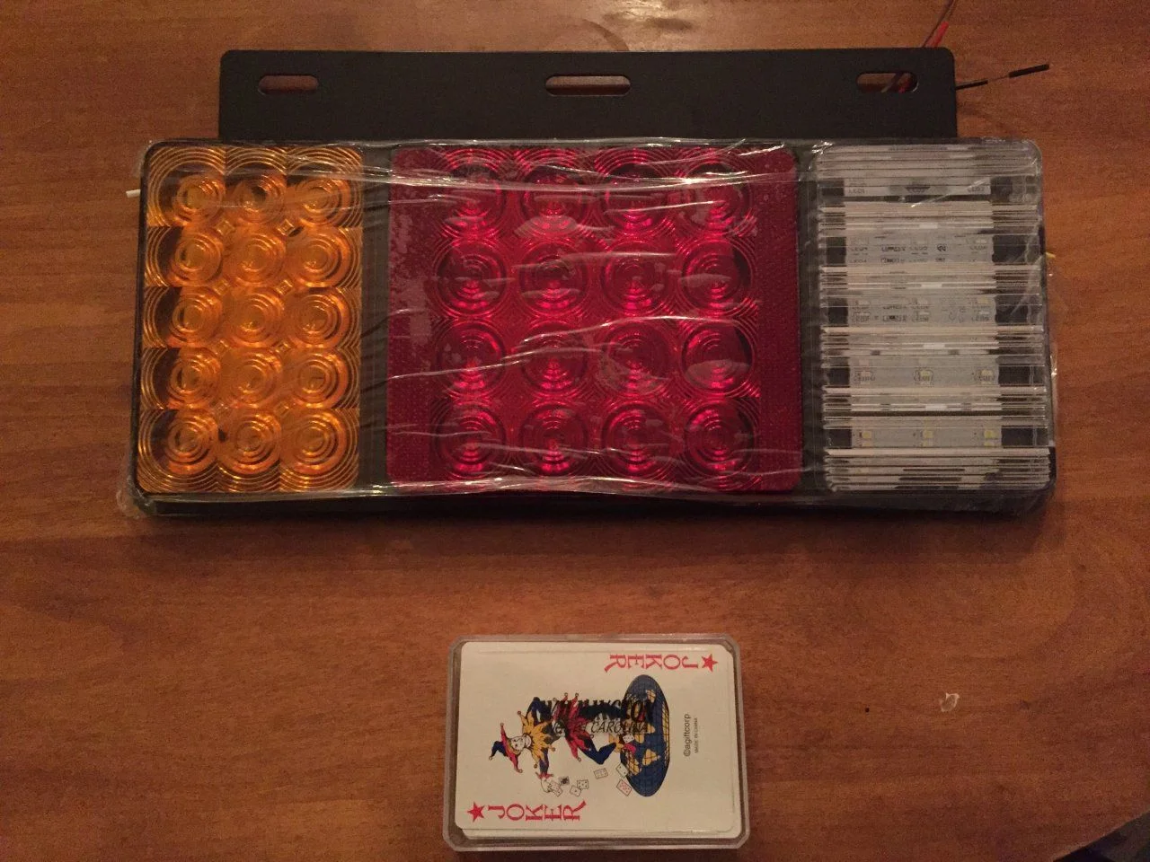

Hung the coveralls for the day. I'm pretty excited about my lights getting here tomorrow!

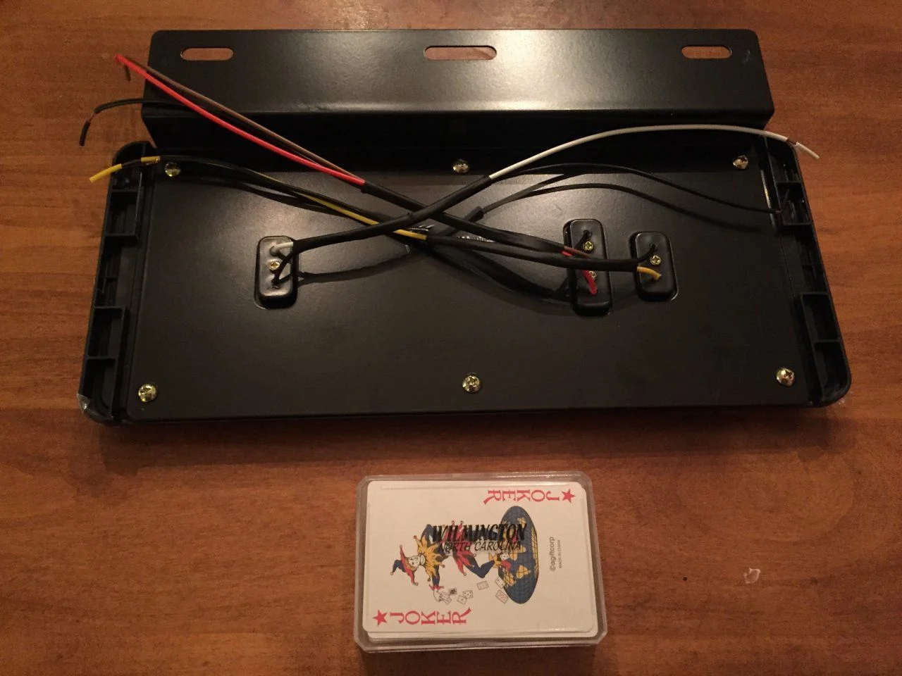

mike, build looks great man! can you share a photo of the back of those lights when you receive them please?
Pretty excited about these... They're bigger than expected, but I like em!

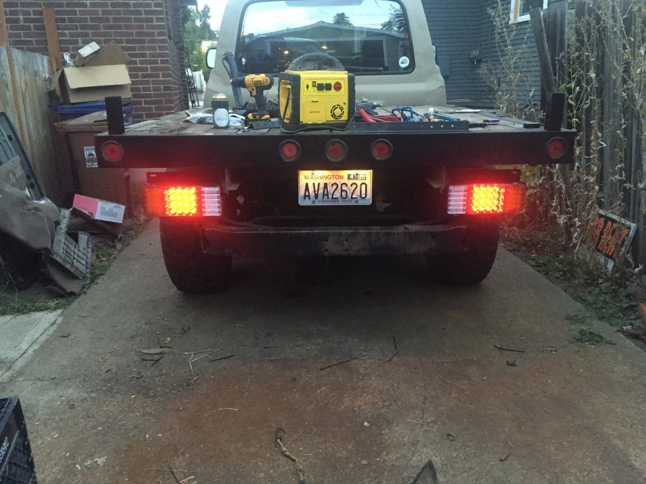

The drill quit on me before I was done, but they're wired and working. I'll punch a few more holes and finish bolting these up soon.
Happy with the license plate light, too.
Where did you source the TEQ flaps from?
Awesome. I, too, love those mudflaps and will probably have to snag a set for mine. This thing is nearly done, eh? I usually end up skipping the final steps because I want to driiiiivveee!
How do you like the monstaliner so far? did it helped hide any imperfections in the bodywork?
Thanks for the link, much appreciated!
