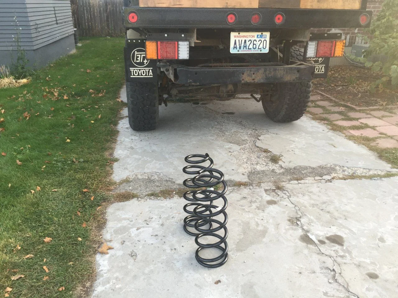

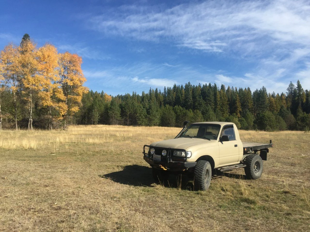

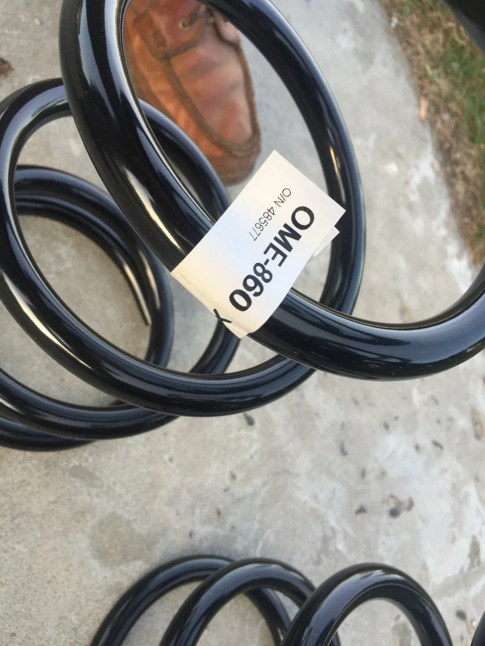

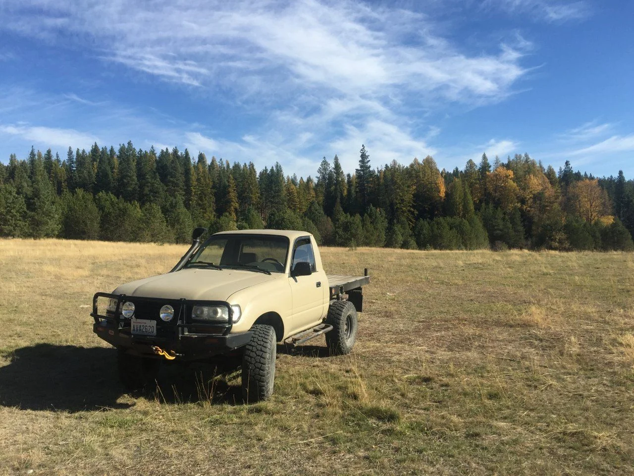

My OME mediums showed up on the porch for the rear, so I slapped them on yesterday morning.
I had a few hours to kill before we were leaving for the weekend, so I took a trip up north to scout a few campsites.
I'm very happy with how the truck sits, and satisfied with how it rides. Once I stop being lazy and replace the shocks, I have a feeling it will be way better.

So to confim, the lighter ride meant medium springs out back? You found it too light I guess. Any idea on what your box weighs?
Were the original pre chop rear springs heavies? Or maybe your old springs were tired?
Original springs were old Slee 6" from a full kit, though I believe they were fairly worn as the rig didn't sit too awfully high as a wagon compared to one on fresh OME 2.5" springs.
Shocks were not matched as far as I can tell... I don't think these are even L's.
With the rear chopped and bed on the 6" springs were too high. I don't know how much this bed weighs, but it's pretty beefy. I threw OME mediums on the rear to level it out, though it still sits with a slight rake forward. I plan on loading up the bed in the next few weeks to see how she sits with a camping load and going from there.
The idea of air bags for more consistency with different loads has always been in the back of my mind, but we'll see.
Thanks for that. I have mediums going into my chop and will be interested to see how yours work for you.

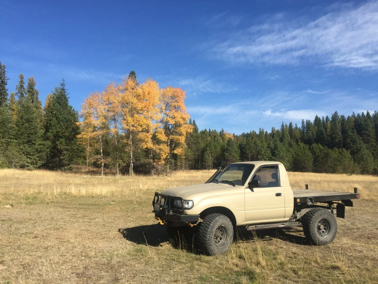

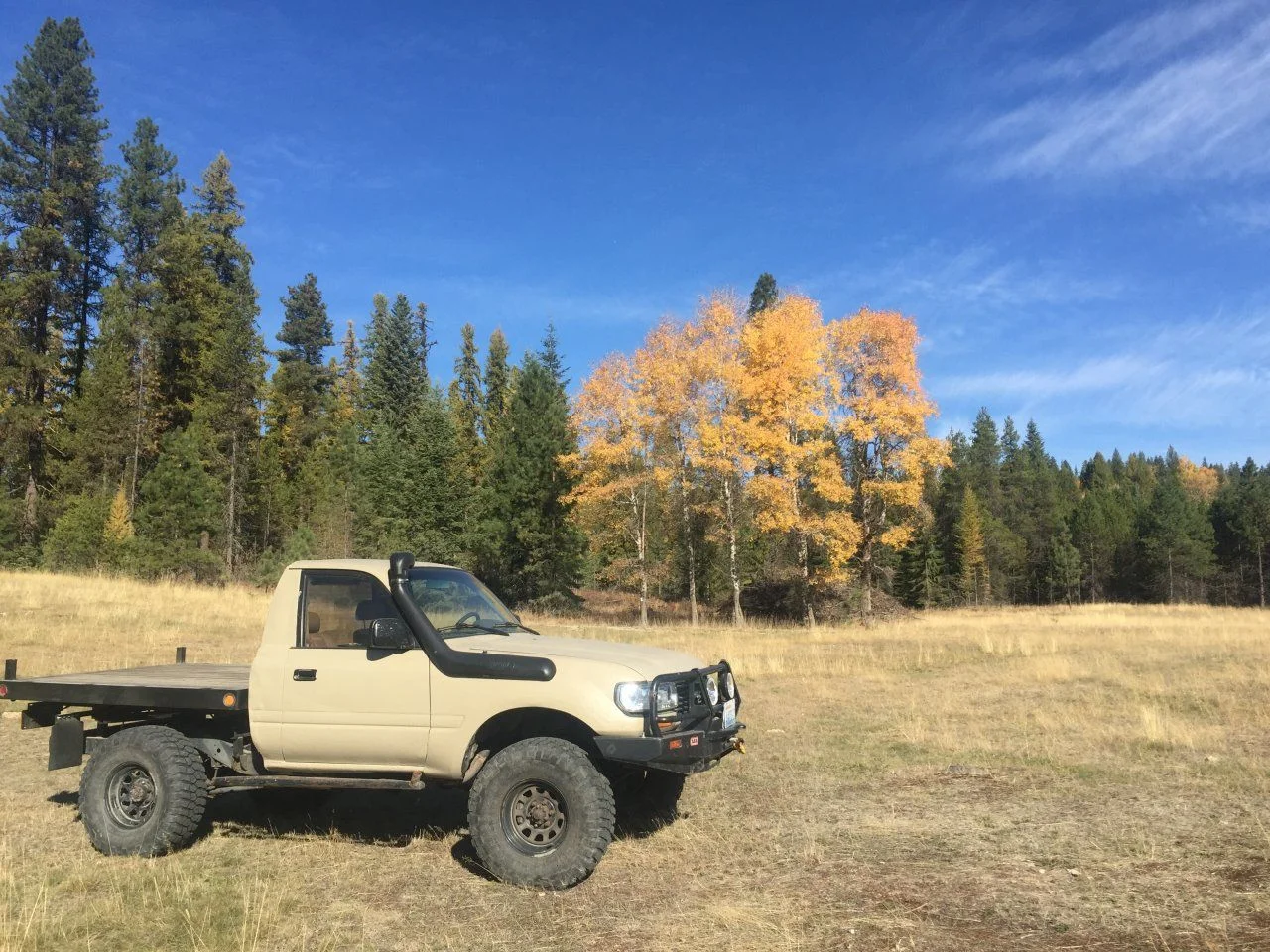

Did some more scouting for campsites, and took in some fall colors (as close as we get in the PNW)

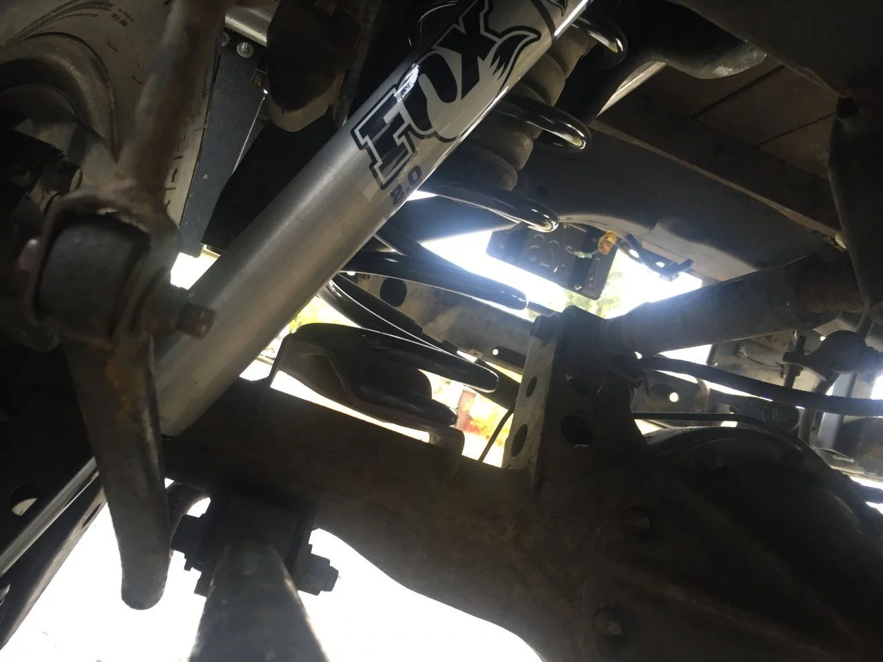

In a few thousand miles can you hit me with a overview of your Fox 2.0's?
Really want to get something to help restore some onroad plush & let the axles really move offroad.
Yours is one of my fav's for a straight 4 window cab - great work using the hatch & giving it a real finished appearance. Good rig, well executed.
Thank you! I promise you it's not that pretty up close :)
I'm chasing a vibration right now (it goes away with taller springs on the rear and gets worse the shorter I go) that I'm guessing has something to do with needing to adjust some rear control arms or something that effect. I can tell you the shocks were immediately noticeable when driving around town.
I'll do a review after a few months of driving.

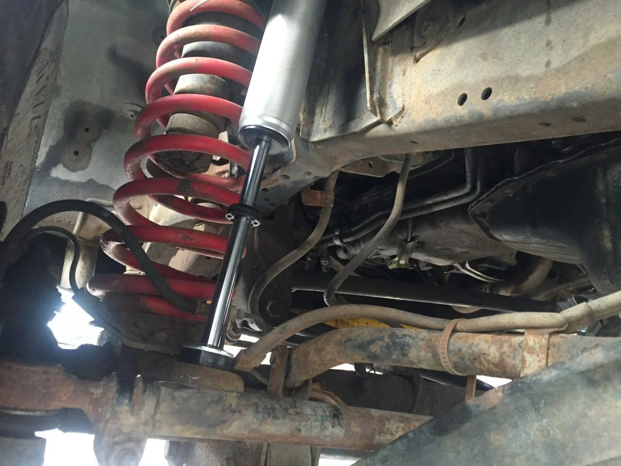

Here's one for the experts... should the bottom wraps on these coils be touching? Is there any chance these would lead to a somewhat harsher ride than expected?
These are my fronts, if that helps with anything. I was told these are Slee 6" coils, probably pretty old.
Bump for the question in my last post... any issues with the bottom two wraps on my front coils sitting on each other?

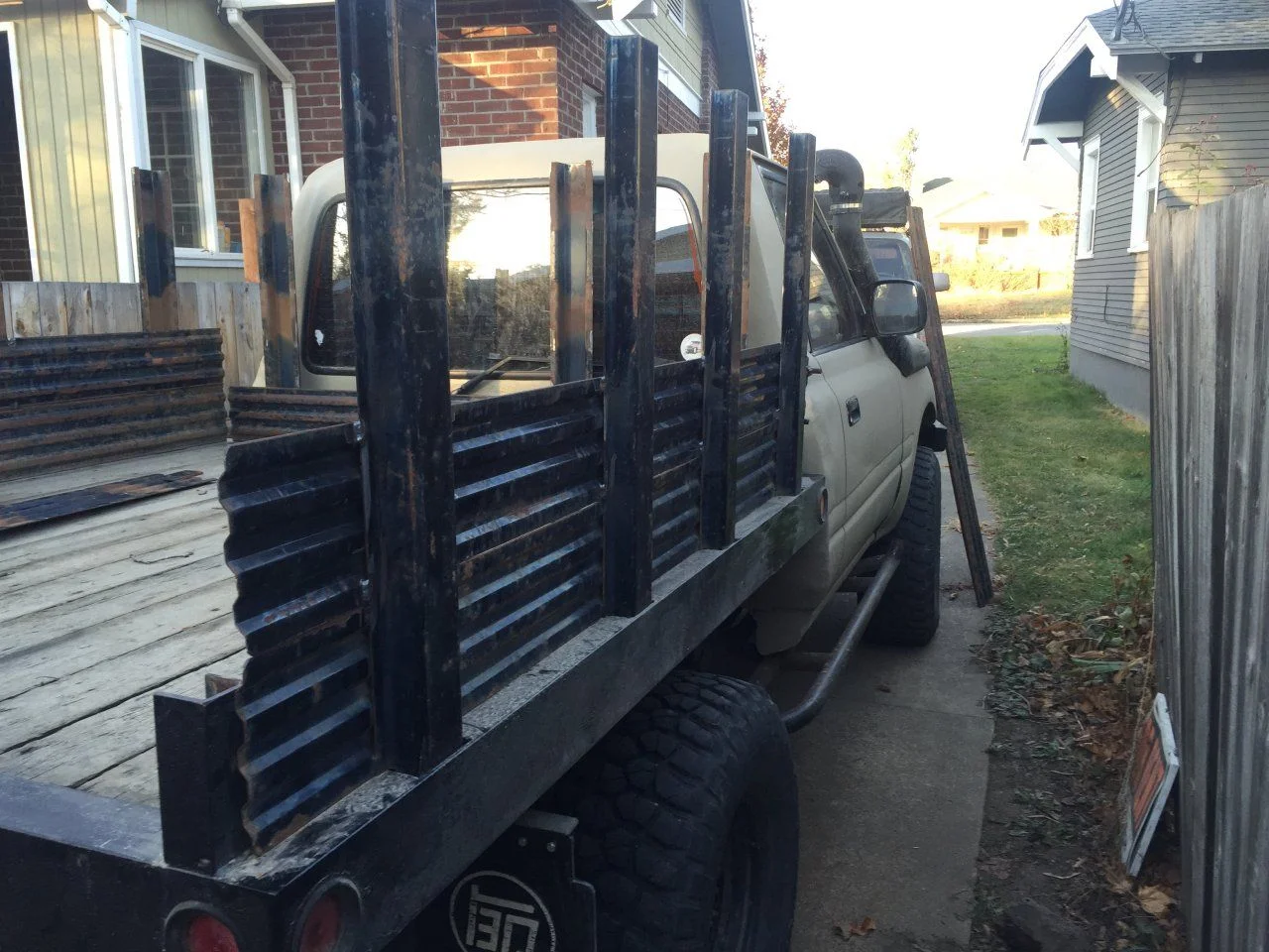

And... an update:

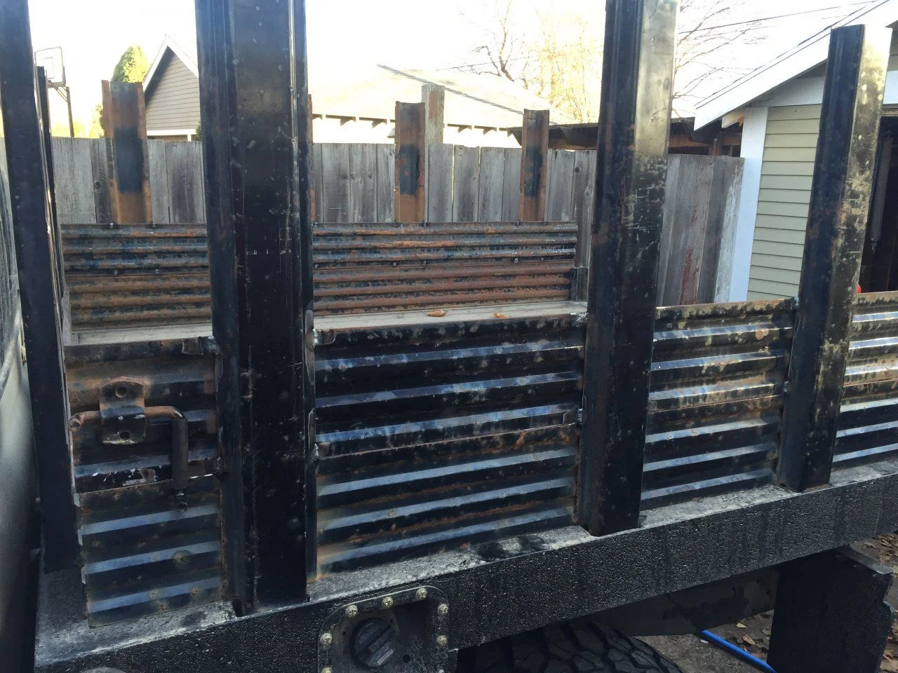

I started to re-work the stake sides. I was going to leave these alone and do something different, but I didn't want to have a random set of gigantic stake sides to store that I would realistically never use. They're neat, but I don't need em.
The goal was always to have short aides on the ute. Someday they may be shorter and hinged, but I already had these so they'll do for now.
I'm thinking about capping the tops of them (once I cut the stakes, of course) with some flat stock for a more finished look.
