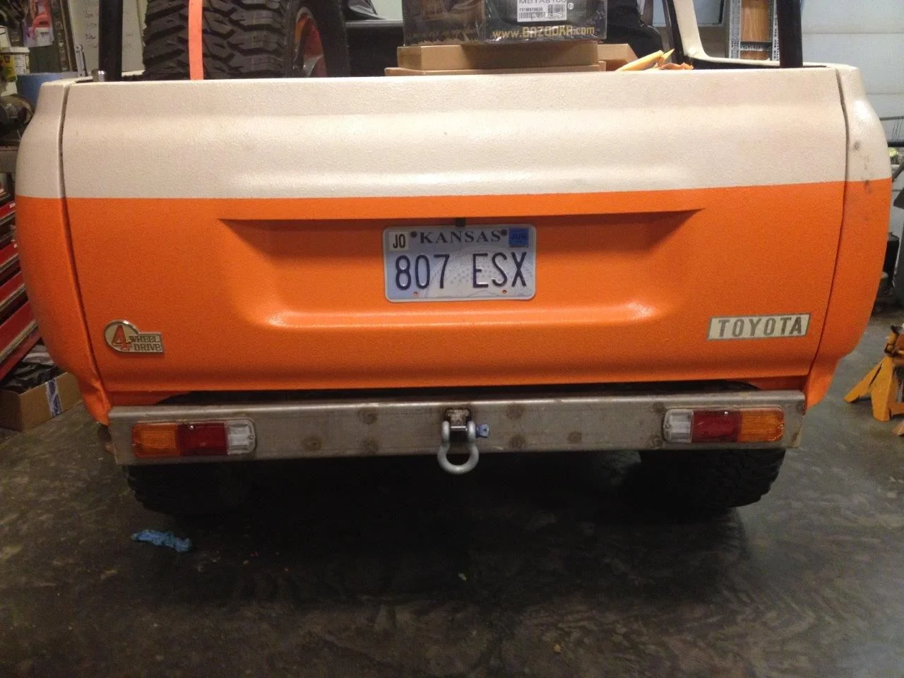

I did this on my rig, really happy with the look. Took off the damage magnets --very happy about that.
I converted mine to flush mount using LED lights and the lenses over them. This year I put a trim protection "ring" around them.
If you want that look, but a little larger, I bought a set on ebay, that I did not use. Let me dig them out.

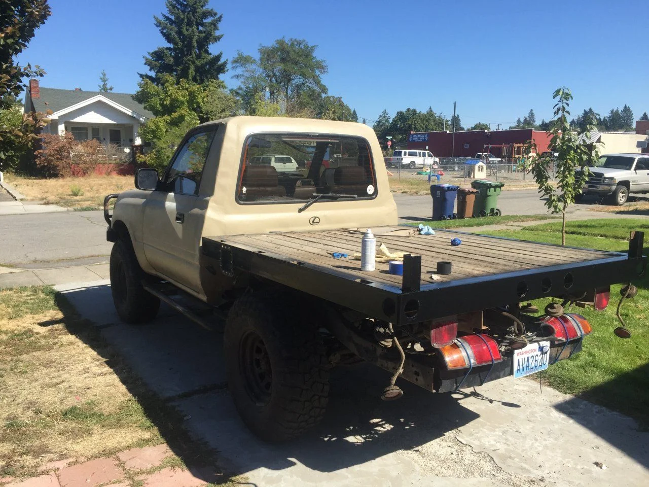

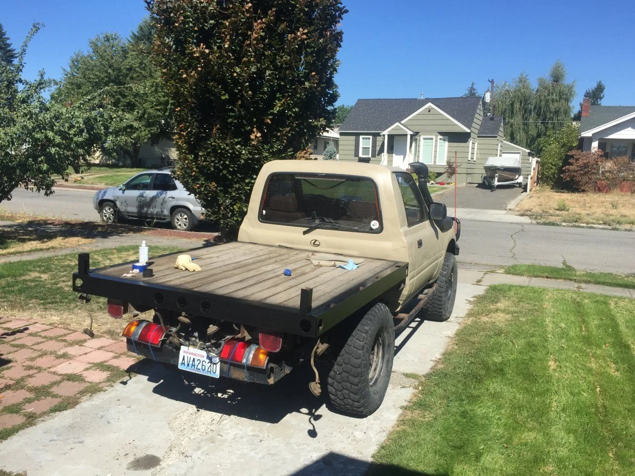

Thanks all, I appreciate the feedback! This has been a lot of fun and I'm a bit stunned with how well it turned out... she's no beauty queen, but she's exactly the truck I wanted.
Very cool, I would keep the stake sides as they are, I could carry a big round bail on that rig. Tons of room underneath as well, great score!! Make whatever you build fit the pockets and you can swap out for whatever your use. Great rig, well done.
I just had this conversation with a friend who was over for dinner. They're well made and super useful, so the stake sides aren't getting cut at all. I'll do a separate set of lower sides (maybe on bullet hinges) but won't mess with the stake pockets. I've got a pile of yard waste that I'm actually excited about taking to the dump!
Somewhere along the way I'll make a removable rack for the RTT.
Mudflaps, some OME mediums, and wiring are next!

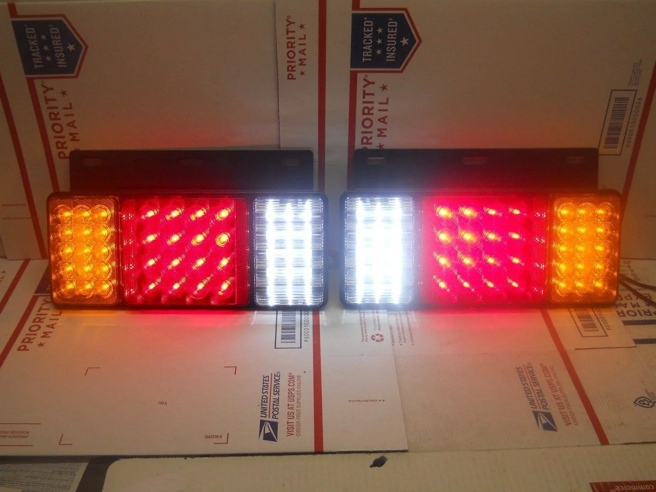

Thanks for the offer on the lights... I had considered FJ40 tail lights but wanted something a bit larger. I do love the idea of keeping things Toyota, but I already grabbed a pair of these:
These are LED tail lights made for an Isuzu NPR.

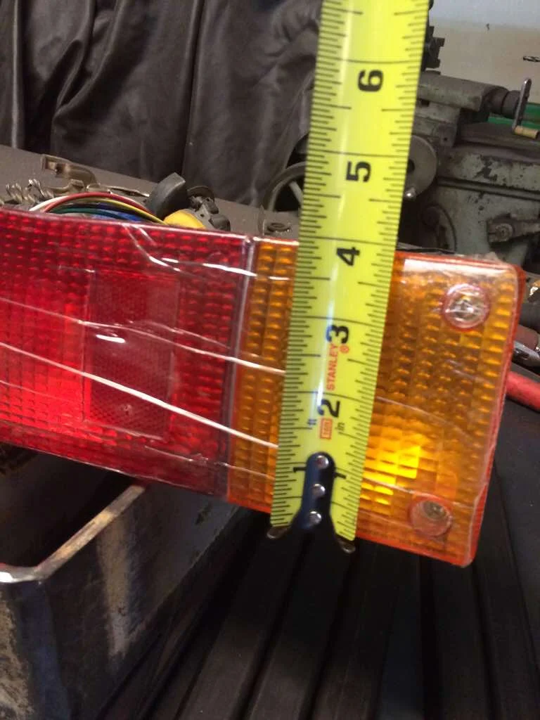

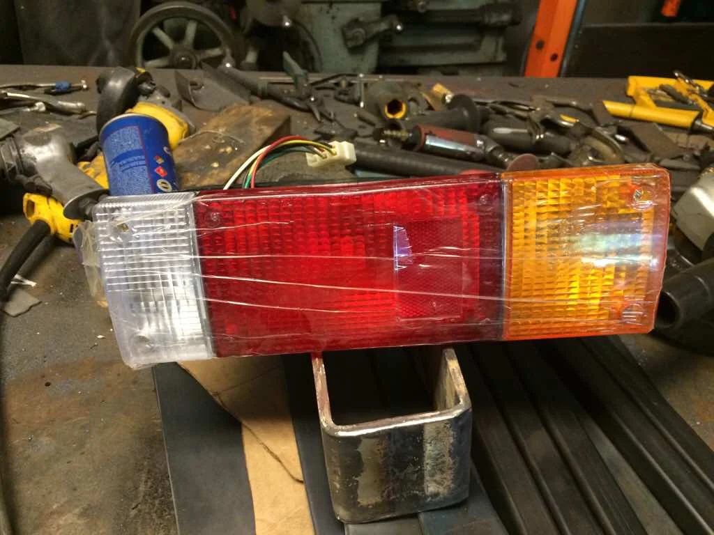

Do you have a picture of those NPR tail lights on the back of your truck? I'd like to see what size they are. The price on them is better than some of the other options I have found.
I'm still debating Samurai or fj40 tail lights.
Here are the ones I found eBay they were little smaller.

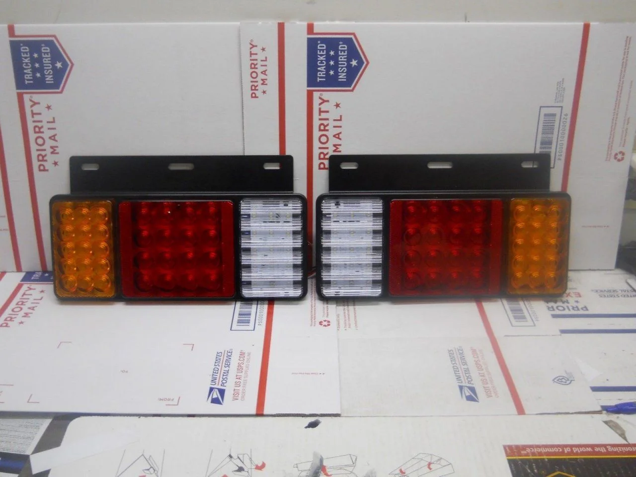

Many of the NPR tail lights have plastic housings, but these LED's are steel (based on advertisements).
These look pretty clean, and I'm all about some LED's:
(pics from ad--I'll get pics of the housings when I get em)

Of course, once the tail lights are on she'll be a driver. That's the important part!
