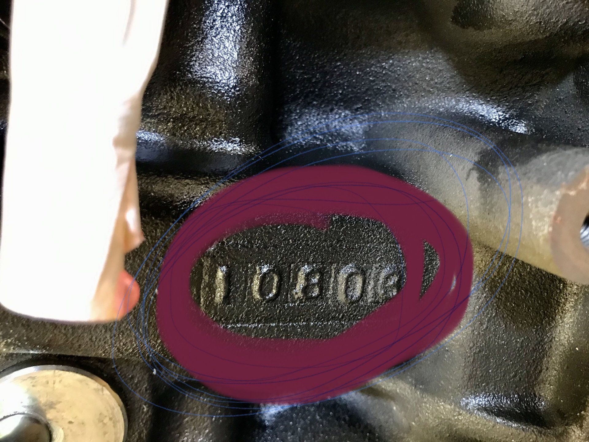

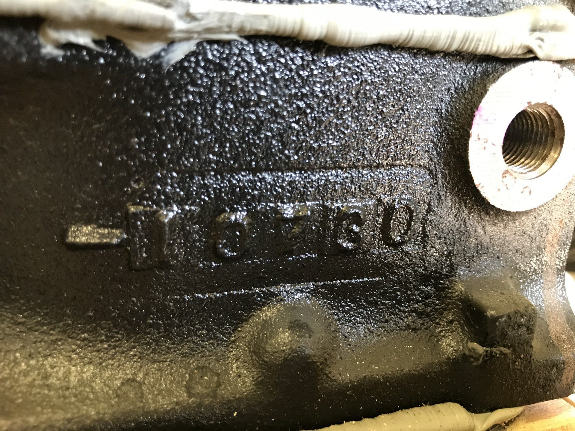

So a bit more about the engine: once it arrived today I asked Ian to get me pics of any numbers on the block to try to ascertain date of manufacture...
The block stiffener/bearing cap plate had “10730”= 07/30/2001
The block itself had “10803”= 08/03/2001
So, pretty far out. This has been sitting around since 2001 in a warehouse in the GCC.
Long block assemblies for service part support are only manufactured for the first 8-12 month of a new engine part number being installed into vehicles— mainly in case there is a warranty claim and an engine can quickly be swapped out. After this time period, the long block is discontinued and superseded to a head and short block assembly that then has to be “built.”
In any event, pretty damn cool historical, truly NOS beauty here. Now the research/part intensive process of “converting” this into a mechanically controlled engine vs. original -FTE configuration.

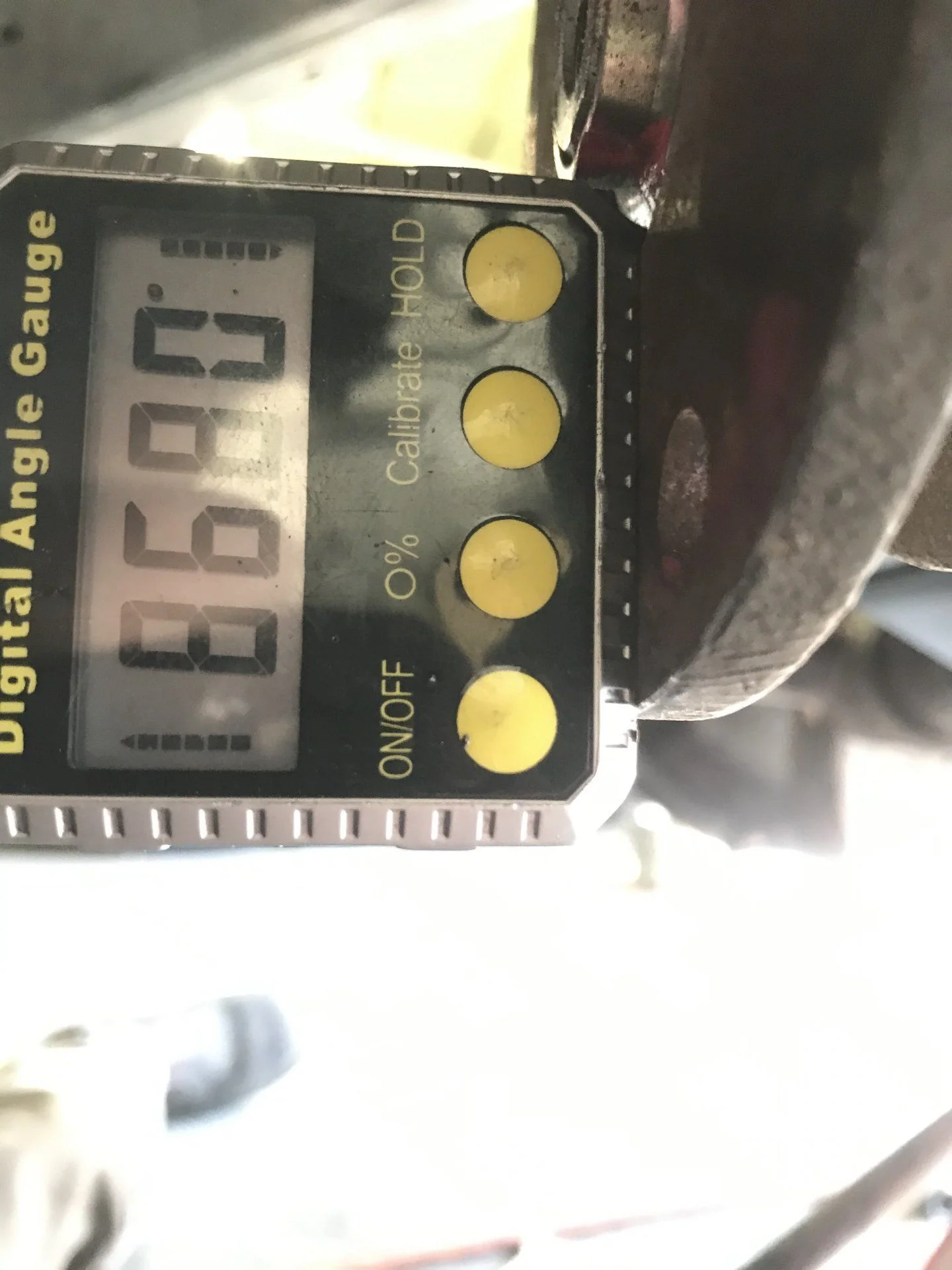

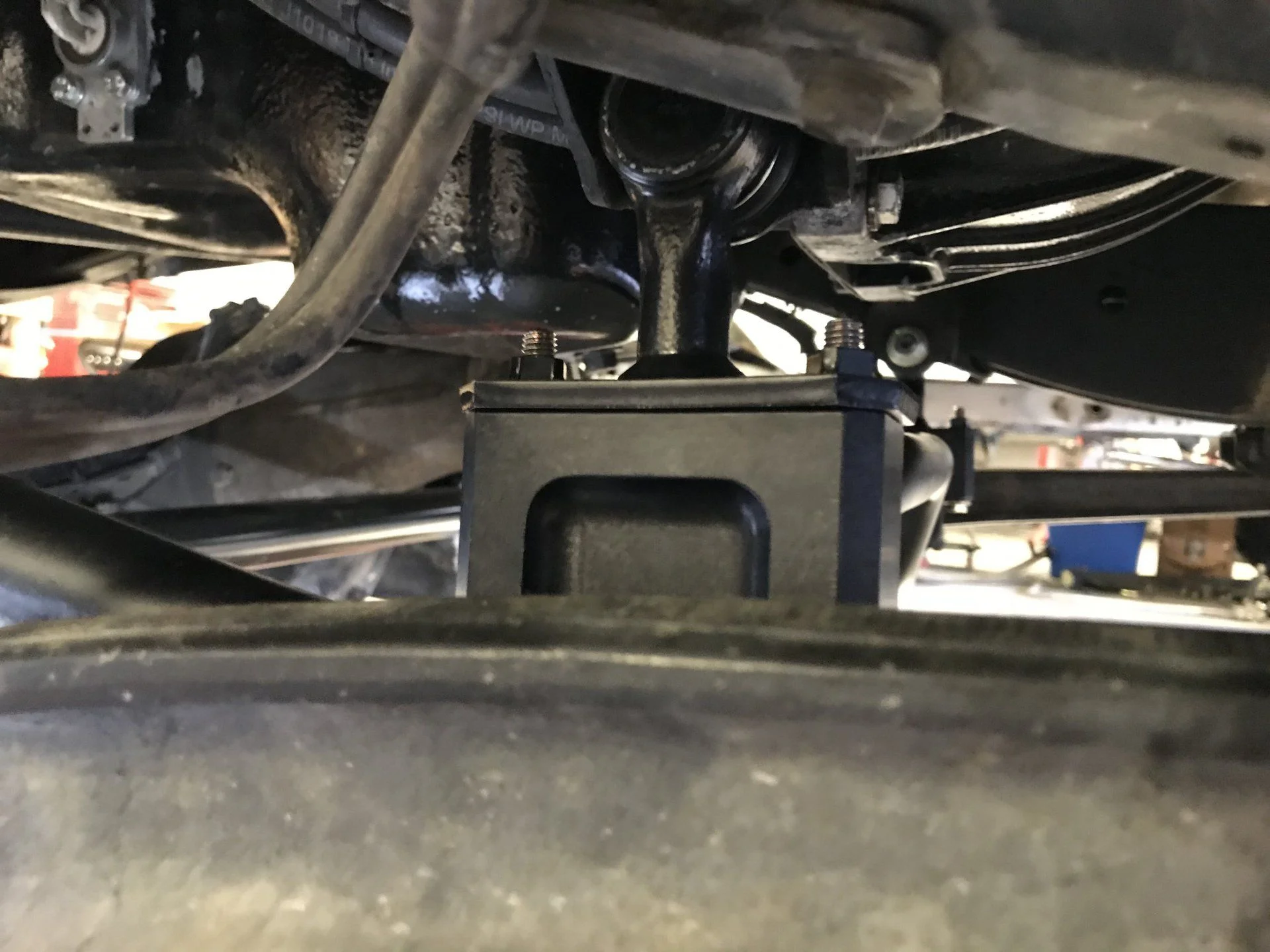

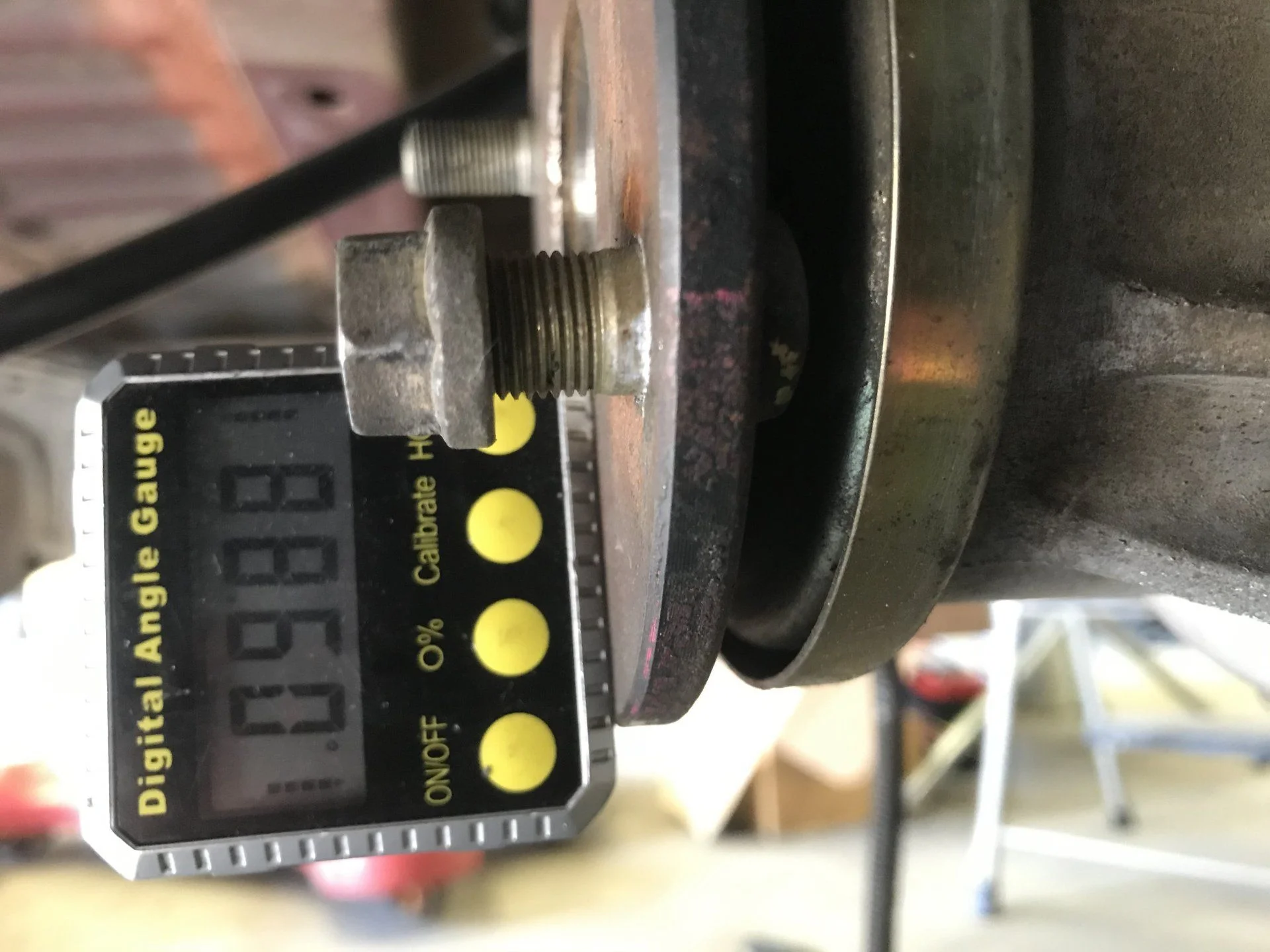

Also, rear pinion angle is off by about 1.8*. I am sure it will change as all the other goodies get added but to get it fully dialed in, we decided to order some adjustable RUCA.

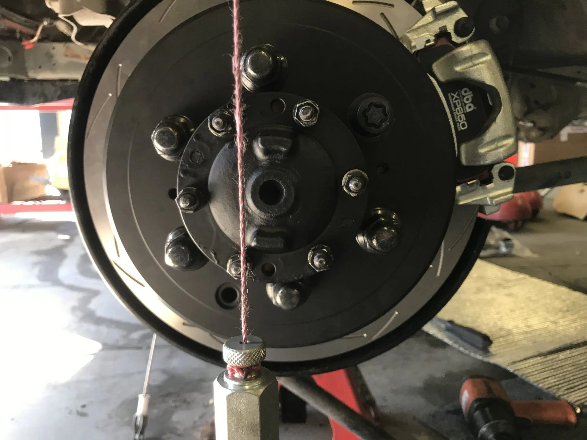

Rear axle is also a touch out of center in rear wheel well. I will be dialing that in as well.
Cheers

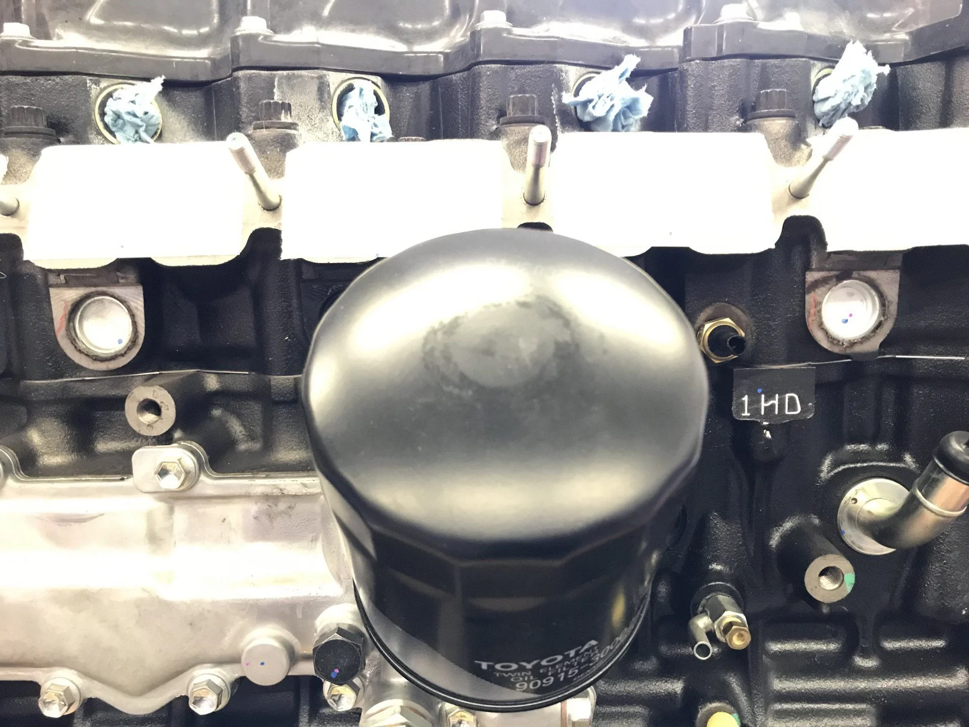

@Onur Is this a NOS 70 series FTE or a 100 series FTE?
Nice, I wondered since the valve cover did not say "Intercooled" on it.

Which GCC country was this stored? Oman?
Not sure those types of decals would be included in a replacement engine.
EPC shows a valve cover-valve cover which looks like it may have had any “EFI” or “Intercooled” decals on it?
Cheers

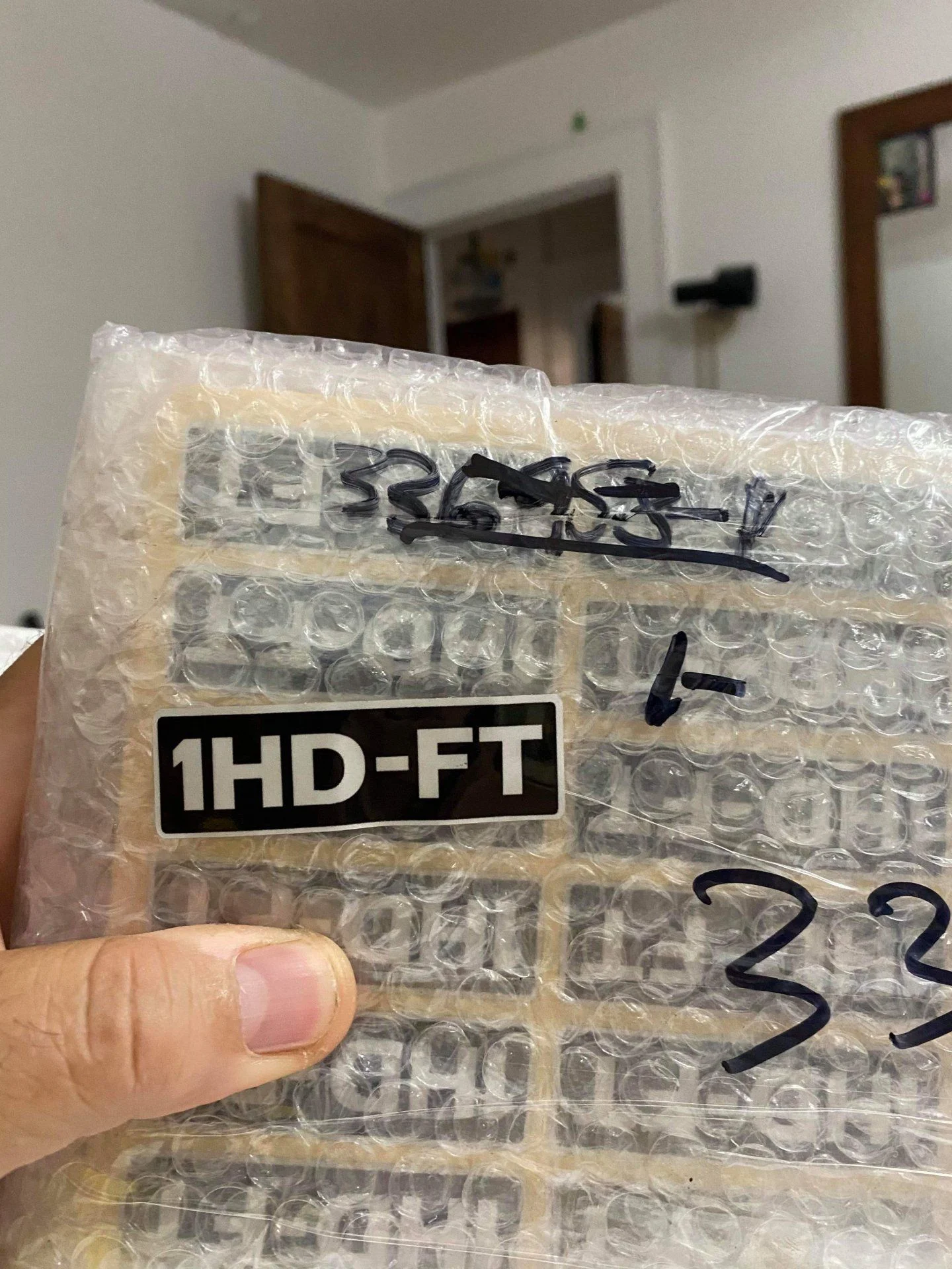

Here’s a little somethin’ that might be beneficial for this project...
Or does this unicorn motor just get the regular FTE sticker???

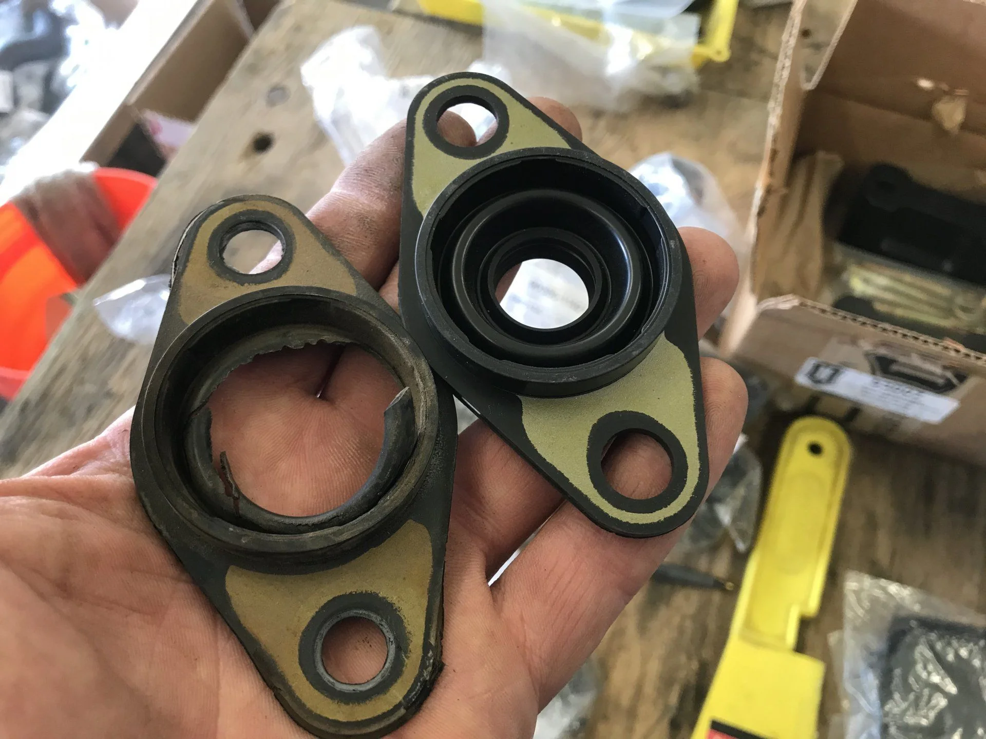

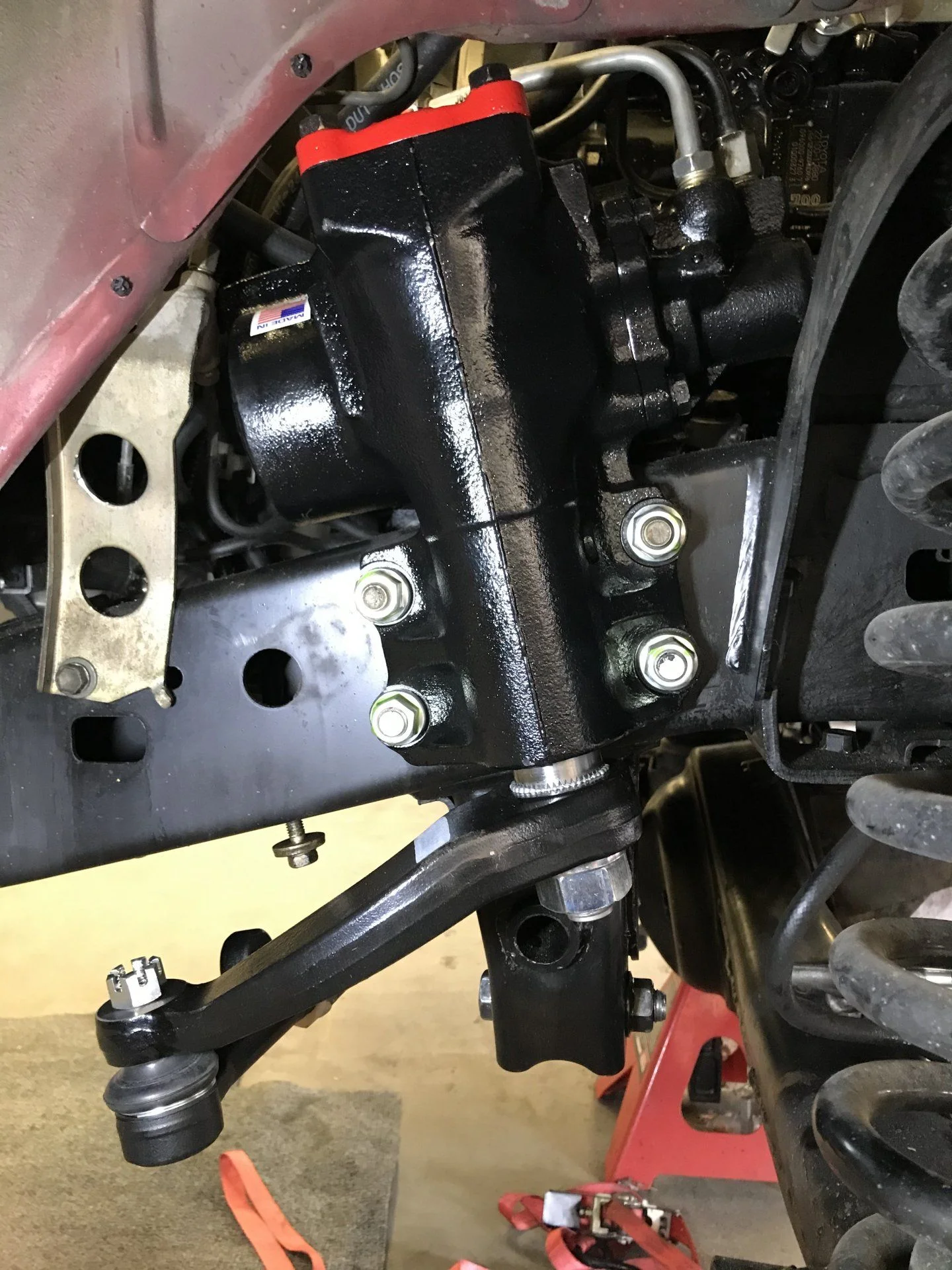

Old vs new

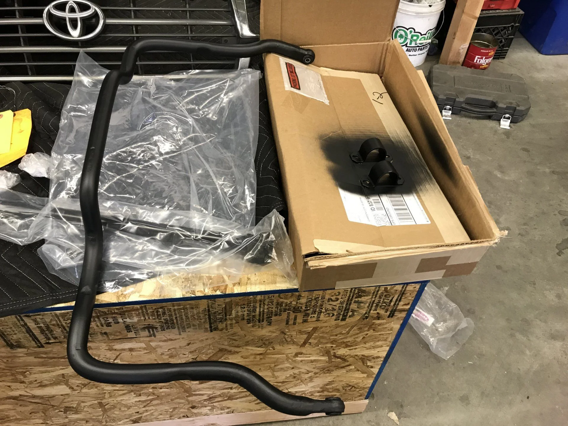

Cleaned and ready to install.

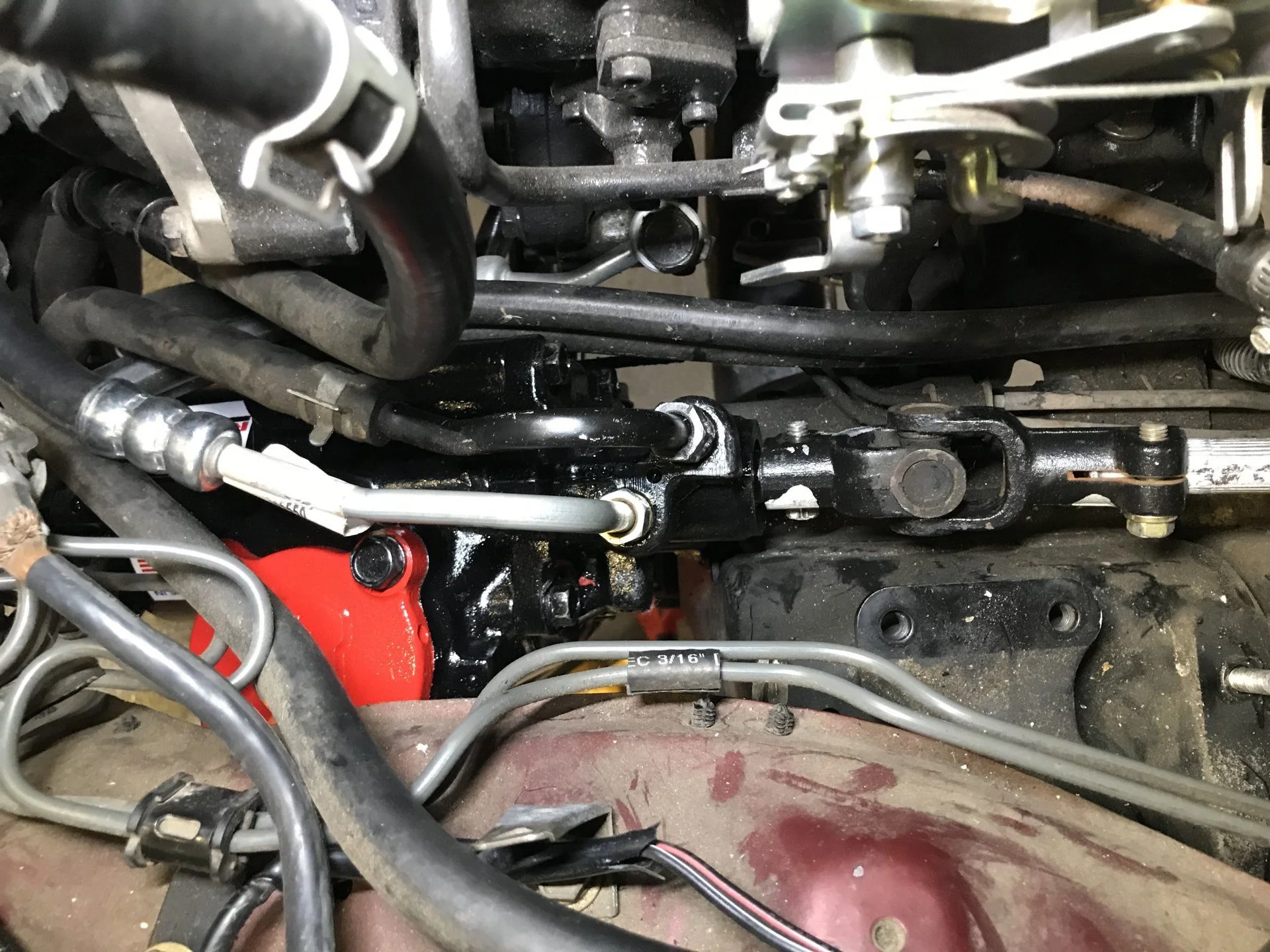

RedHead box installed.

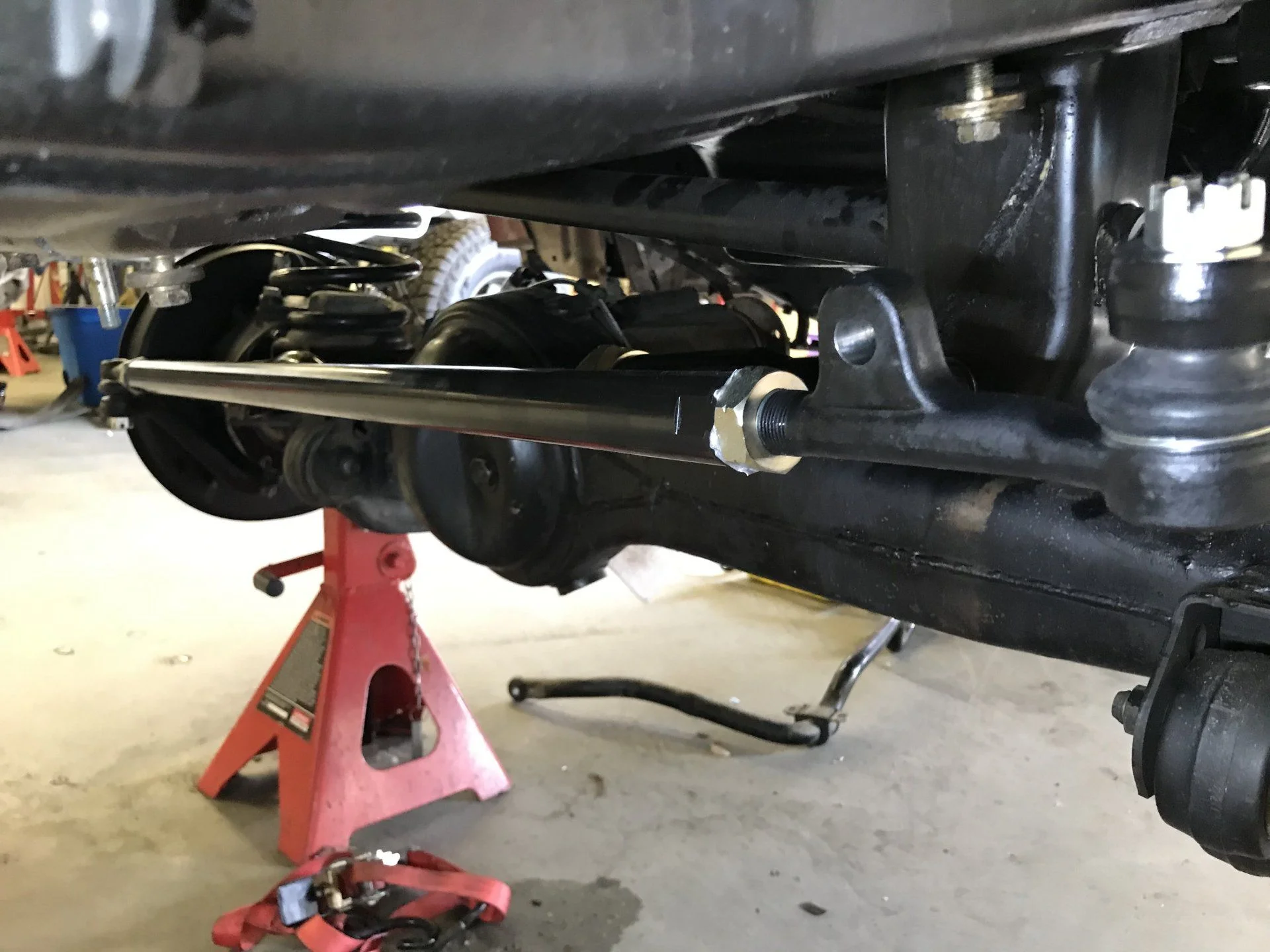

SLEE HD drag link installed with OEM tres.
Cheers

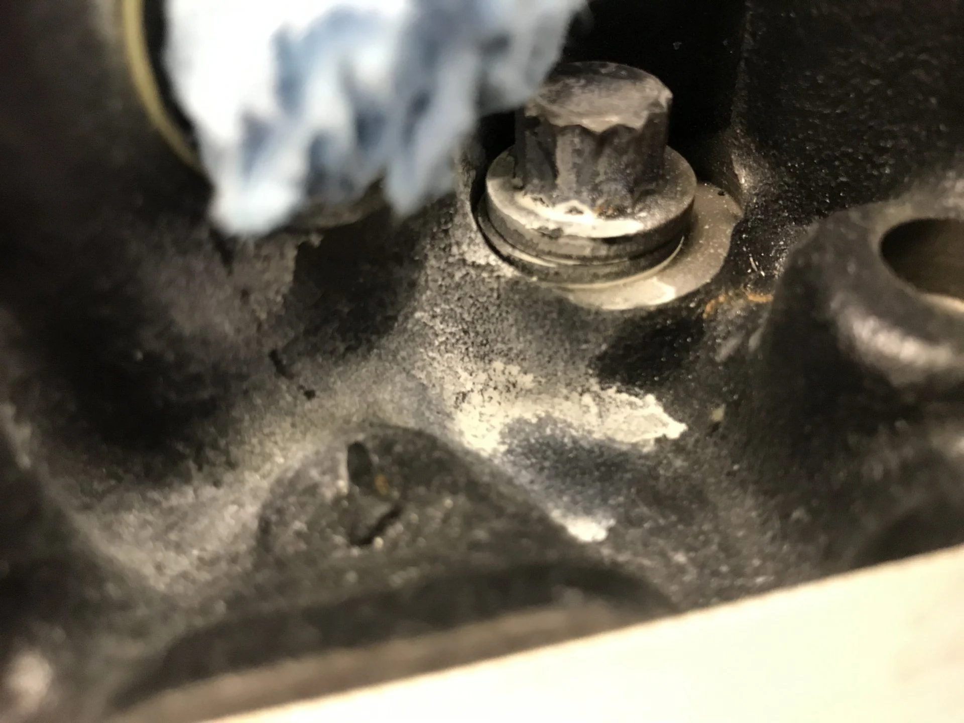

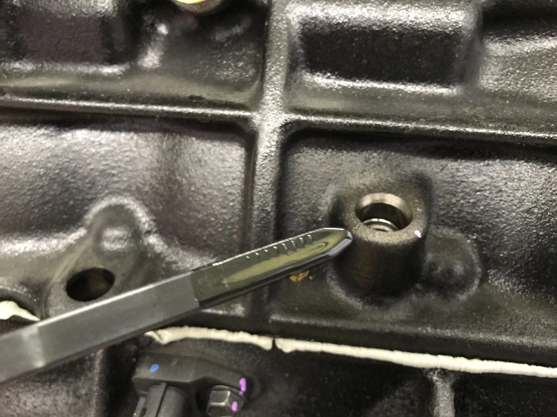

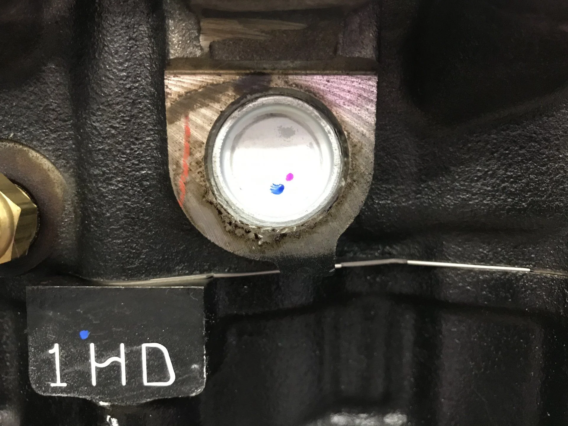

There is oil in the engine.
Wondering if it wasn’t pressure tested and the two white freeze plugs were fails?
Also appears the injectors were pressure tested with something?
