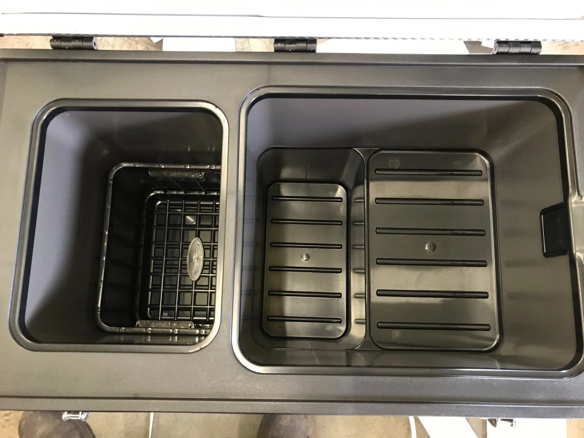

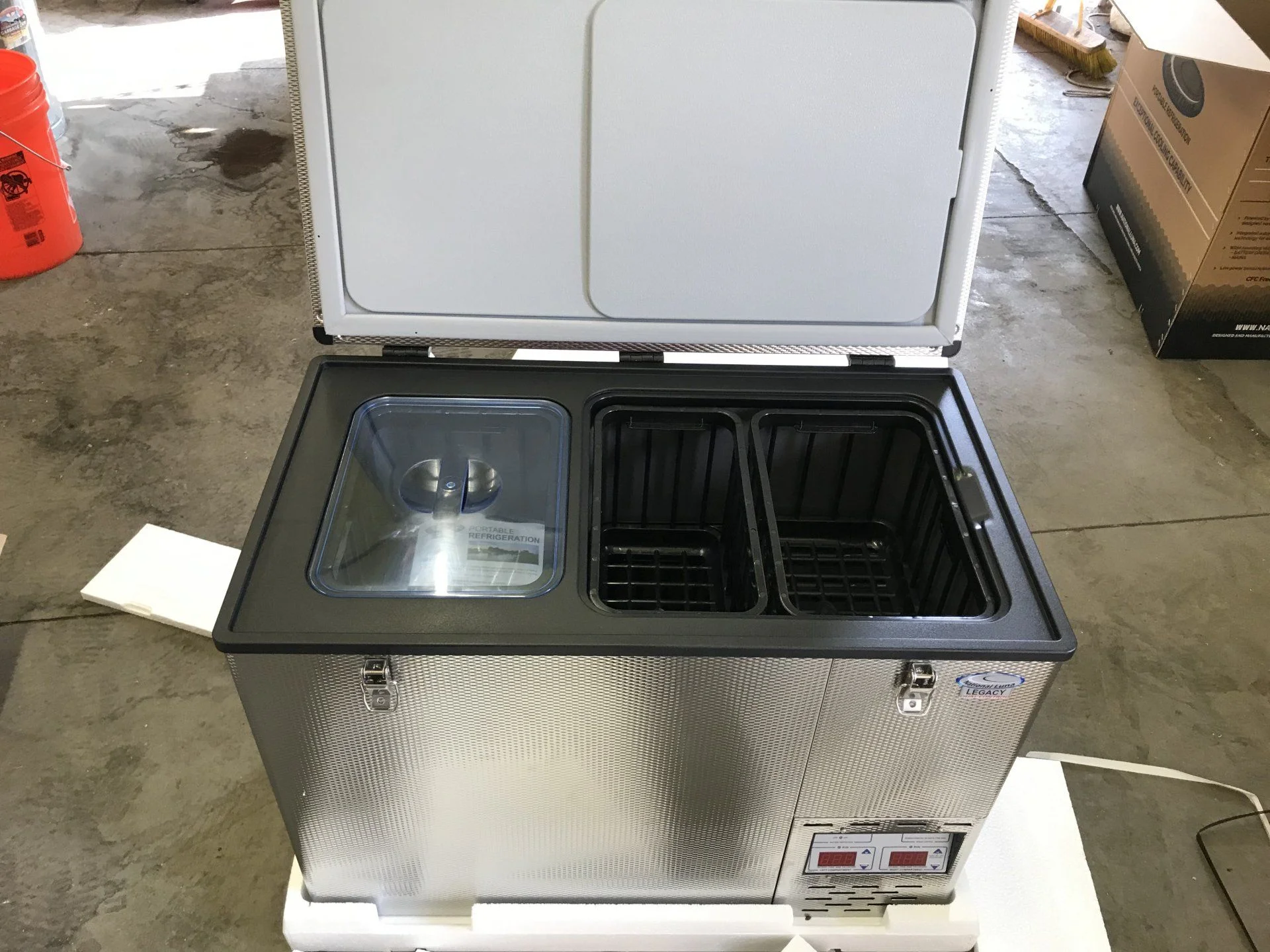

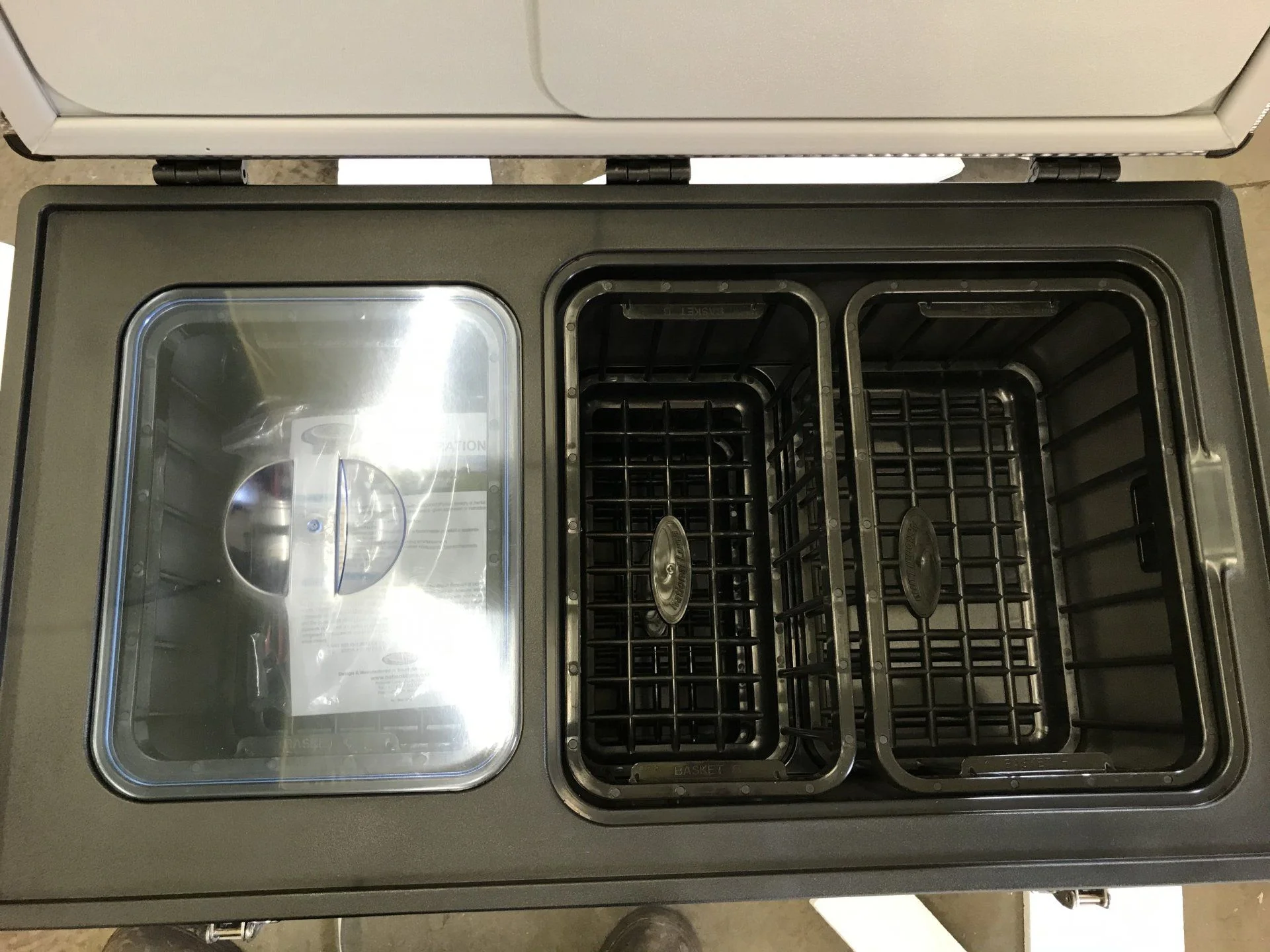

want to trade that one for a box that doesn't look brand new? :lol:
Rust free truck, box got scrubbed clean. Still 180,000 on it and it’s getting goodies. 😉

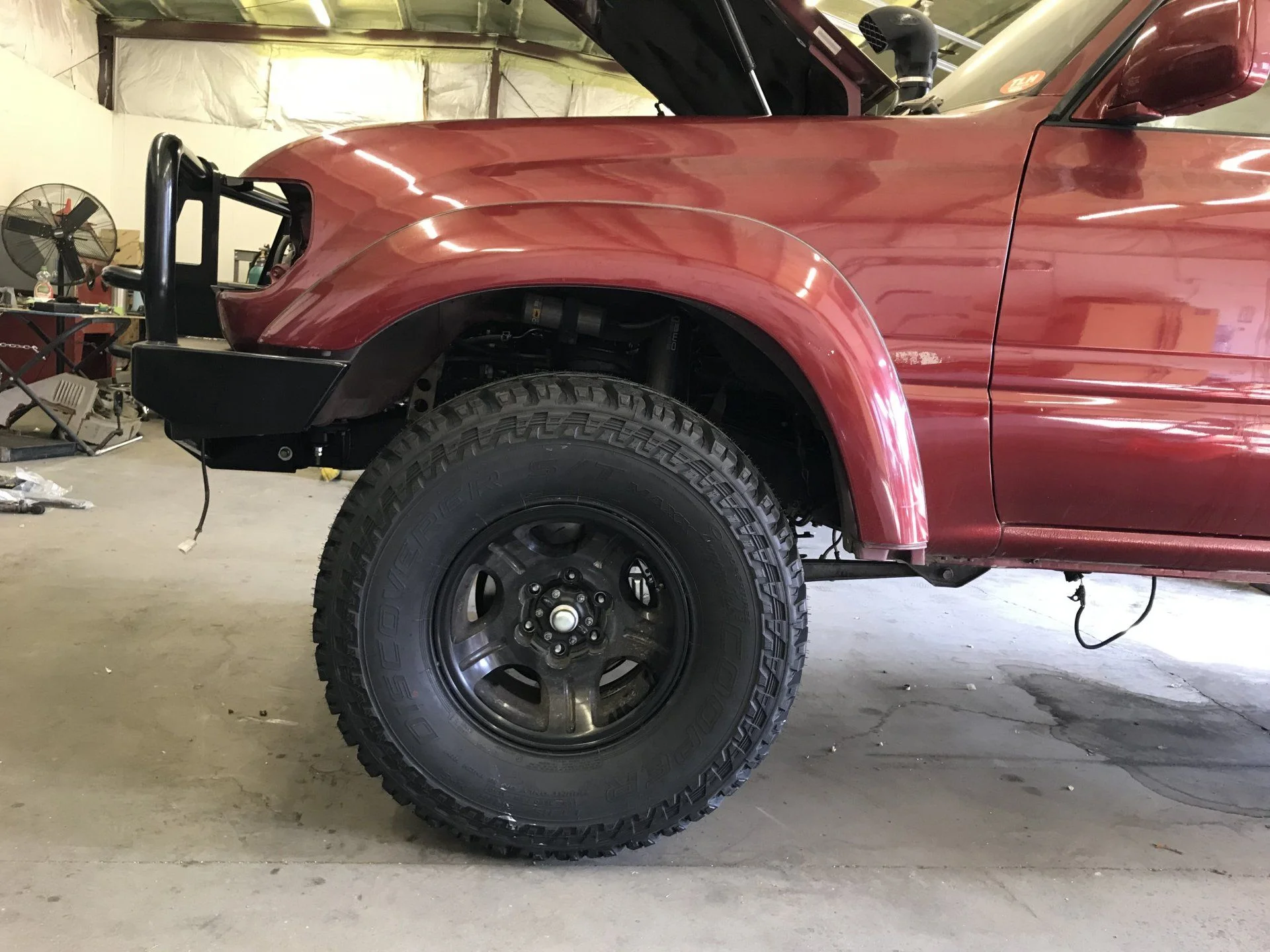

While the wheels are off the truck I decided to take the opportunity and order a new set of 315/75/16’s. Ended up going with the Cooper ST Maxx. Been a big week of purchases. Definitely going to have enough AMEX points for first class seat to Boise.

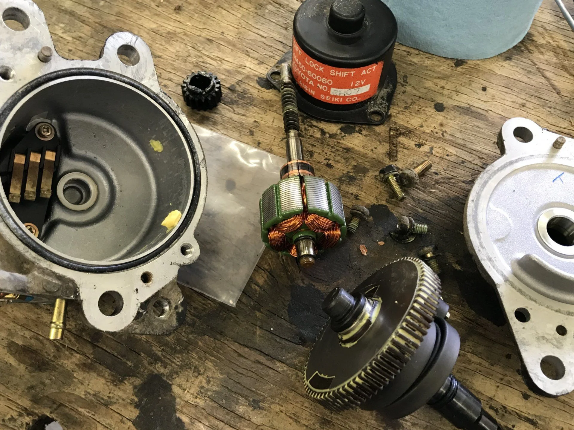

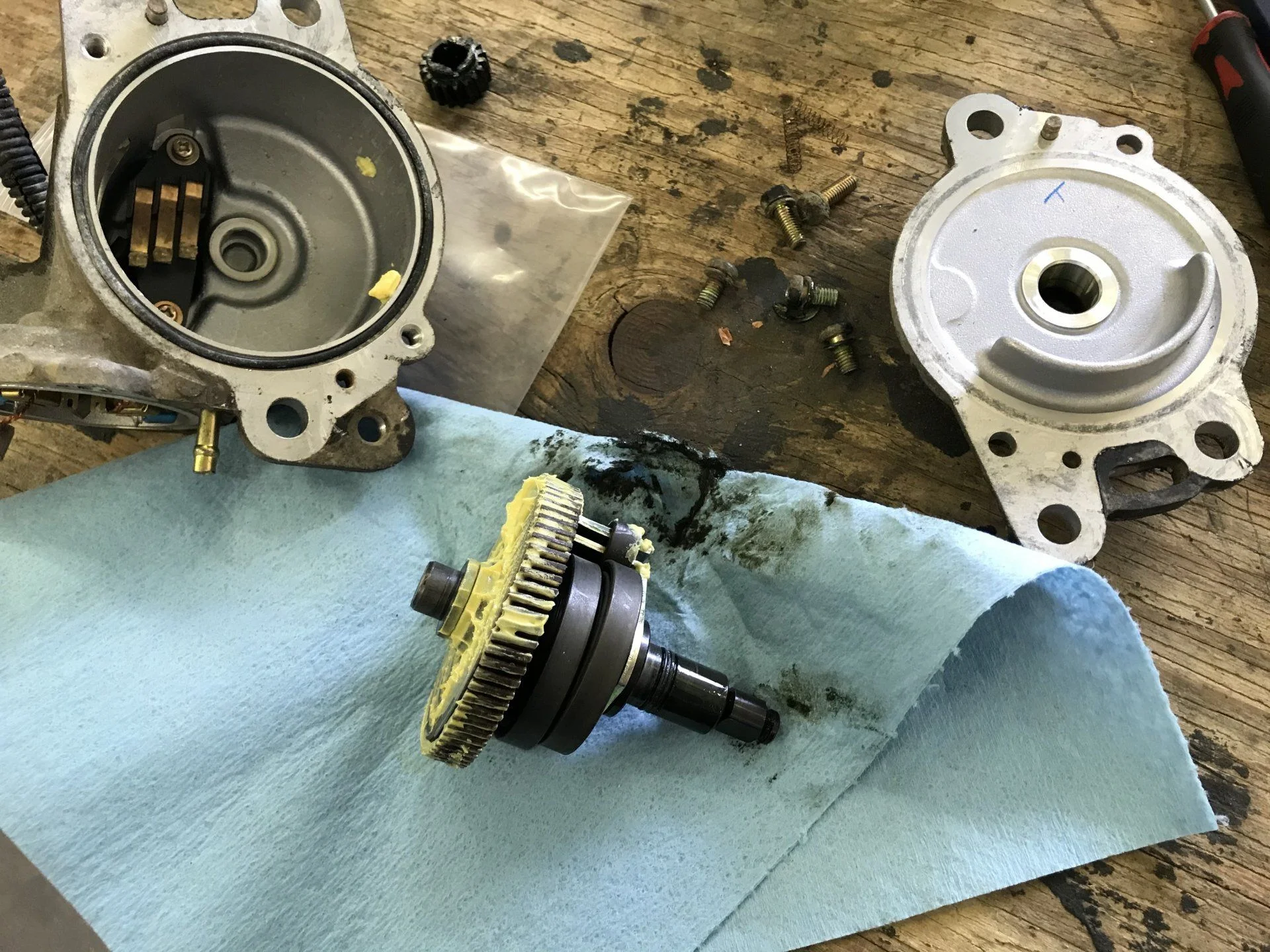

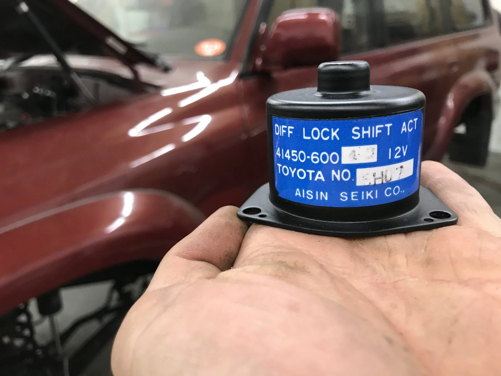

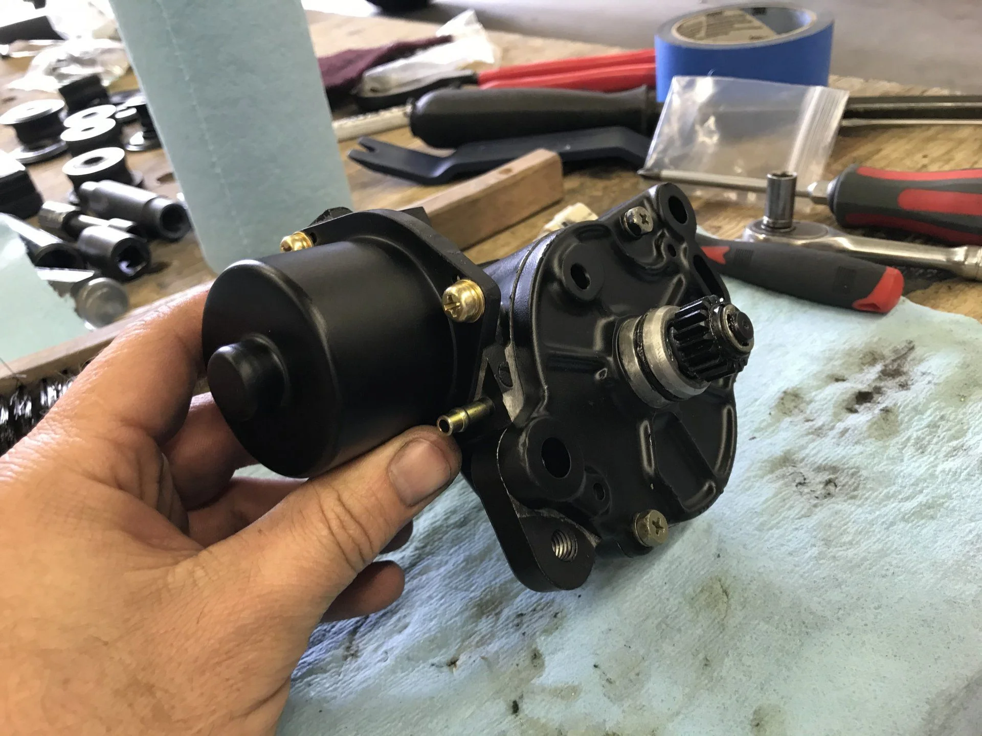

I rebuilt rear elocker today, not ready to post all the pics but here is a sample of what is to come.

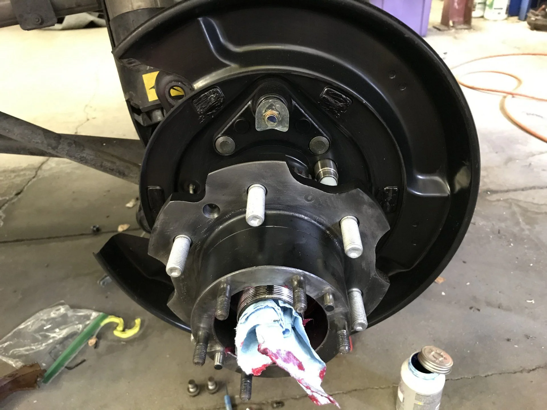

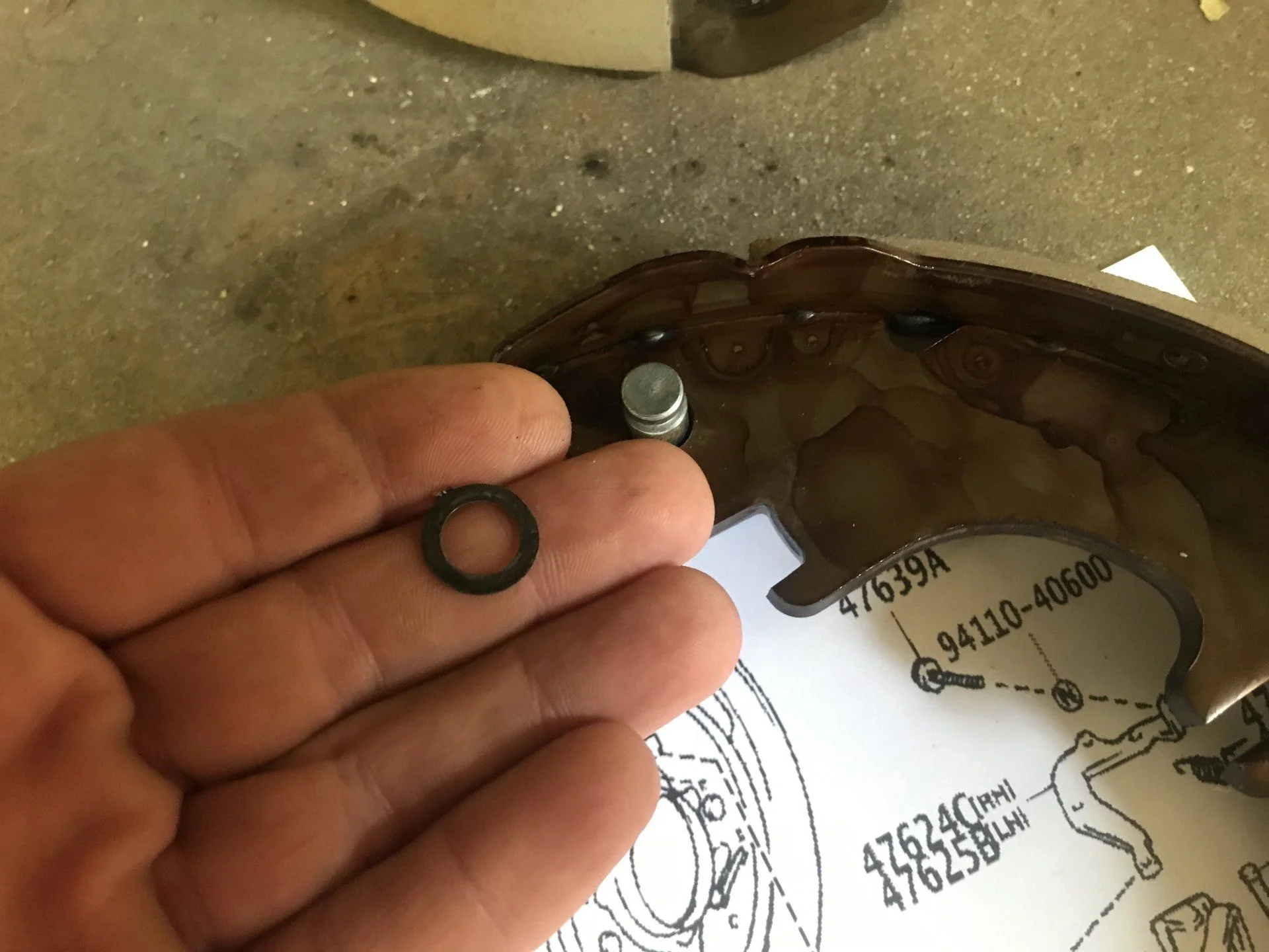

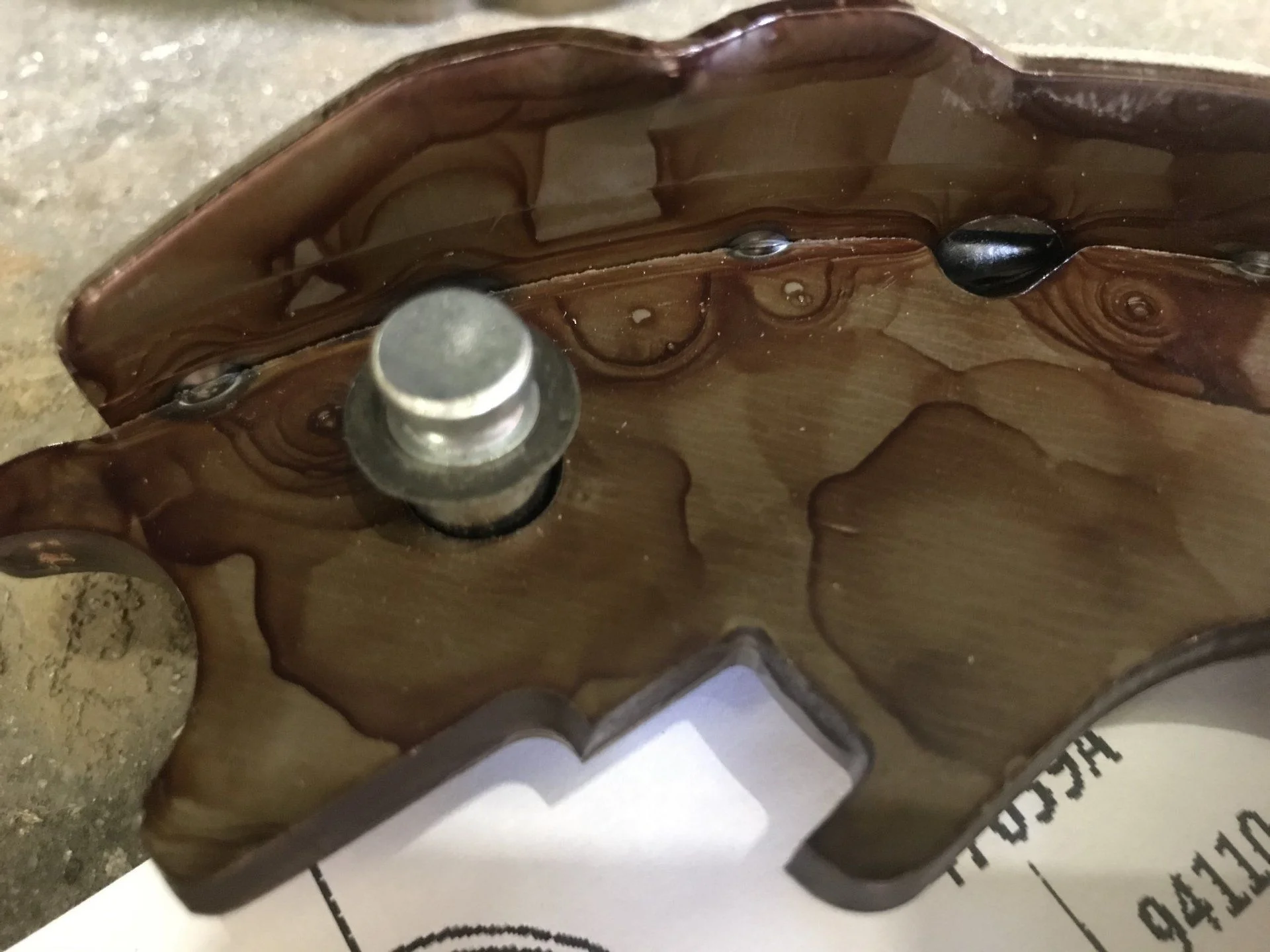

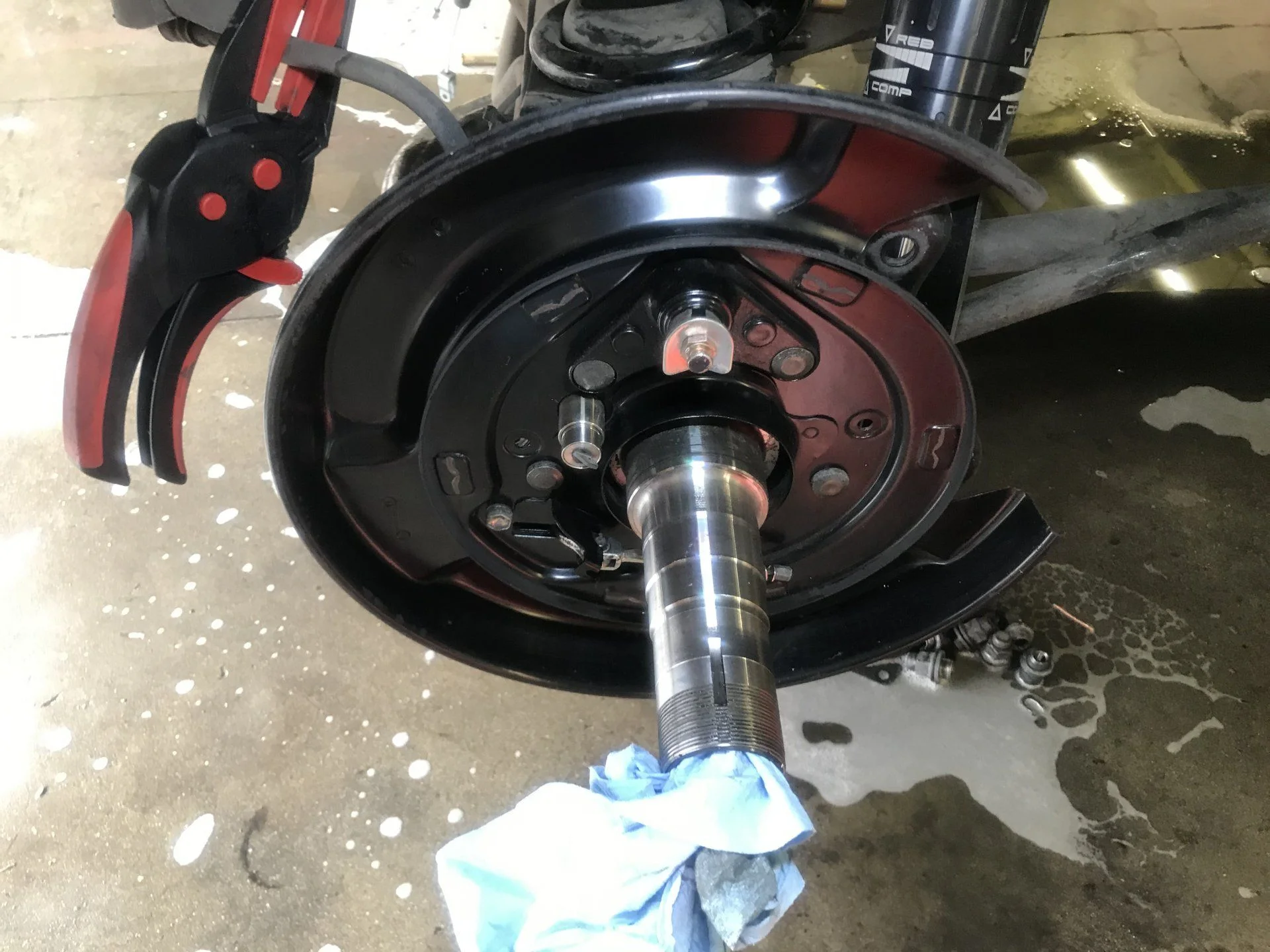

This shim-washer is holding up rear axle assembly, I should have the correct ones in route.

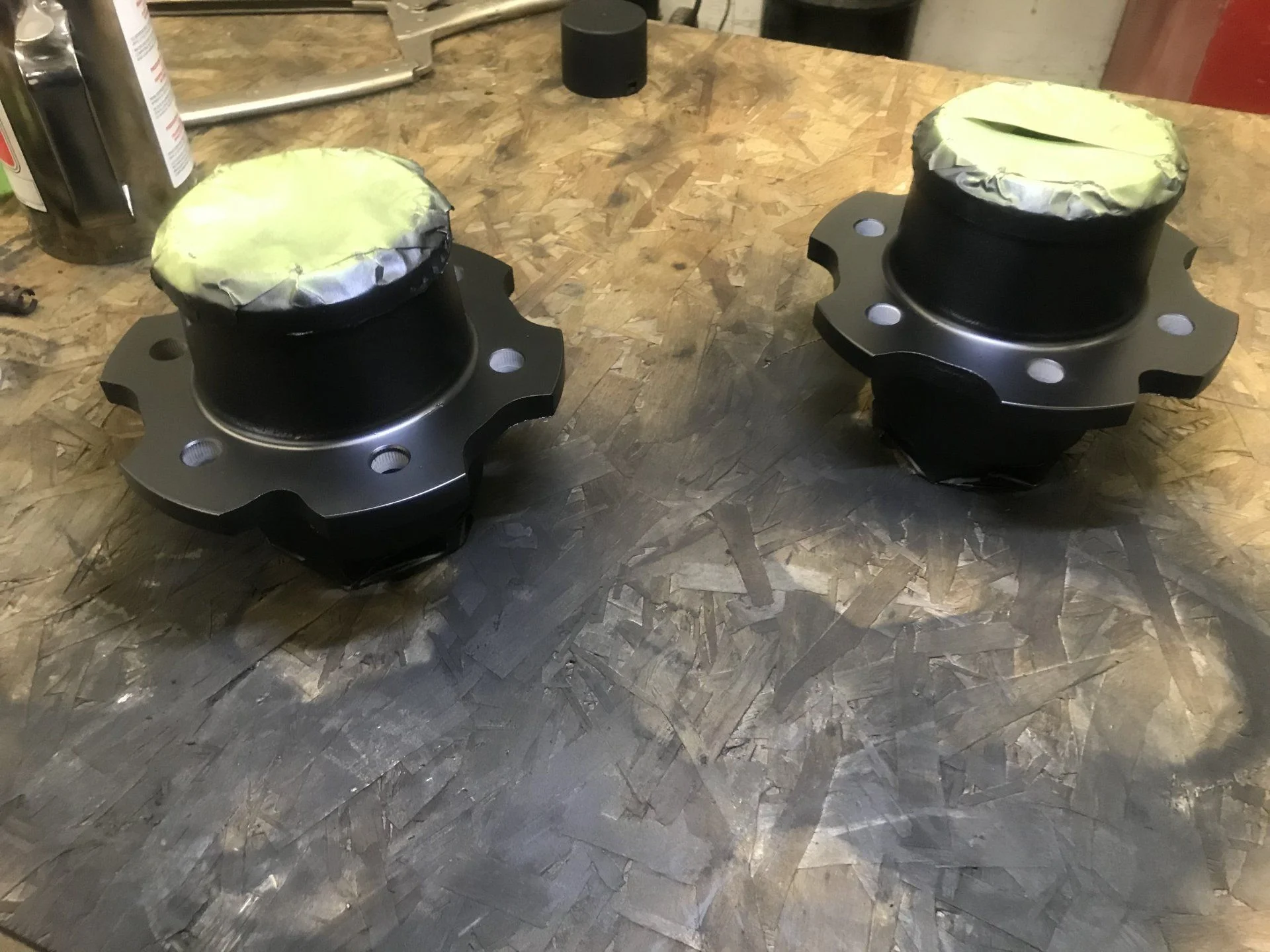

Front elocker torn down and cleaned, paint it tomorrow and reassemble plus install.

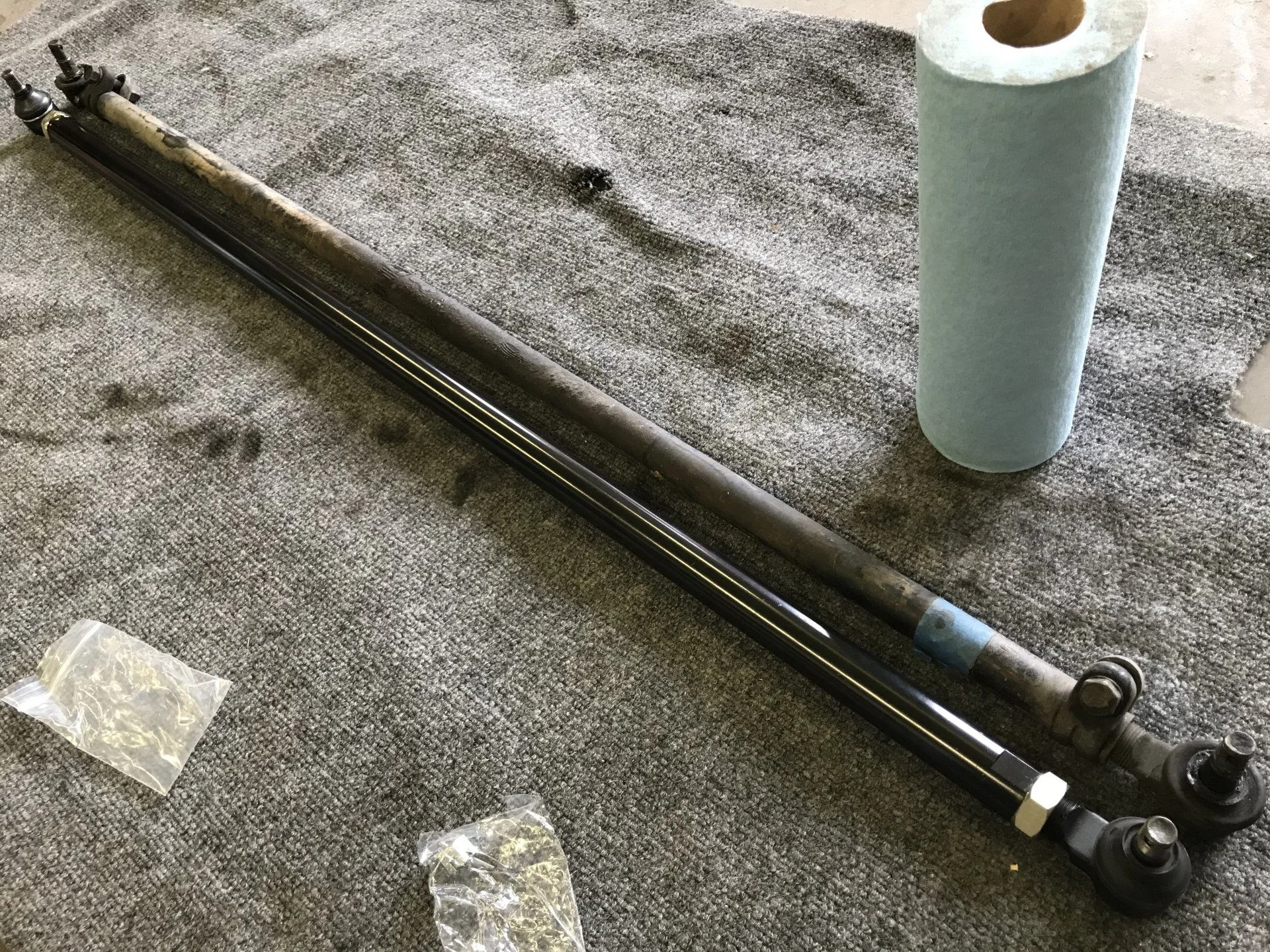

SLEE HD tie rod got a quick install.
