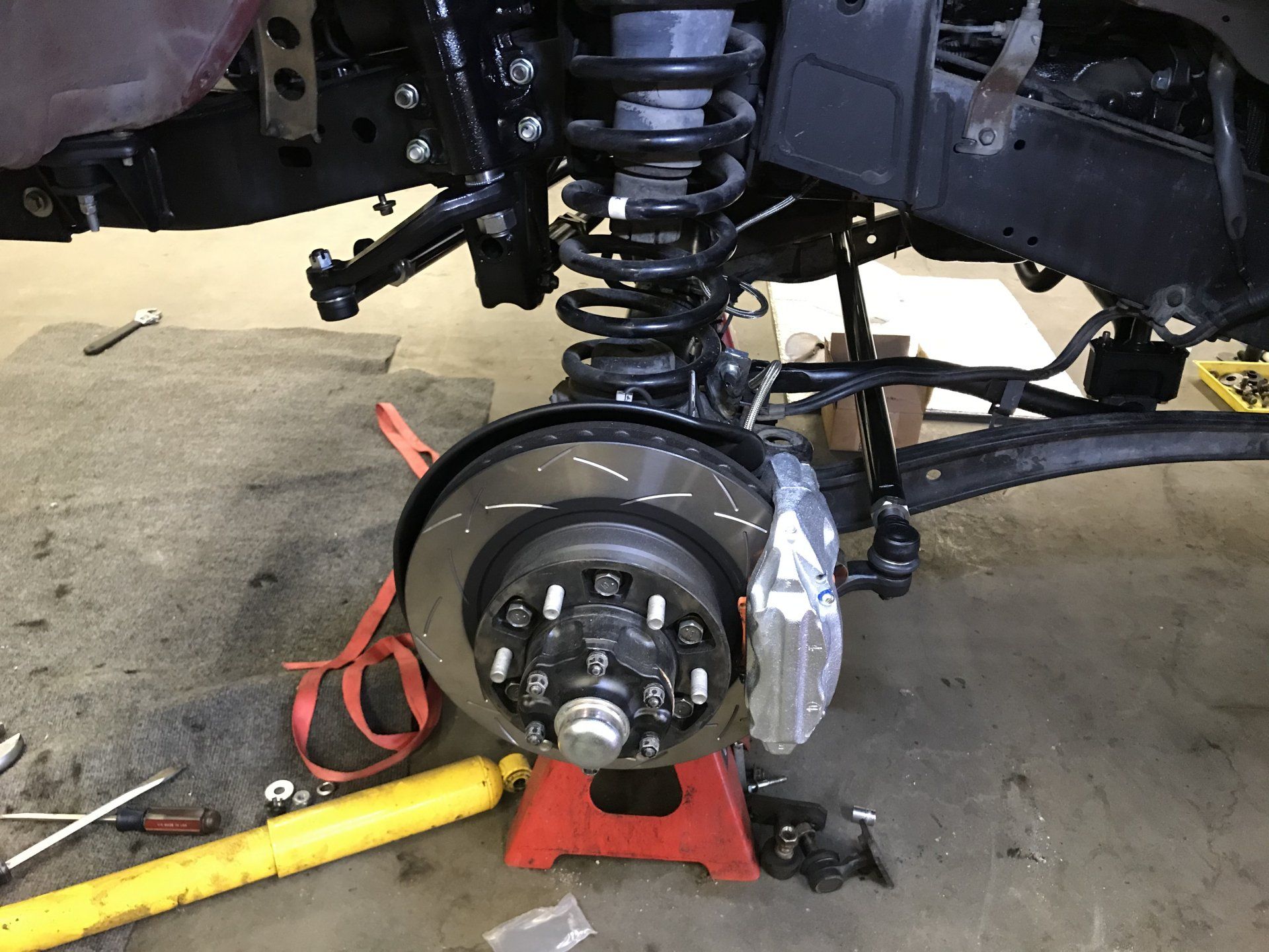

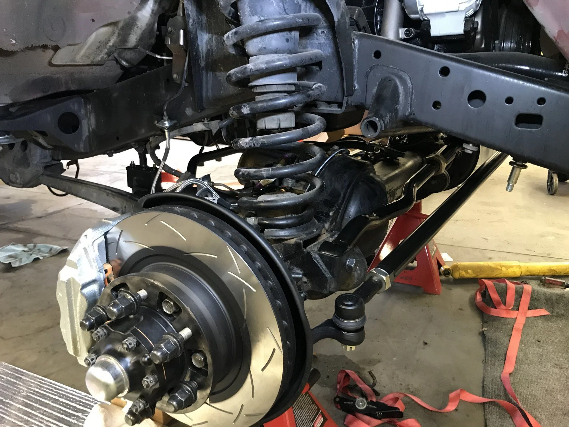

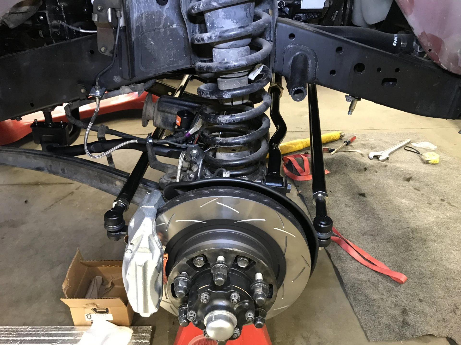

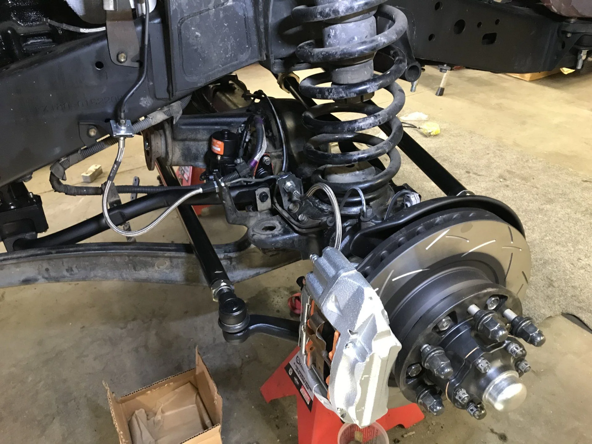

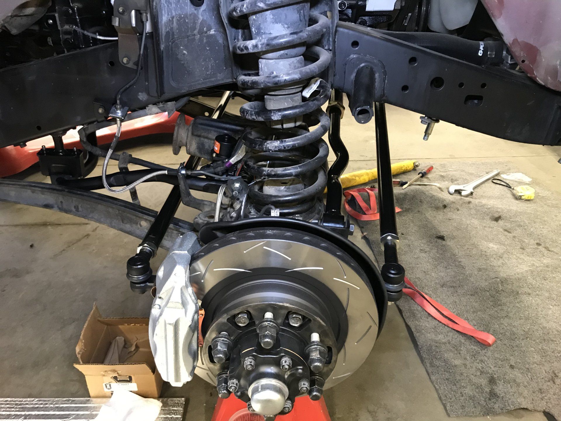

Be happier when there is some Kings in here but besides new bumps inside the coils and caster correction the front is all done.

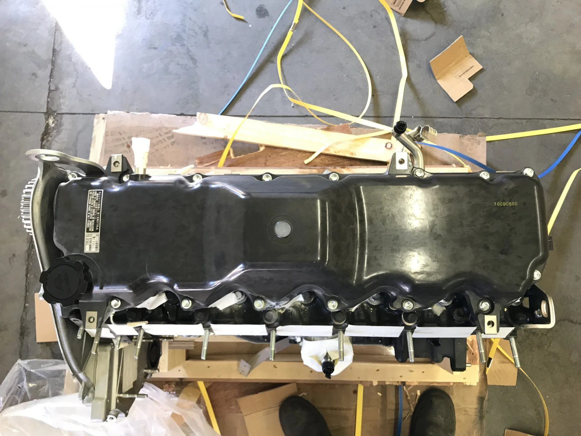

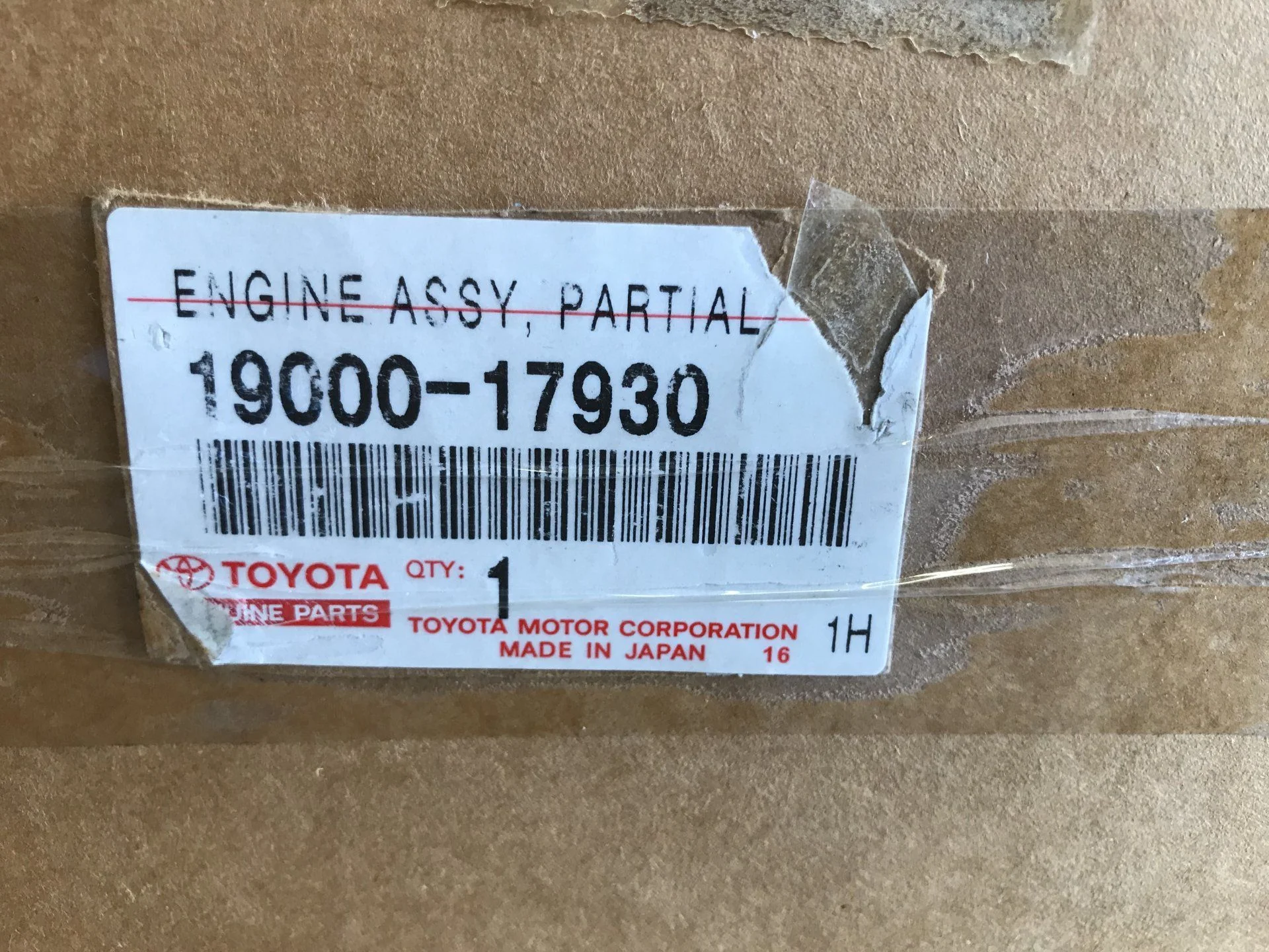

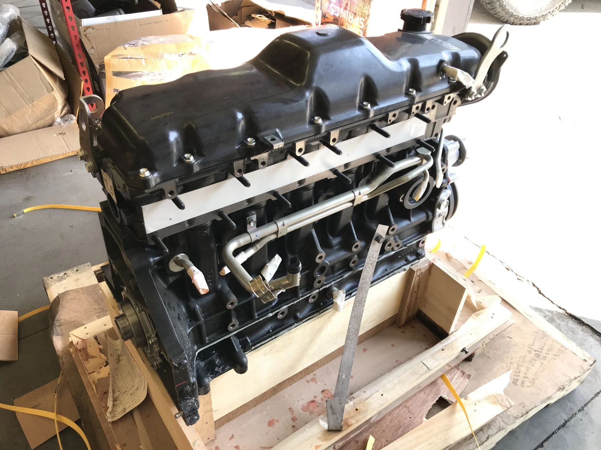

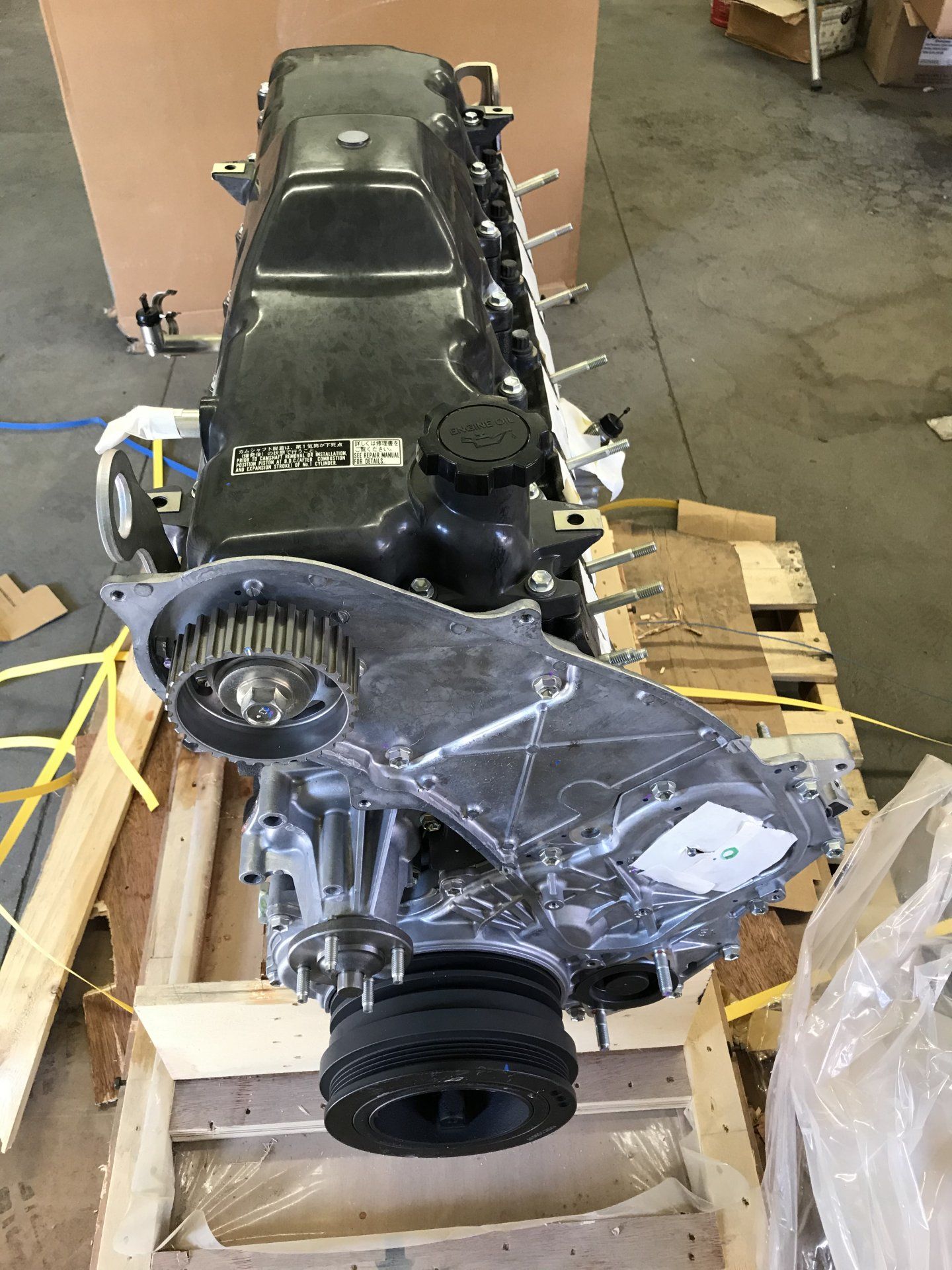

So this project has been going great. @SNLC has been crushing it and having his eyes on this truck has been really good. The project was coming full circle and really the only thing Ian had not touched was the engine. And that began to cause me a little concern. Ian did a remarkable job on the last truck he did for me and I felt like I owed it to this truck to have Ian more intimately involved with the engine.....I mean the engine swap is what started all of this and Ian has practically re-done everything on this truck but the engine.
A few months ago I got to chatting with Ian and @Onur about some long block HDFTE engines that were showing in stock in the Middle East. What if we just ordered one of those? Would it actually show up? I ended up passing on that project as @wngrog and I were buying 45’s at the time. A couple of weeks ago I started that convo again with Ian and ended up deciding to dive in. The engine showed up this afternoon in Idaho. A brand new 1HDFTE ”partial engine assembly.”
We still have a lot of OEM parts to acquire. Plus some Gturbo bits from the Aussies. Ian is already in communications re a new manual injector pump and matching Gturbo red wheel. This is pretty cool to see.
View attachment 2451451View attachment 2451452View attachment 2451453View attachment 2451454
bloody hell!
that is a sight to behold.
would the mechanical fuel pump be a FT pump? would this essentially make it a FT engine without fuel delivery being ECU controlled?
it does appear to be like christmas day every day in Ians shop..:)
bloody hell!
Yes I believe so Mike. Not hard to find the pump, hard to find manifolds and a few other FT bits now NLA.
Damn, this build just got real!
One thing you should keep in mind if you're planning on using the FT pump with this - the FTE injectors that came with this engine will not work correctly with the FT pump
Yea. I wish that was our only concern.
I was not even certain the engine would actually show up so we did not have a lot of things planned. It was more or less “we will think about it when it shows up.”
Now that it has arrived decisions have to be made. The problem with taking it to a mechanical injection system is that the long block is missing more than a few bits and pieces. Those bits and pieces are no longer available new and practically impossible without buying a complete FT engine. I was planning to actually do that last week but after talking to some mates in Oz it may be easier - and cheaper - to keep this thing FTE. Cheaper is all relative at this point though.
That's a fairly significant chunk of change to spend on something "just to see if it shows up". Lol
I was actually going to suggest going full FTE as well. People here tend to get hung up on mechanical injection, but the reality is that electronic injection is superior to mechanical on 1HD in just about every single way (Except ease of install). FTE pump is more robust, produces more power/torque across the entire RPM range, more efficient, parts are more abundant, etc. And installation isnt THAT difficult. Wiring for the FTE is relatively simple compared to something like 1VD, for example.
Going FTE would still require A LOT of parts though that will be difficult to source...
Honestly, I just assumed they were going to email me and say they did not really have the engine in stock and then refund my money. But after we paid the customs duty things got serious.
It appears I have sourced the FTE computer bits and wiring harness for a manual trans 70 series. Using a guy in Aus to build the wiring harness to work with the LHD 80 series. Had to find a manual transmission ECU because the A442 did not run behind the FTE.
These engines are just too reliable, the 24v heads, and to find one complete that will never run again is just like searching for rocking horse crap. I only ever knew of one seized FTE, that was due to debris putting a hole in the sump. What ever happens, it will be a terrific build with the quality of work these fellas continue to produce🍻
@jmlockwood needs to change the build title.
I literally just logged on to provide the update.
So it’s official we are going to keep this engine and FTE and maintain the electrical design. I have sourced a 79 series computer setup from a manual transmission truck. Because the A442 was never installed behind the FTE, there is really no computer setup available. I was recommended to someone in Australia who will modify the 79 series harness to plug up to this 80 series and to accommodate LHD. @SNLC is working with Gturbo to obtain the injectors, injector pump and turbo. @Onur has now begun sourcing the new FTE bits and pieces necessary to package this thing up into a running engine.
