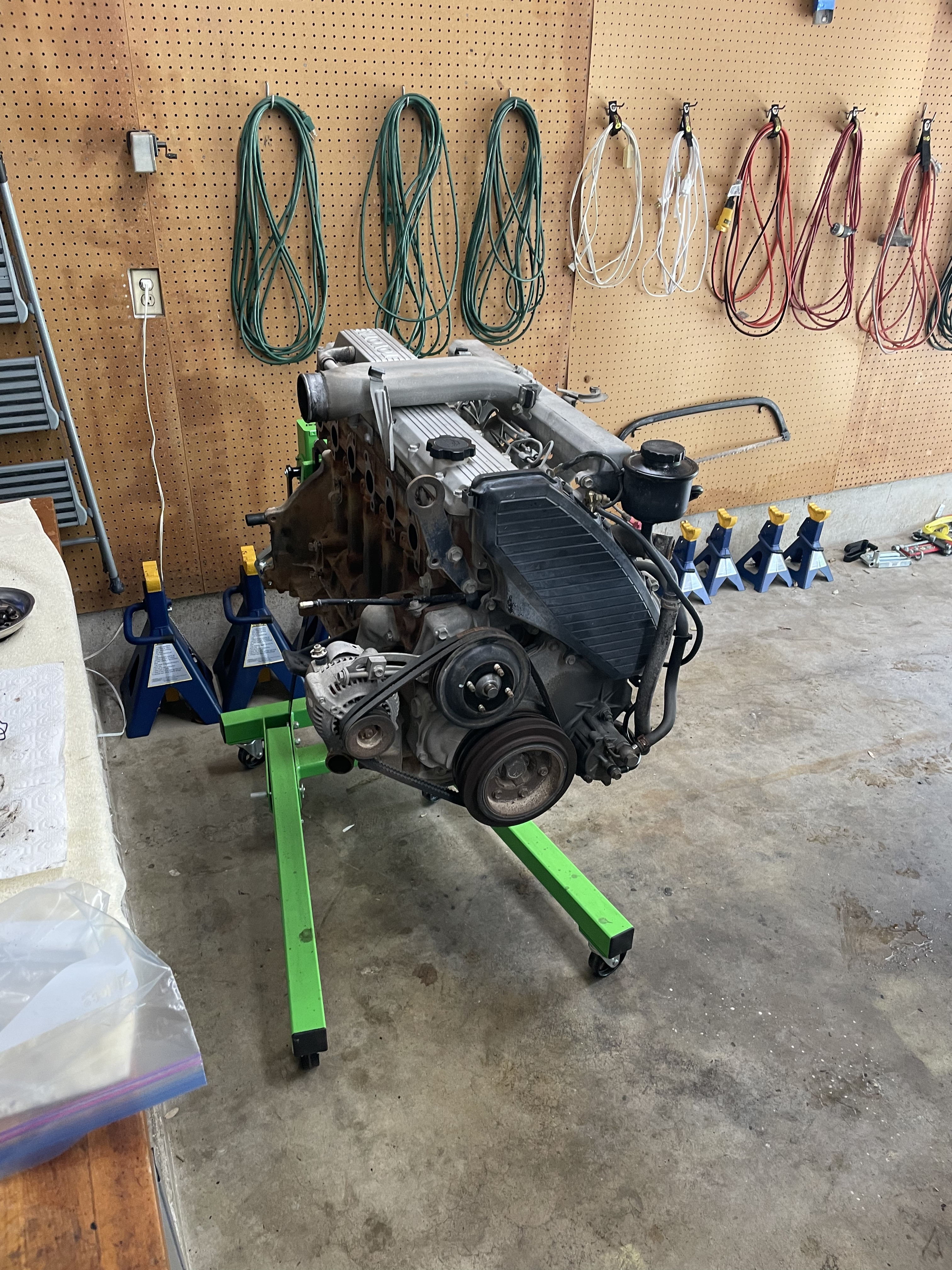

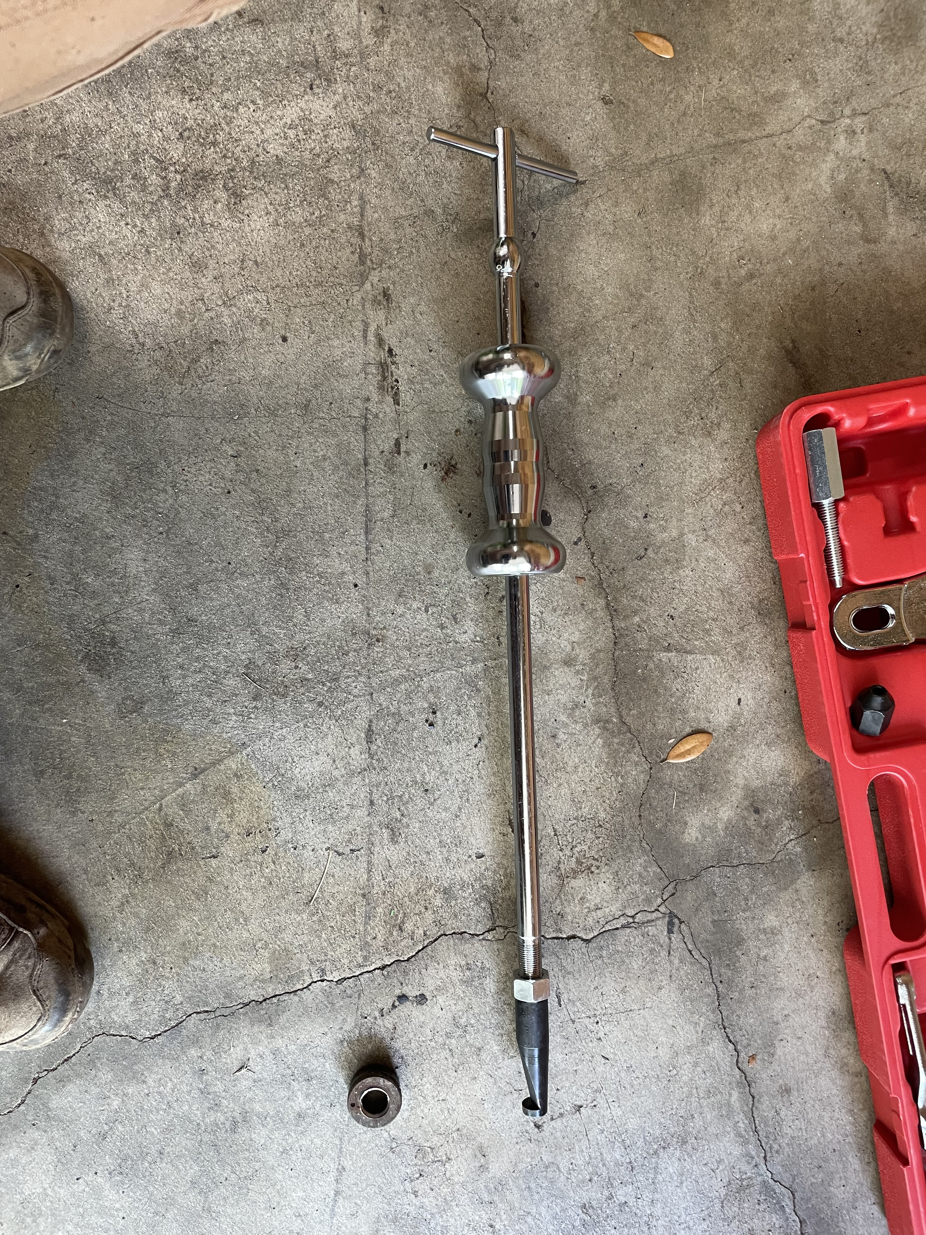

I was able to get the engine on the stand today.
I’m still struggling with removing the water by-pass pipe. I’ll try collapsing it on itself with a chisel and BFH next time.
He's showing off his collection of jack stands.;)
Also, I now have your amazingly well organized extension cords burned into my memory and it will appear each time I untangle mine!
Will , your hanging cords are disgraceful , not even on level , what a shame .:bang:
without mentioning the pencil sharpener , too high for my standards .....;)

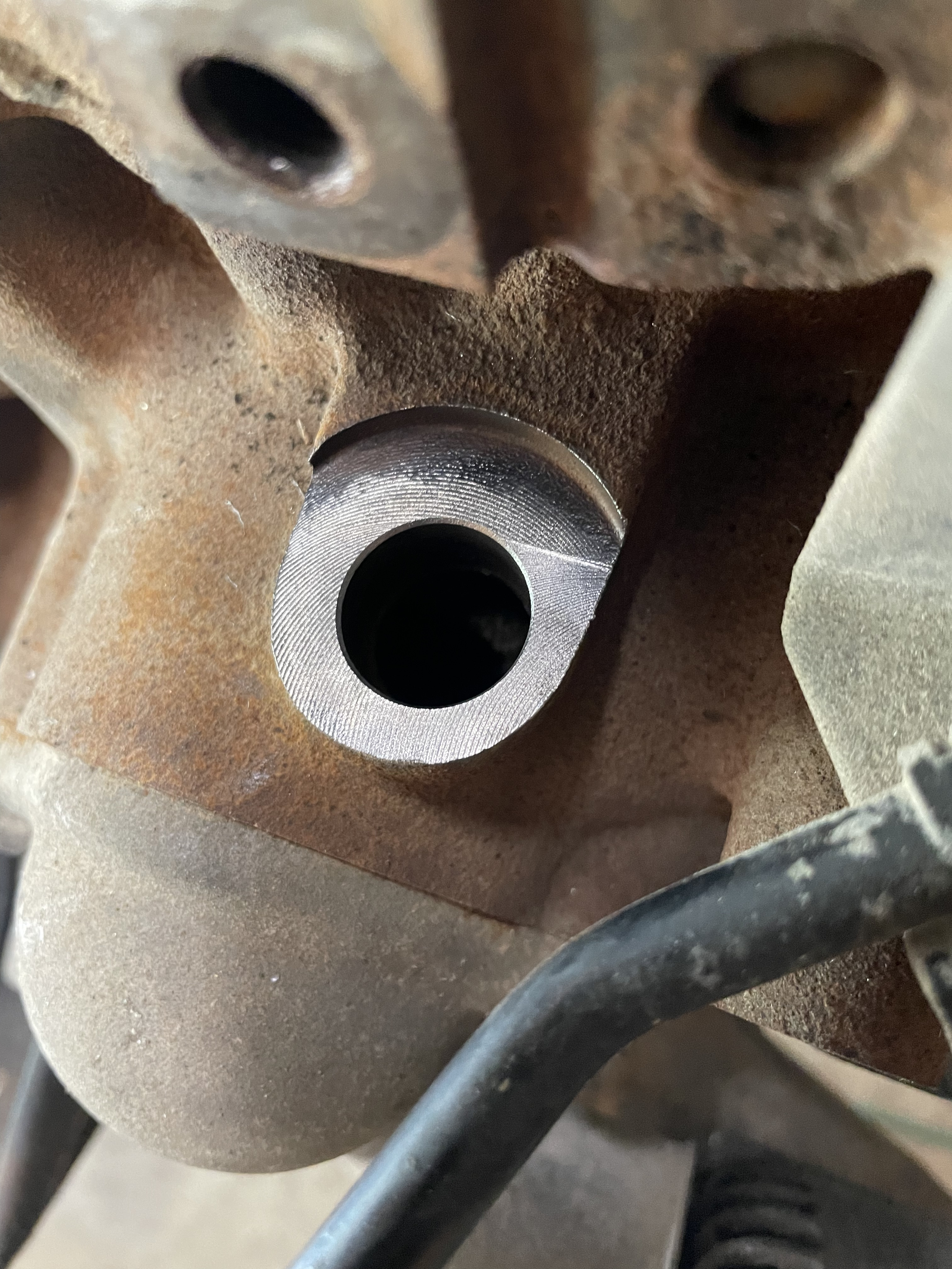

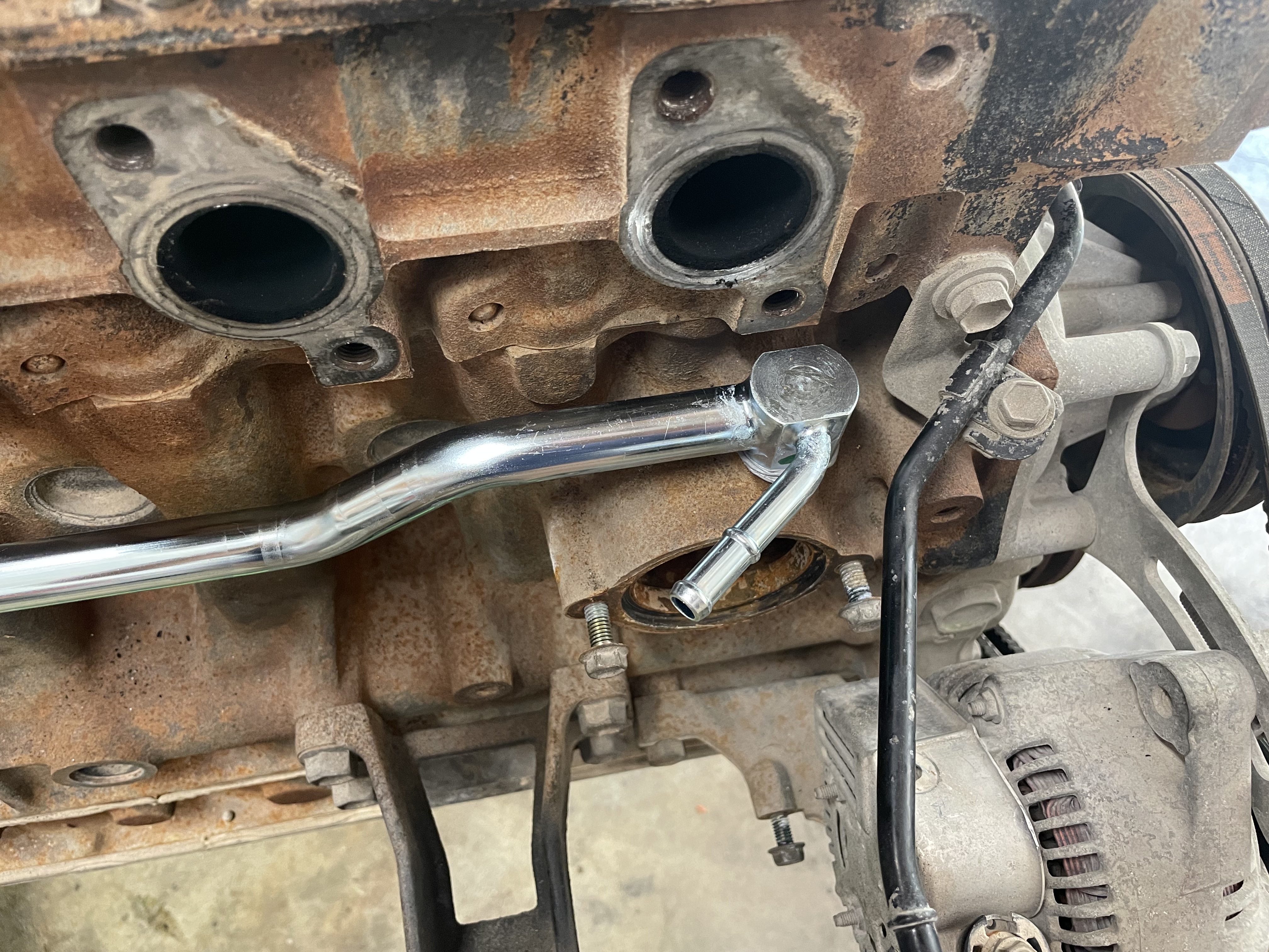

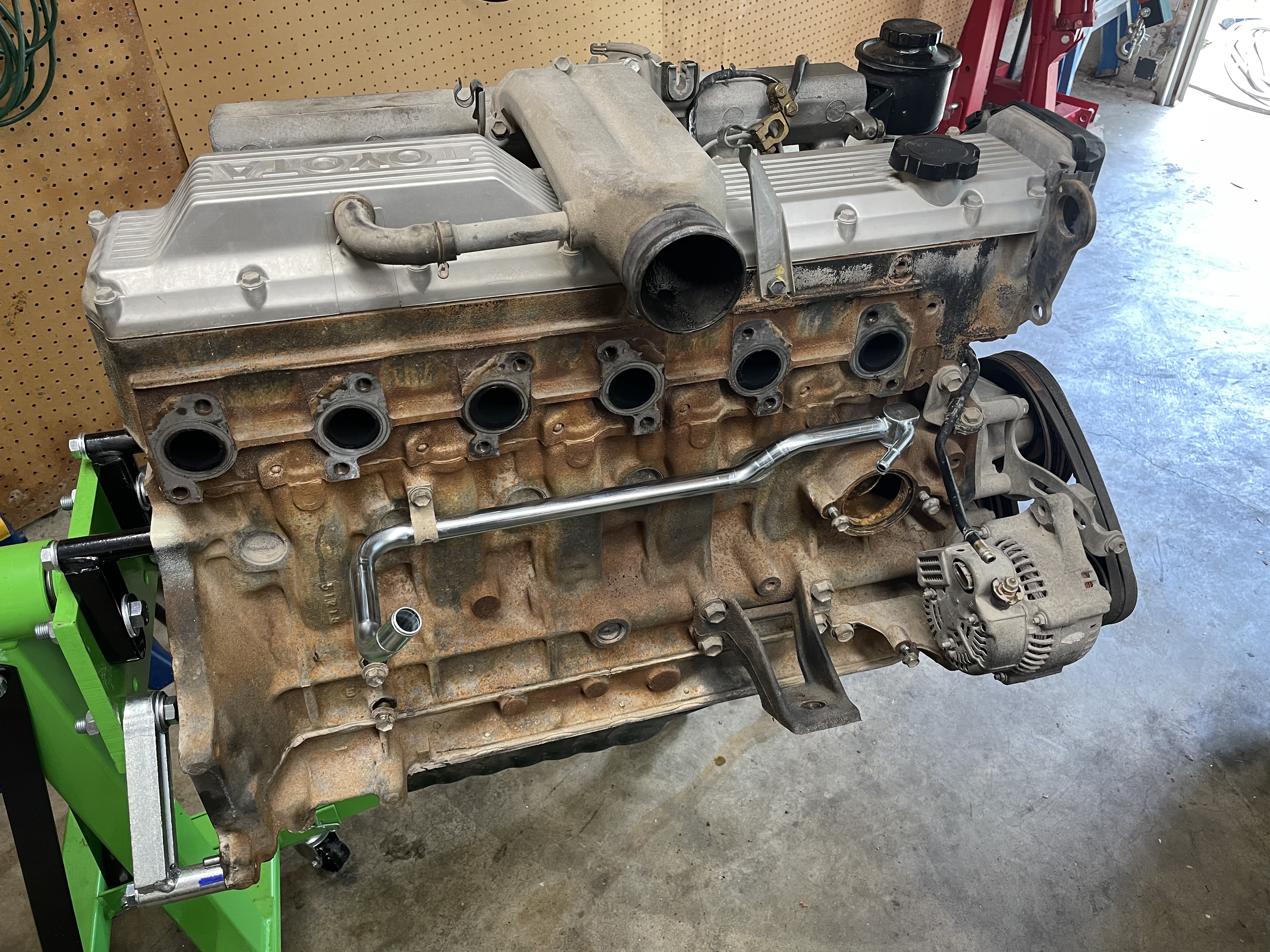

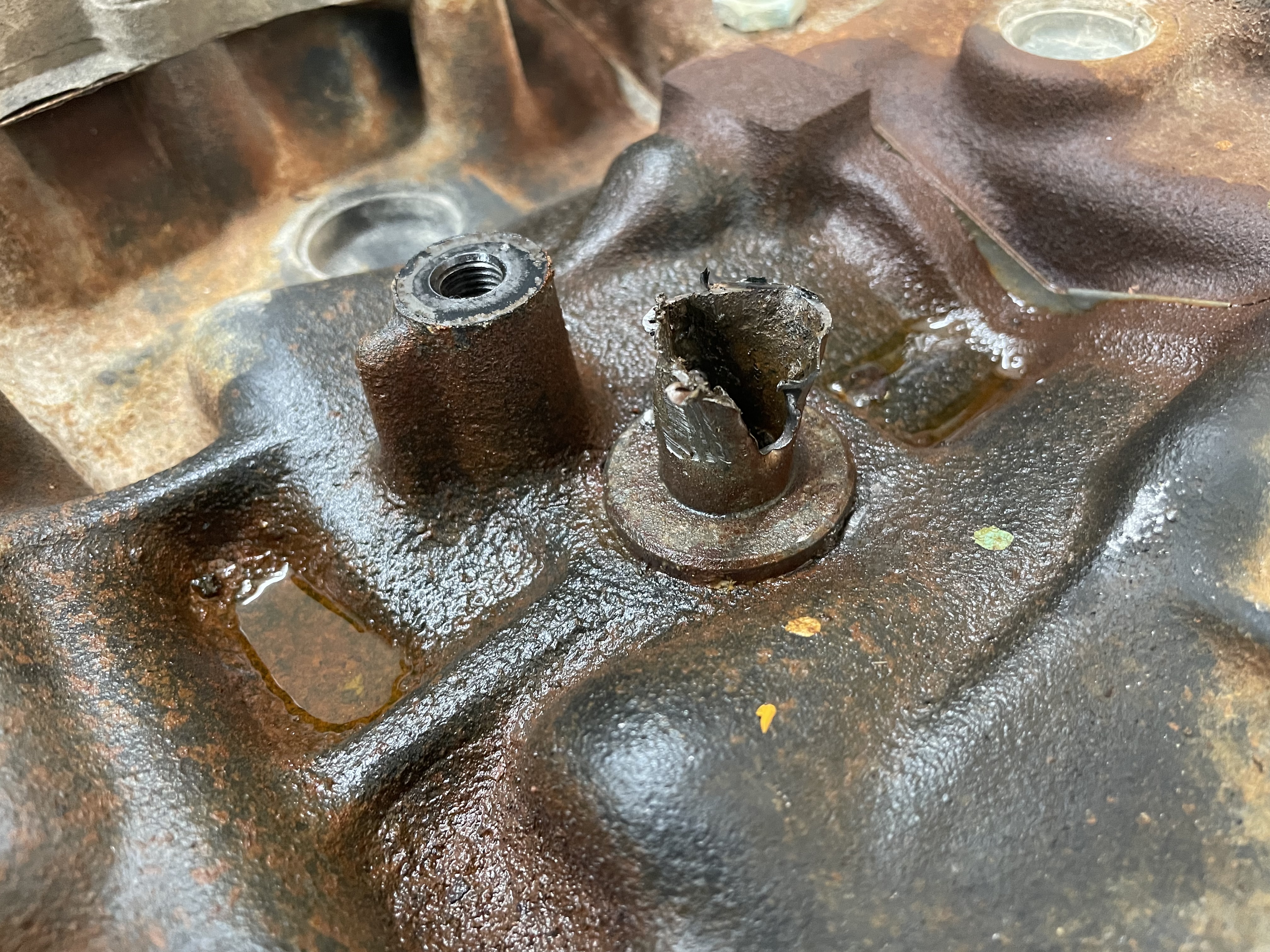

Nice work! Did you get any guidance on install of new? Light clean of the block side with 800 grit, and rubber mallet to install? I have no idea.
The flange surfaces were surprising clean. Still, I prepped it with a Scotch-Brite pad and a small wire brush on a Dremel. Then used a very light coat of Permatex coolant-safe gasket maker applied to both the pipe flange and the block flange. I set it in place with a brass drift because there is not enough room to hit it directly with a hammer. Just tap lightly and work your way around the circumference of the flange. Voilà!

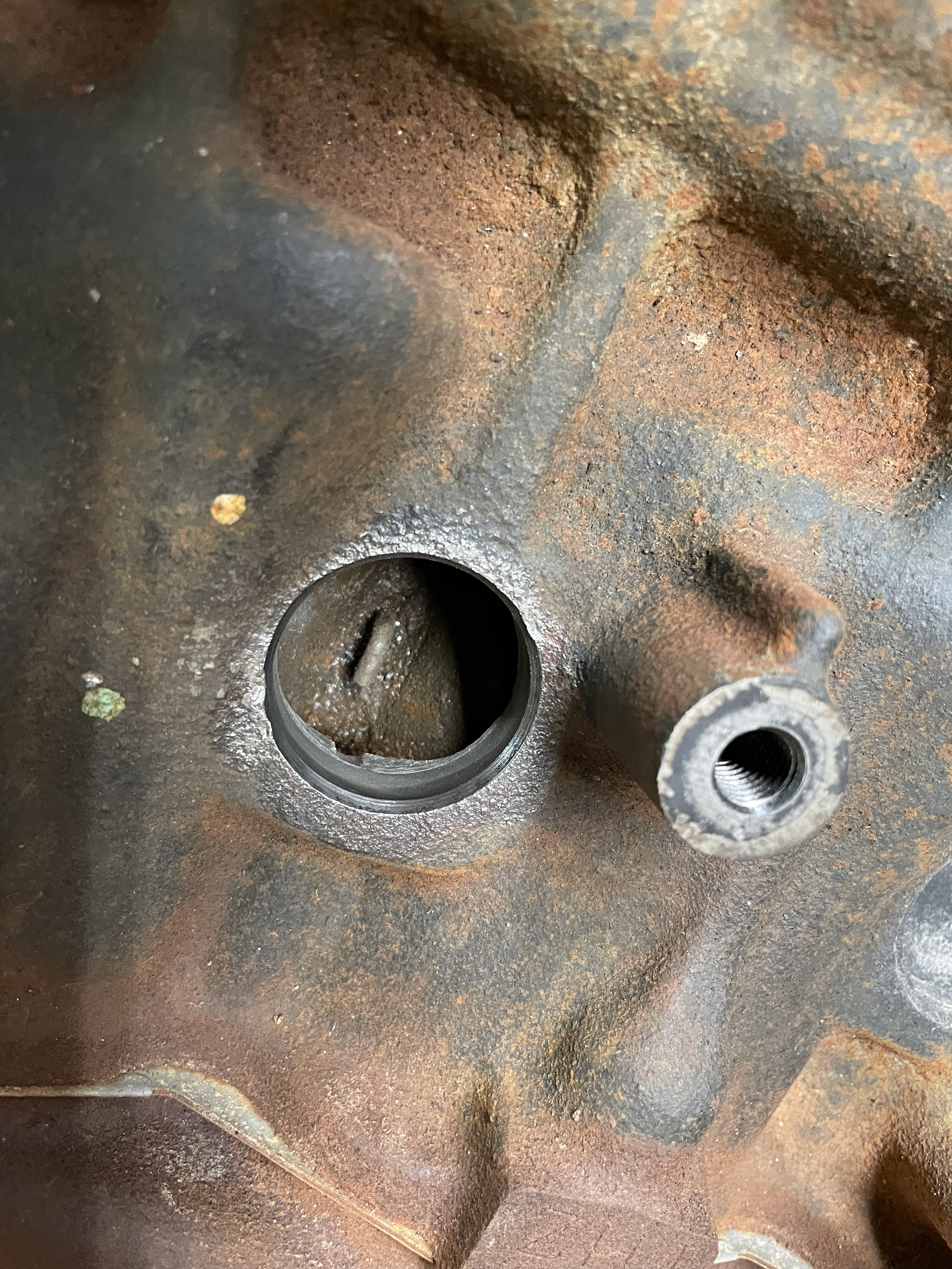

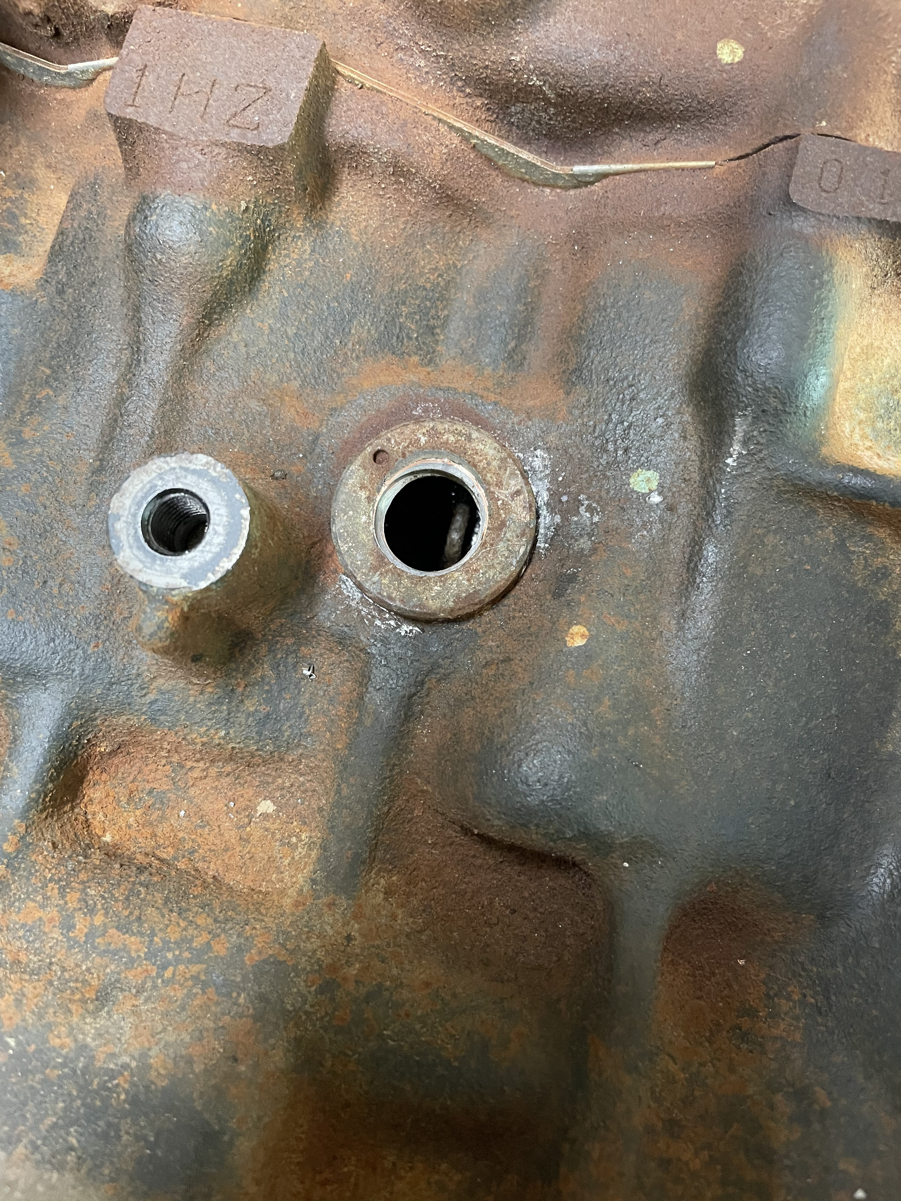

Got the other side done.
The savvy Toyota enthusiast will notice an anomaly in these photos. Can anybody guess what it is? Or more precisely, what it means?
Bingo! Too easy.
