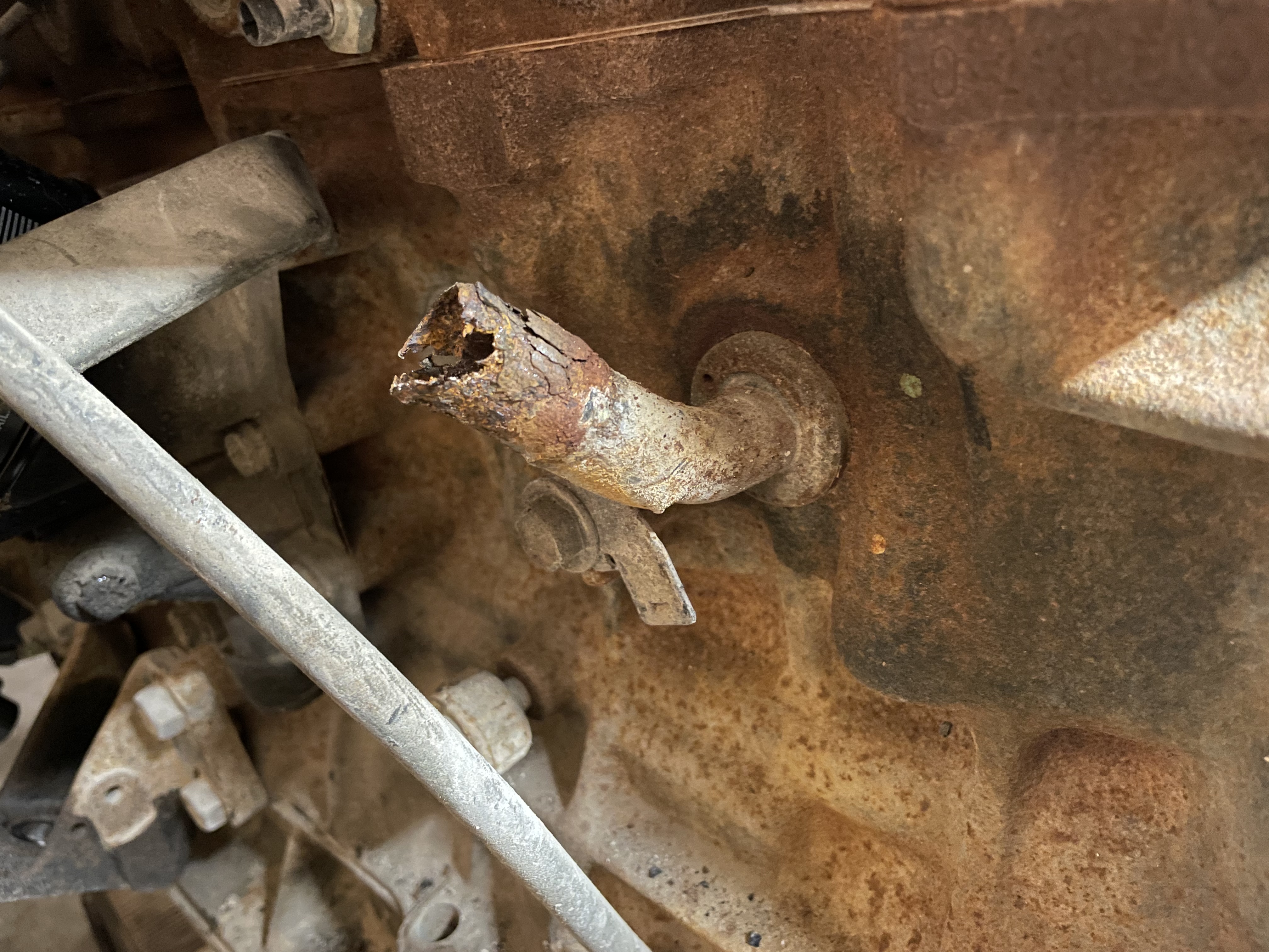

I tried to wire brush the heater core water inlet (driver’s side) this afternoon and the bead-rolled edge of the fitting disintegrated on the first pass - totally corroded from tap water. I tried to pull the fitting from the block with the engine in place, but completely mangled it.
Space is really tight in that area, so I decided to just go ahead and pull the engine and work on it on a stand. There are a variety of other things I want to do with the engine out anyway, so this just pushed me to go ahead and pull it.

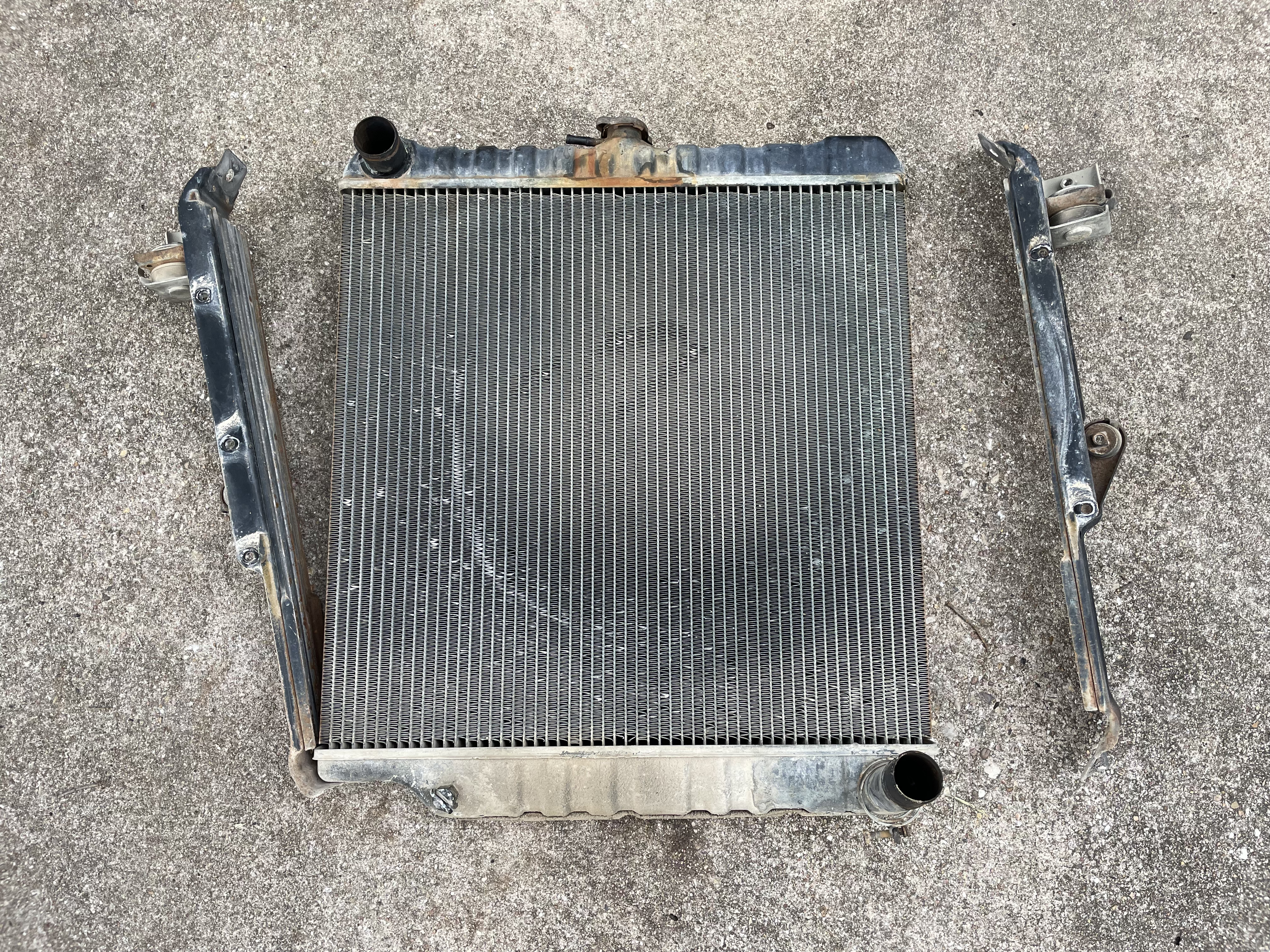

@Onur - Didn’t you say the radiator was toast? You were correct. It nearly came completely apart while pulling it.

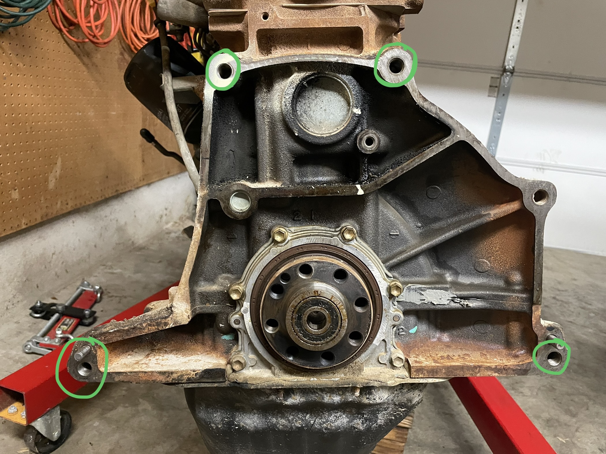

However, the spread on the arms on my engine stand isn’t long enough. I need the top arms to be longer.
I need some longer replacement engine stand fingers.
Wait: what’s wrong with the engine??
The H2O heater inlet on the block was toast. I needed room to access and replace it.
