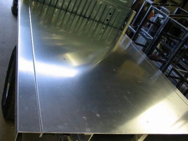

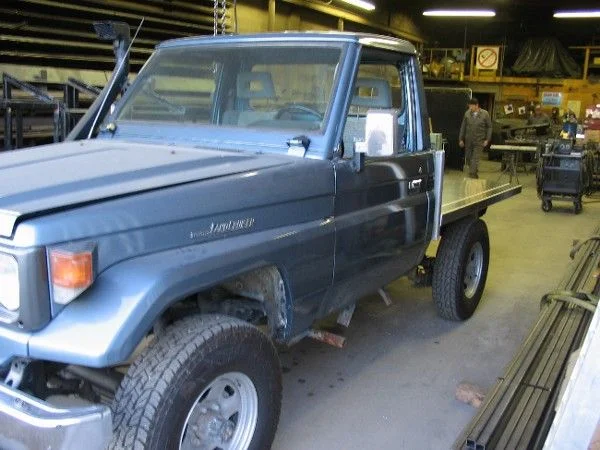

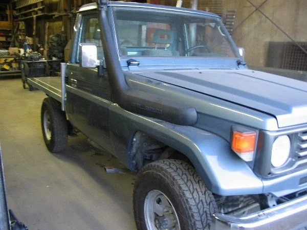

pics from 7 am this morning:
note the 2 full length boxe recievers.
the signals are being workered into the corners with an aluminum guard plate behind to prevent rock damage.
the box front and sides will be the same height as the front pillars.
the cage and canvas cover will be ounted to the top of the fold down sides. just remove the top and aluminum cage, drop and slide out the sides and you are back to a flat deck. this will make for a very versitile trayback, don't you agree?
the whole assemlbe can be raised with blocks at the 8 mounting points to what ever height is needed to clear the tires should i want to go bigger tires...
the deck is bolted so as to eliminate the warping that comes with welding aluminum but the stress points will be welded for strength.
i decided i wanted to stay the same width as the body for visibility.
he is to have the basic deck done today and then the truck will go back in for the sides and drop gate and cage assembly.
