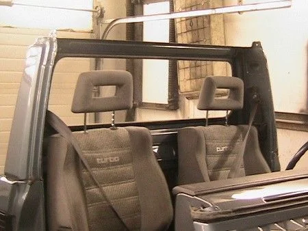

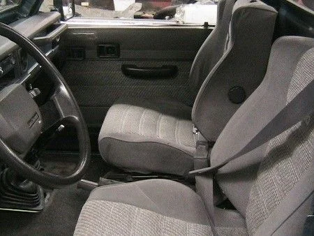

the windsheild frame is installed with a new ENS glass...
the "new" interior is looking more complete...

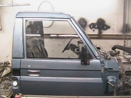

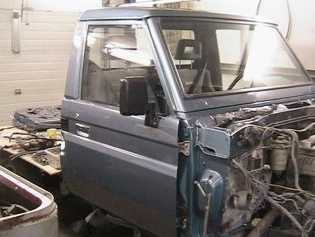

the roof and door installed...
the power mirrors and door locks and windows caused a bit of a head ache as the holes going into the cab are not drilled. the wiring in the 95 does not match the 89 so i had to change the wiring conectors as well.
i am not sure if i am going with the chrome mirrors and running boards and front bumper or the black look...
at least it is starting to look like something again.

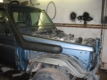

on a 40 series you put the lower fender on first but on the 70 series it is a 3 piece fender. you have to install the lower skirt under the rad support first and just the front bolt. thenyou install the upper part. fit it front and rear. this is the easiest part of the process. the middle (called lower fender) goes on next and you need to be very flexable as well as having small hands, neither of which i have. once you have the bolts started from the middle to the top then insert the grubber gasket before tightening the bolts down. BTW, having the headlights out make getting a couple of the bolts much easier. last you bolt the skirt up to BOTH the top and middle fender.
i installed the snorkel while i had ease of access and this worked very well.
the front section is easy and self explanatory.
once the headlights were reinstalled i was able to install the new grill. i am hopeing i can get the hood installed yet today but if the phone doesn't stop ringing i will be out of luck.
let me know what you think.
