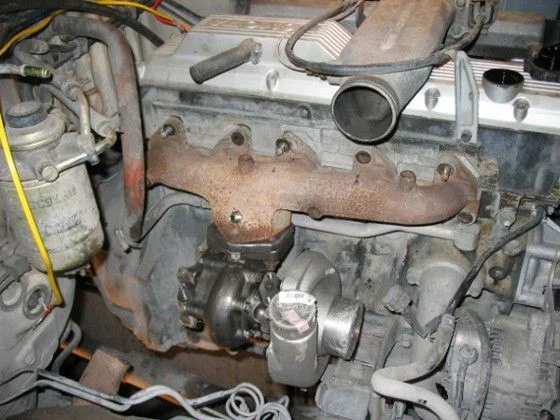

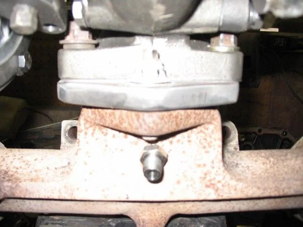

some pics of the adapter plate installed.
note how the back 2 bolts goes through the plate and into the stock maifold.

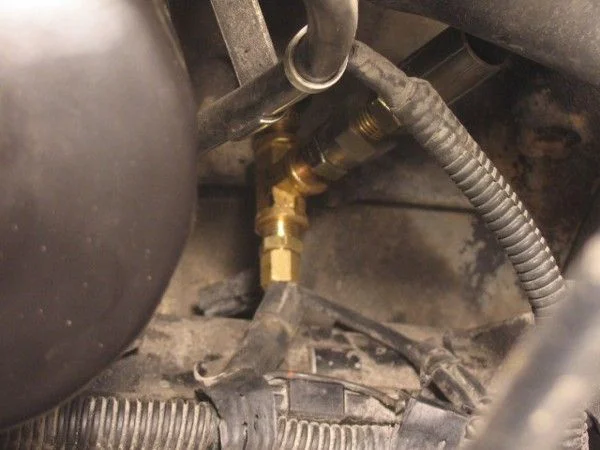

the turbo oil feed line and mechanical oil pressure gauge feed replacing the stock sender. i did this more since the factory dash has no oil pressure gauge at all just a idiot light.

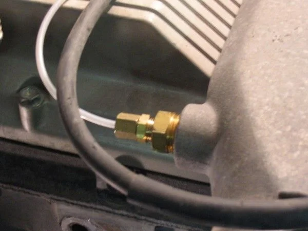

the stock intake cross over pipe has a tapped reciever for the boost pressure gauge.
i also insterted the tiney plastic line for the oil pressure gauge in a large rubber since it is installed low and close to items that could rub the line.

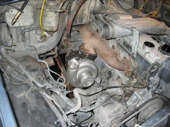

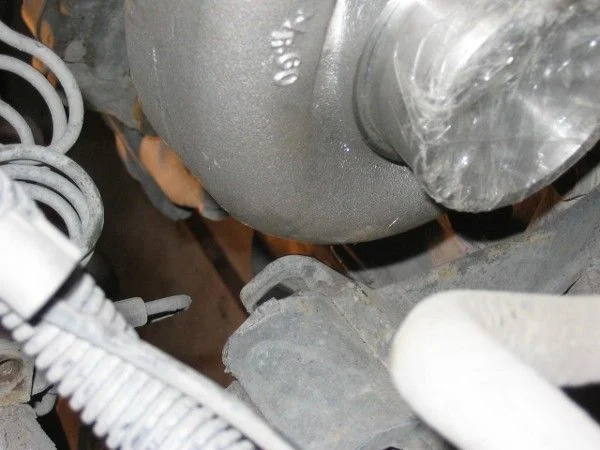

the turbo fits nicely in the opening. although it apears to be a tight fit there is about 3/4" clearence from the engine mount. it is hard to take the proper pic of the gap but there is plenty.

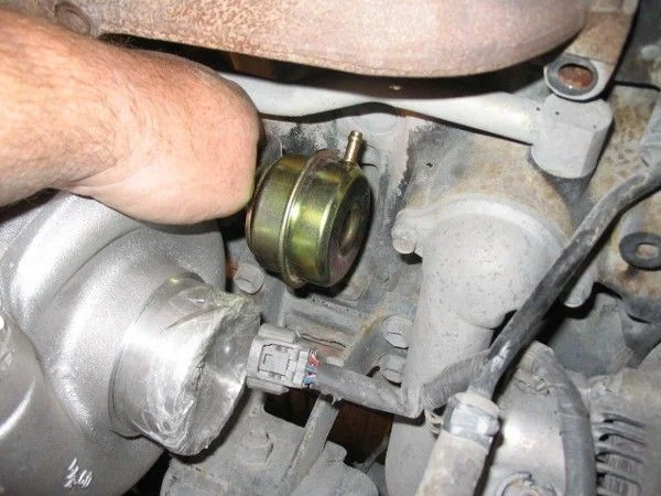

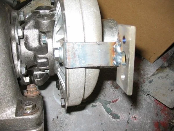

the dash pot for the waste gate needs to be relocated back from the turbo so a custom linkage will need to be made as well as a different mounting.

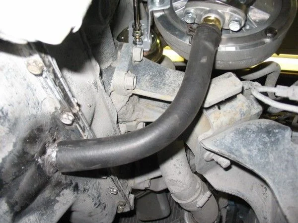

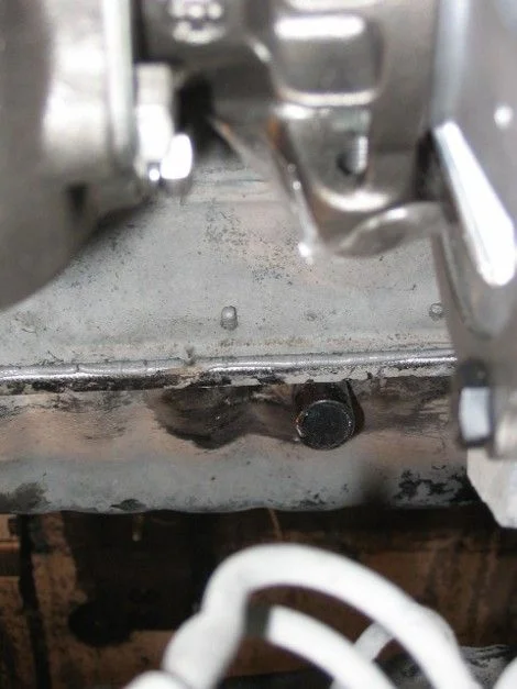

the bung for the oil return line is welded in place.

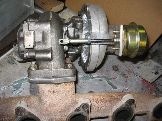

the adapter before clean up. this moves the dash pot back into the opening in the block, i will need to lengthen the control rod next...
the waste gate is now installed and the turbo is mounted...
the waste gate fits into the block recess excellent and right above the engine mount...
i was able to get the gauges hooked up and installed. complete PITA when you find a knik in the oil feed line and have to rerun a new line.
the pyro, oil feed and return line are installed on the turbo. as you can see the "T" in the boost line to go to the gauge as well as the boost control.
