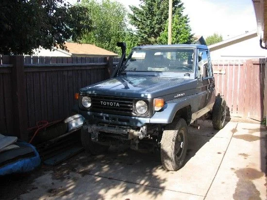

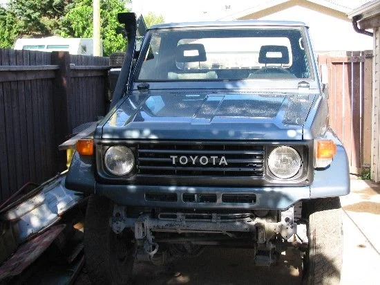

for those of you that wanted outdoor shots, a couple quickies...
before and after (so far)
thanks Stoney for the compliment...
Thaks Greg,
once i get the front bumper on, the new rims and tires installed and the trayback on then i am hoping it will be one of the nicer rigs i have built...
i posted this for a couple reasons,
one was to show the work that i can do.
another was to show that the cost to redo a truck even when wheeling and dealing can cost a small fortune.
also that there is a difference to going over a truck and actually getting right into it and where the price for such work is arrived from.
before it is done the front and rear diffs will be rebuilt, the tcase will be rebuilt and the tranny will be swapped out with a new clutch installed.
it isn't a "frame off" restoration but a refurbishing and updating.
cheers guys and thanks for following along.
