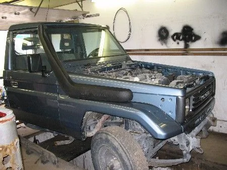

looking more like a truck all the time...
Wayne,
That is too funny I have recently learned the same thing about the fenders as I am taking blacky apart. All I can say is with all the hardware on those fenders it would take a series accident to ripe one off the truck :)

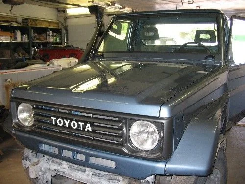

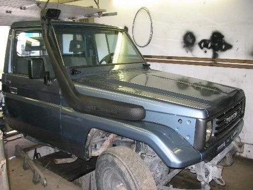

this is it for tonight.
i was able to get my painter to help stick the hood on. final adjustments tomorrow, finish under the hood, paint the rear frame some more adjustments and then it is on to the tray back...
cheers and thanks for all the compliments...
<i really think i will go with the chrome, i agree normally chrome wouldn't be a big deal but with this colour i think it will be just enough of a touch to really set it off...>
