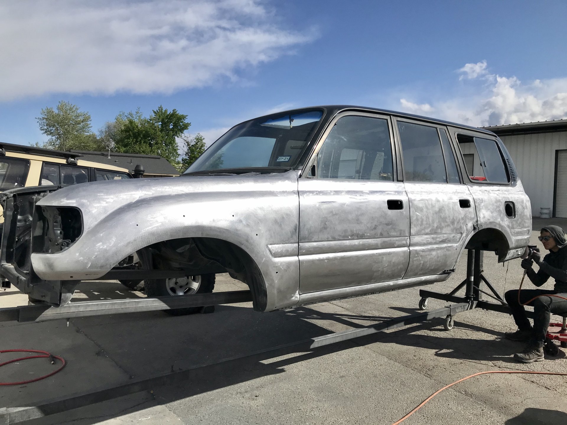

Soon, we left it in as long as possible because we only have four bays. That generally means we got to cycle Cruisers around but now that it is bare metal, it won’t be outside unless we are working on it.
He is where we finished today.
Cheers
So now that we have been stripping the Cruiser for a few days we have a better feel for condition of the body. We knew there were a few spots of rust but with the crappy repaint I was expecting some bondo. There is none. Not only that I was expecting some soccer mom body rash, aka parking lot dings from shopping carts, pillars at the gas stations and so forth. There really is none of that either. Other than a couple really small rust spots this body is in really nice condition and has never been in an accident.
Body sides are done from the windows down so we started in on the roof.
There was a couple tiny rust spots here but they sanded right out.
Both top corners of the windshield frame have a rust spot. I think we will just cut these out and patch because the corrosion is a little deep. Otherwise windshield frame is stellar.
A couple more progress pics.
Cheers

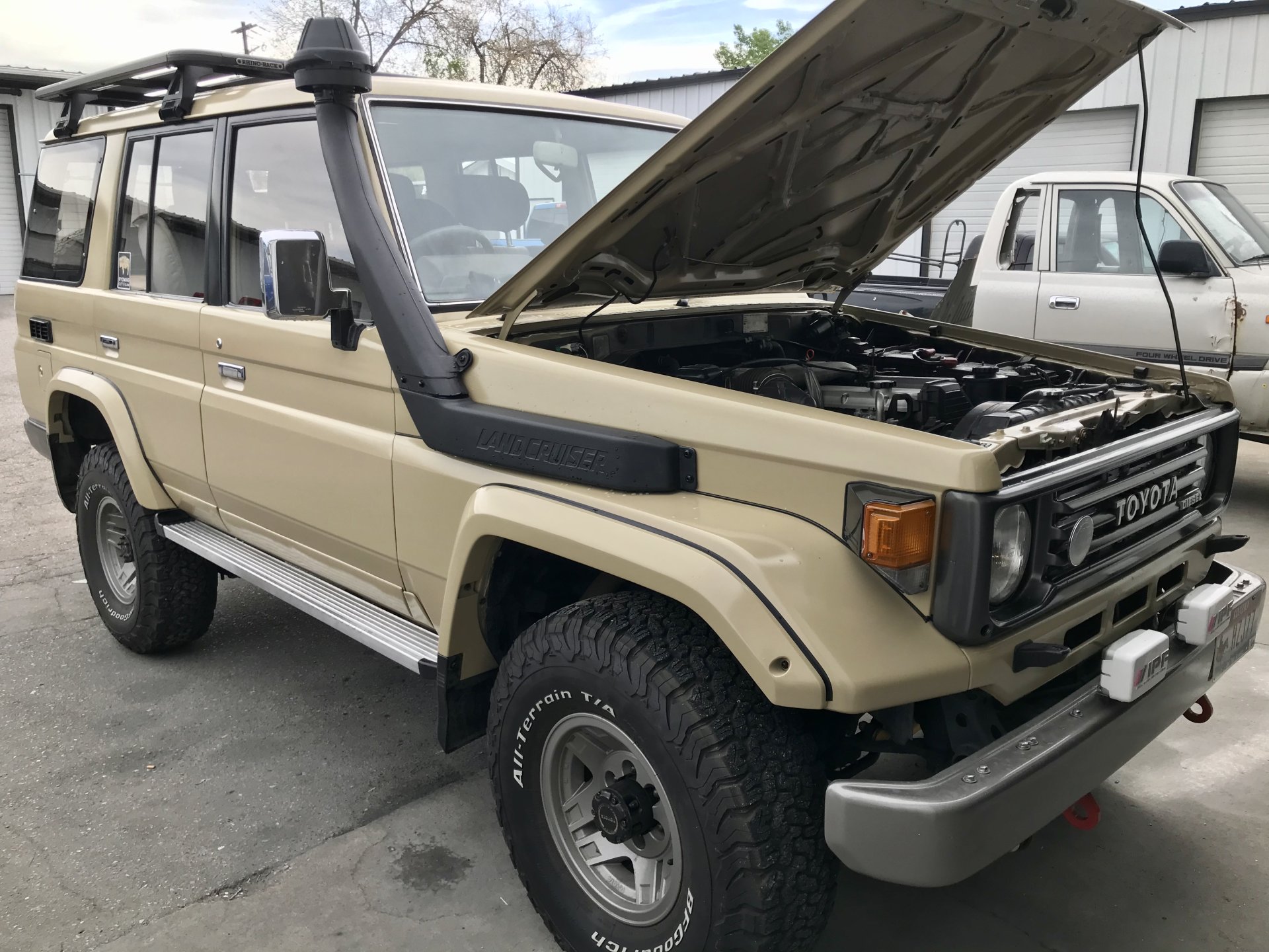

The last few days we had to finish up this 77-series.
