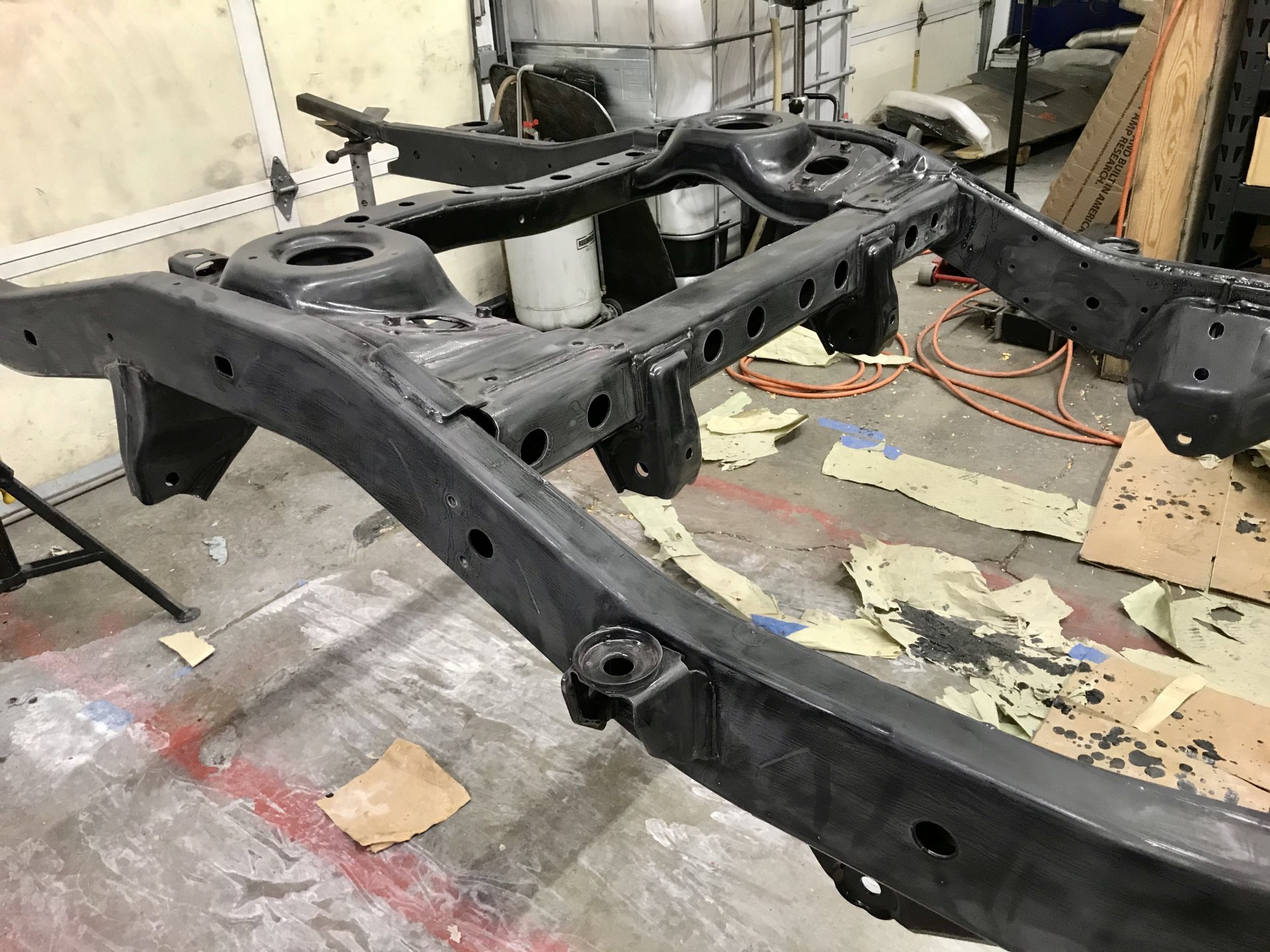

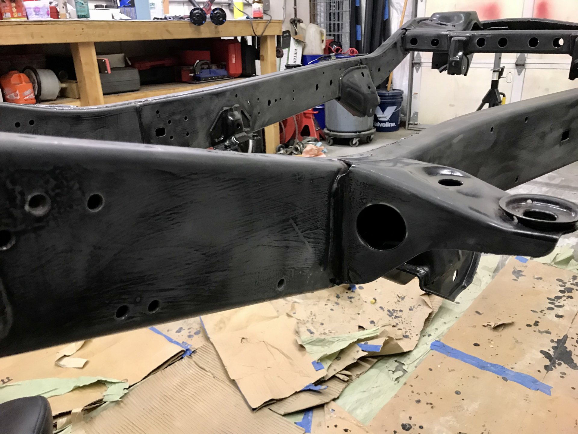

So now that the POR15 is cured we are sanding/scuffing it. We use 400g on the DA sander where we can and red scotch bright pads for the rest.

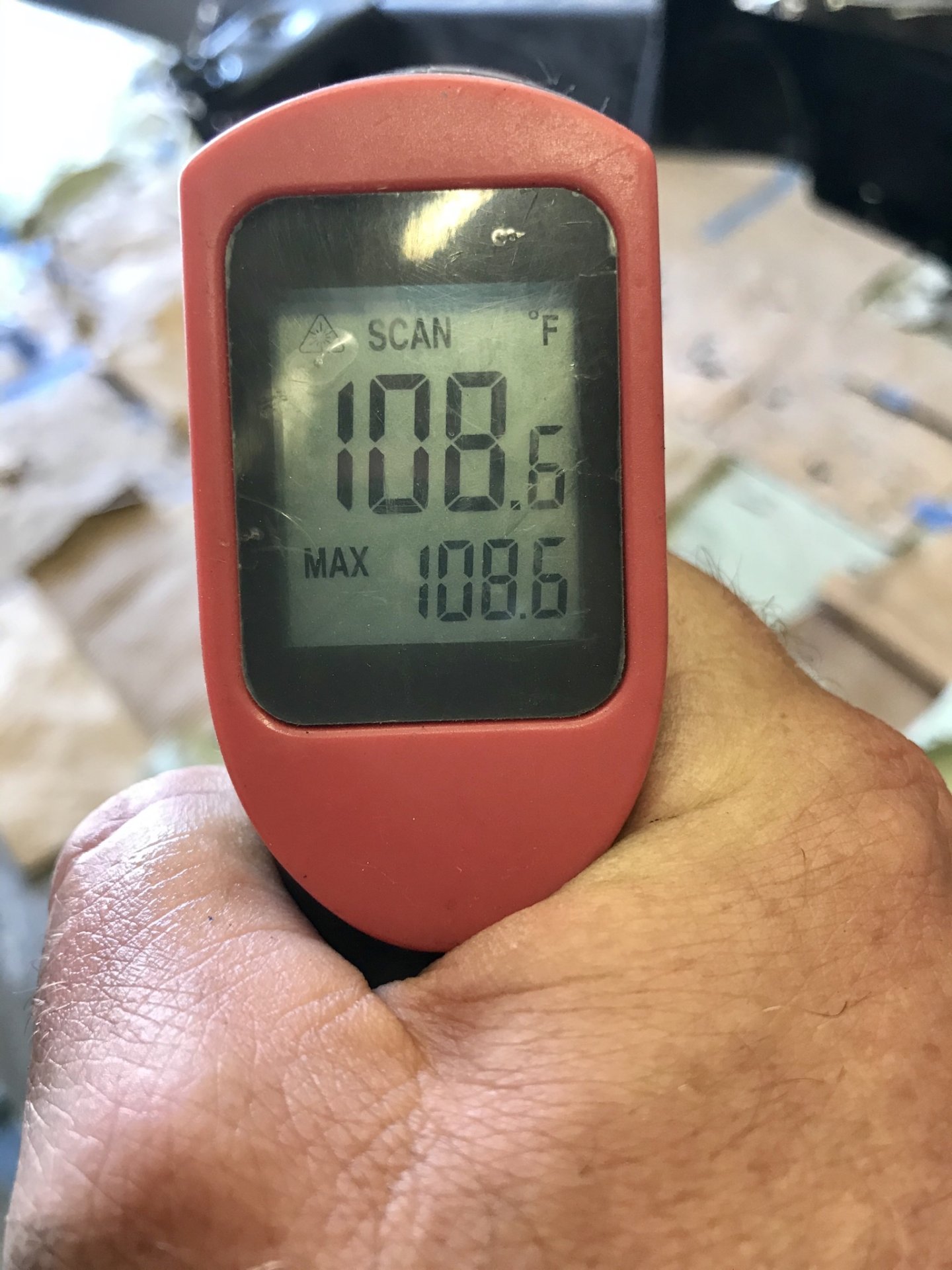

Just a wee bit hot in the shop today! 🥵

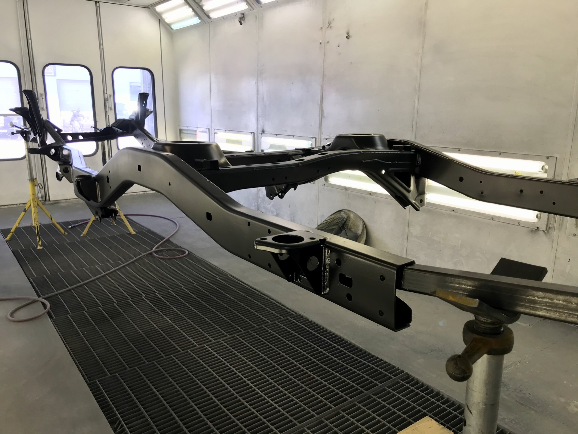

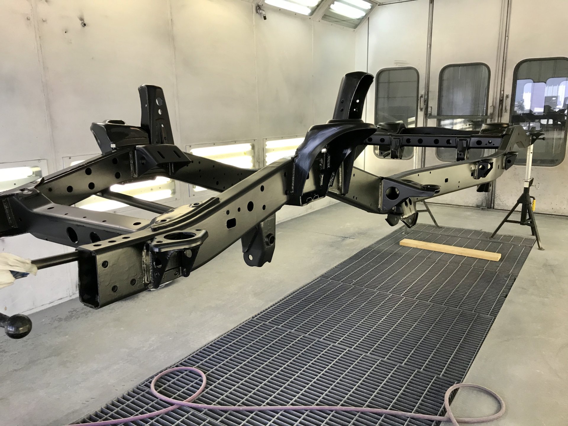

First coat of top coat is down on the frame.
Here is the paint we are using for top coat.
Cheers

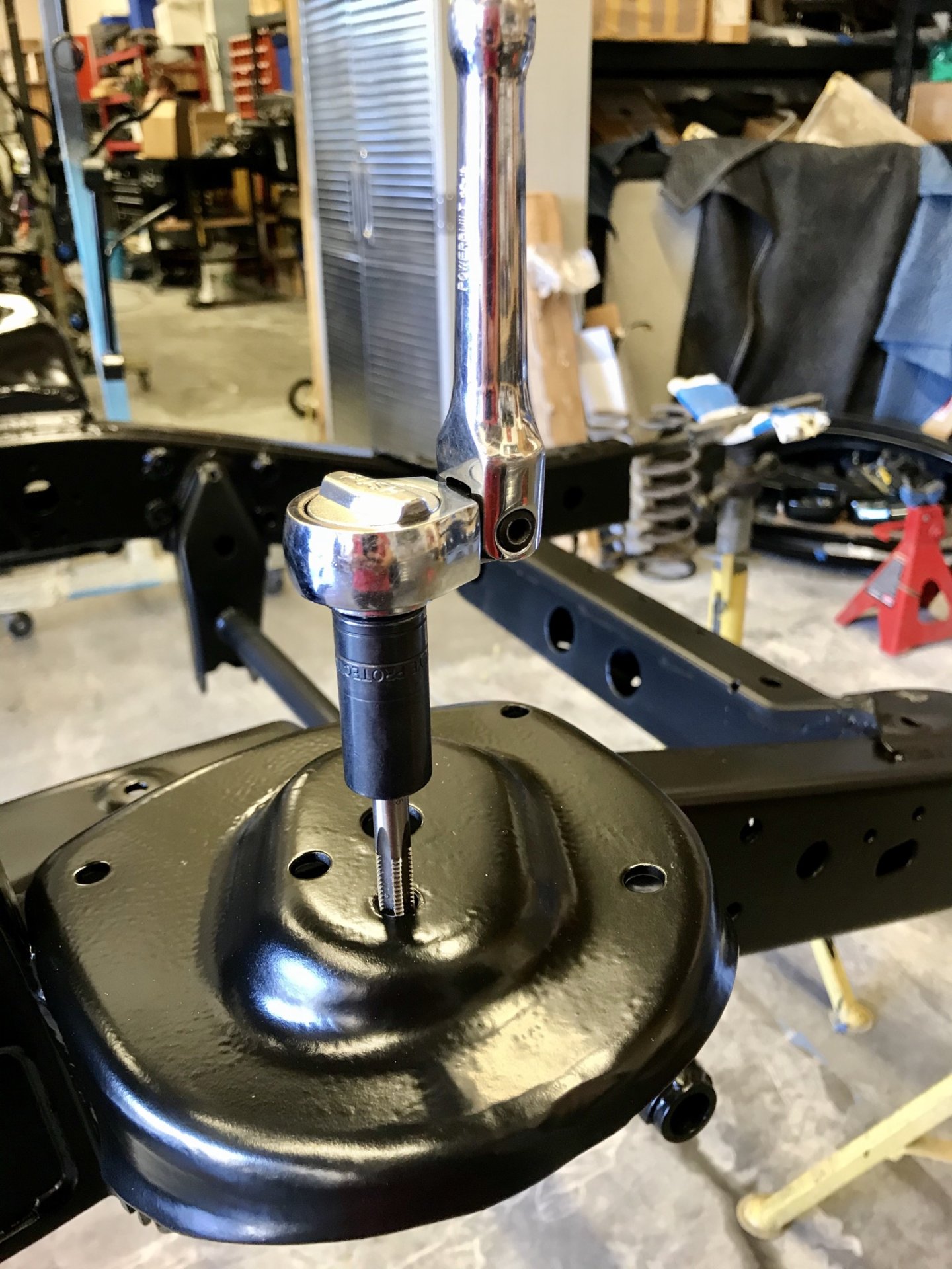

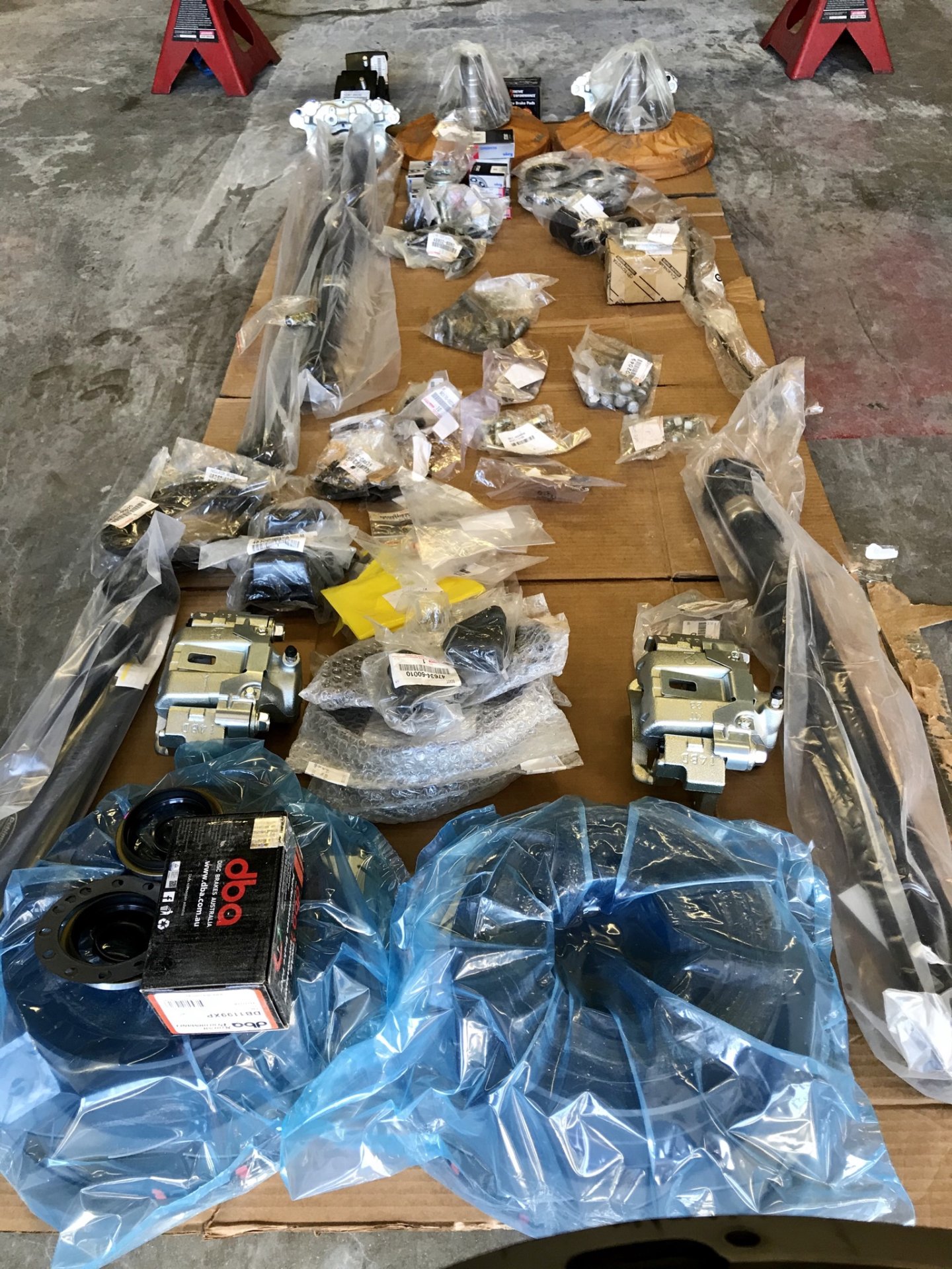

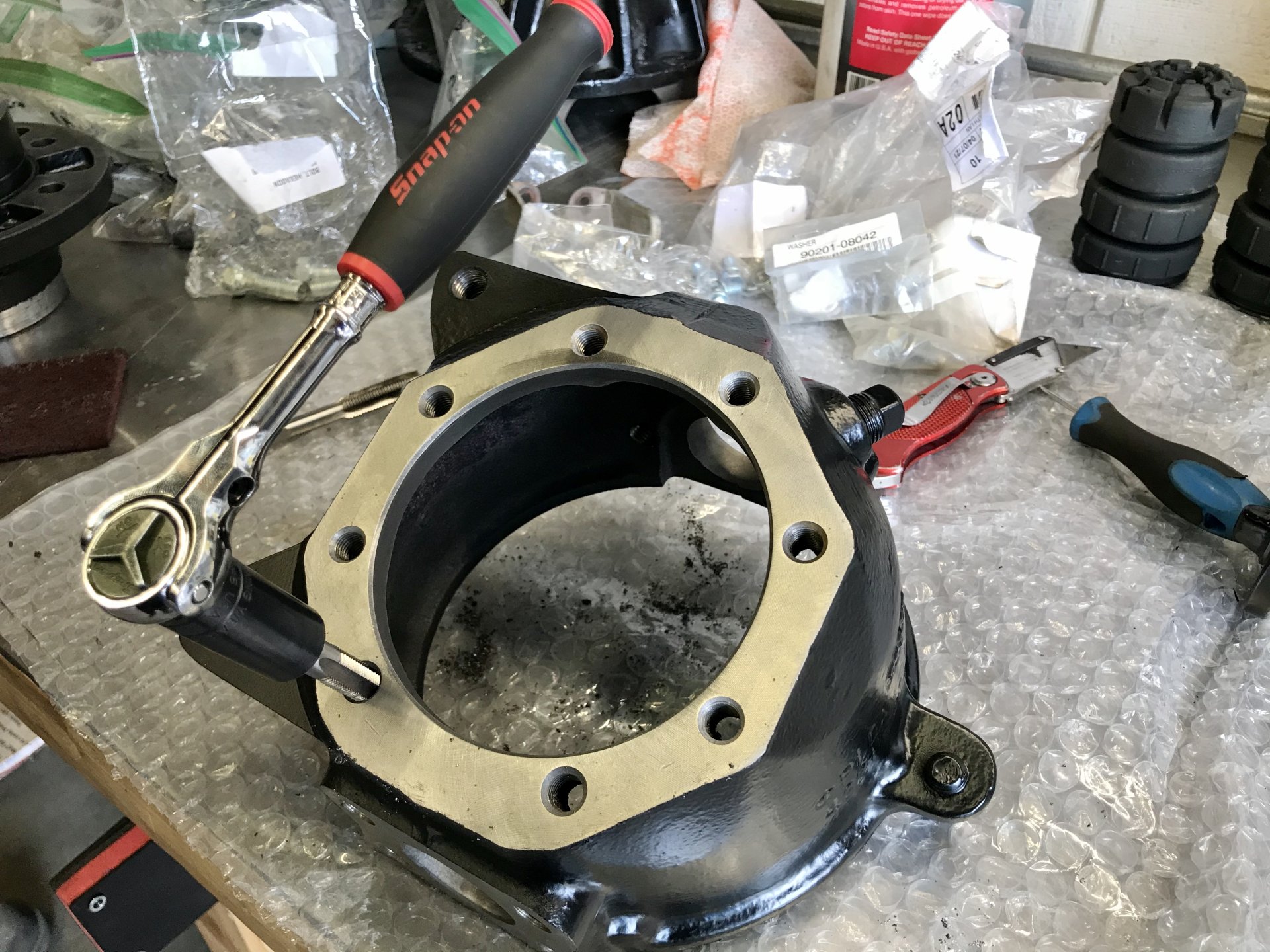

Couple more pics for today.

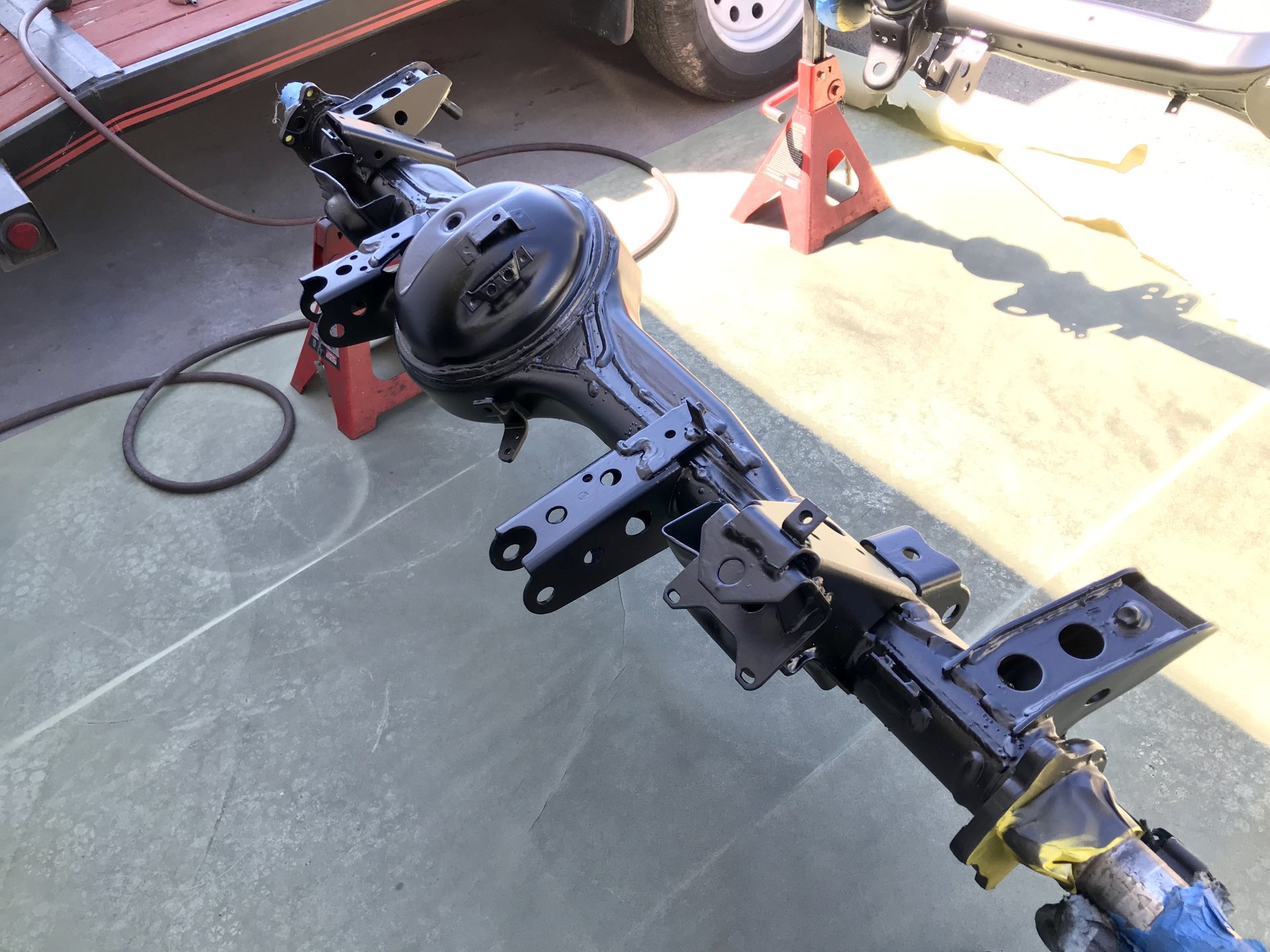

Getting all our axle parts prepped first so we can build out the axles and have a rolling chassis.

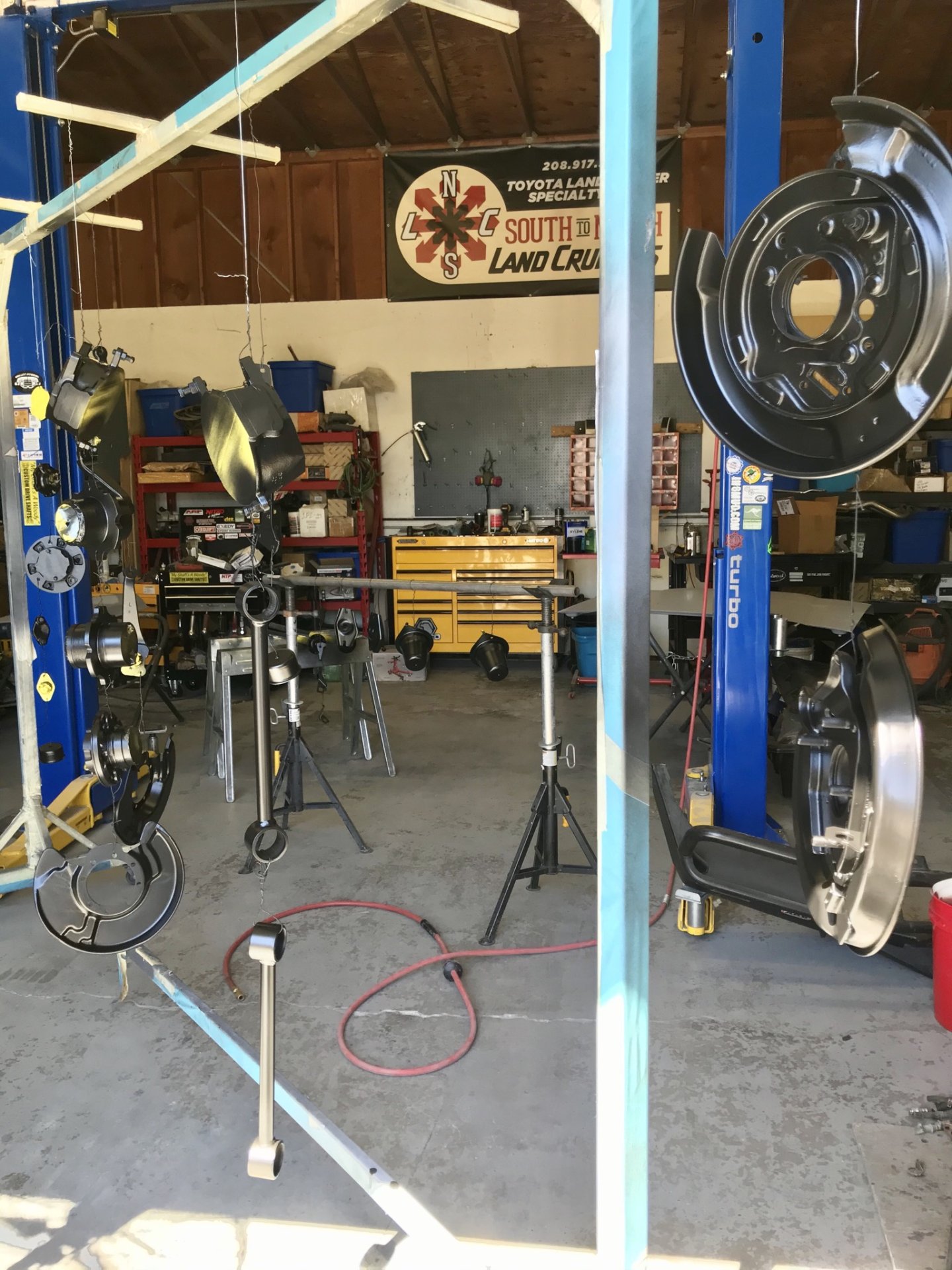

Our mission for today was to get all this scuffed, taped and painted. First coat is down.
