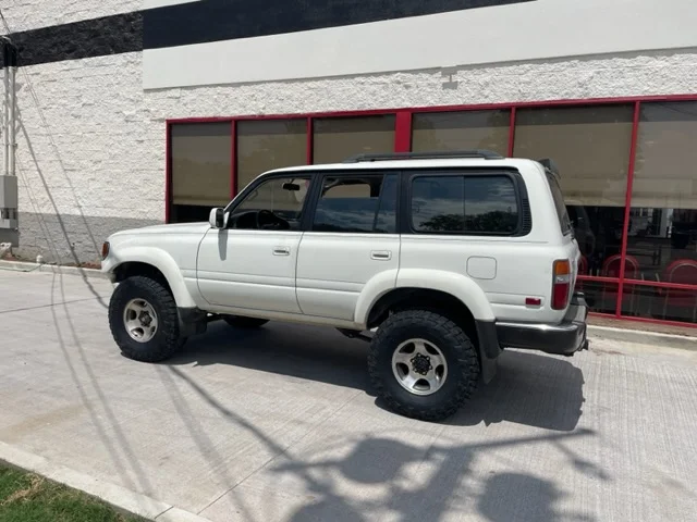

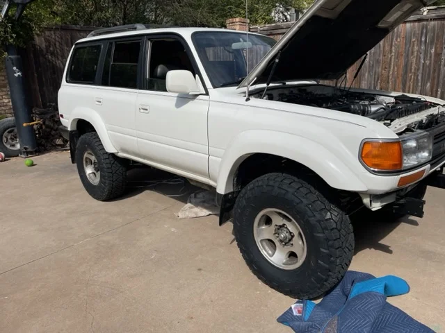

Well she’s back! She’s about done! Running great.
Still need to re-mount my from ARB bumper, I was waiting till the alignment and front end was squared up. Also waiting for a rear bumper @Delta VS Ive got your first 80 series ready to try the new design!! The weight of a rear bumper, spare tire, and gear should settle that rear end down.

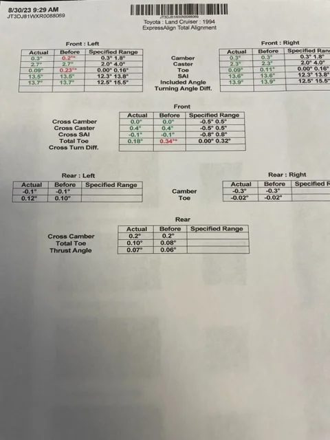

Here is the screen shot of my alignment. 3 inch Dobinsons with Delta 3” radius arms. Seems good to me! But I also don’t know about this that much.

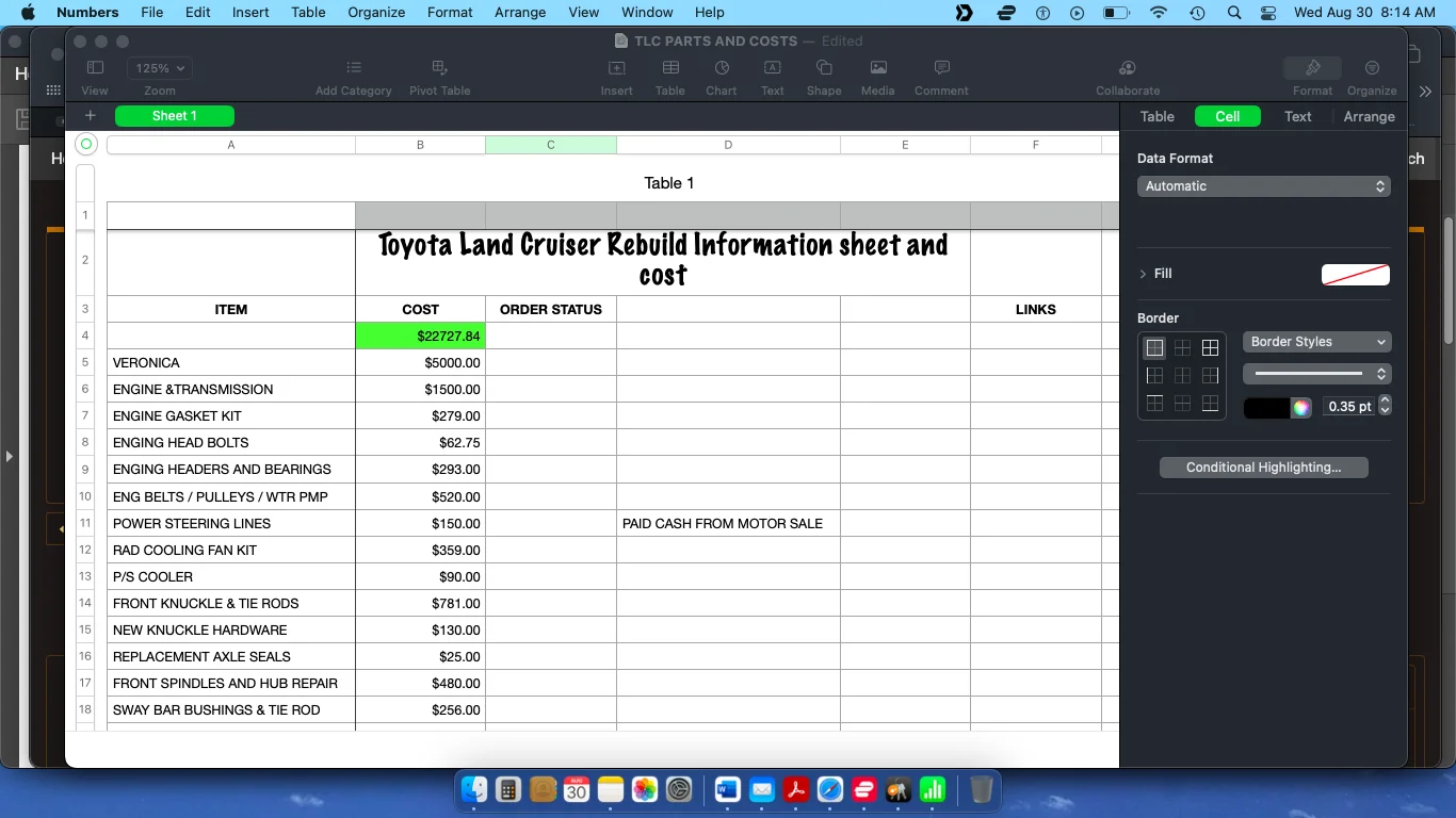

Well I changed the LSPV, not sure if it was bad or not, got it swapped out, bled and bled. I put it on all 4 jacks, and took pressure checks at the calipers. got 1500psi in the front and 750 psi on the rears. Pretty close to specs, i also didn't read the gauges exactly. I put the tires on while on all 4 jacks and put it in gear and used the brakes several times. The rear brakes were engaging. Put it on the ground and drove. Seemed fine, so Im moving on from it for now. Brakes feel great. Just a few items more items to go. Need to get the a/c lines made and serviced and seats recovered. Plan on using L-seat coverings. So I updated my cost tally, Im at $22,700 all in. Well see what the final tally is.
