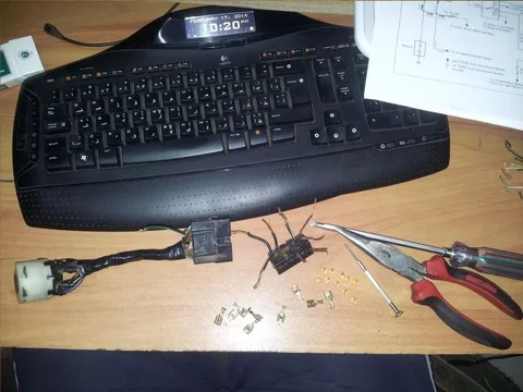

Homemade Crimping set
the heat is on.... homemade crimping using female pins, pliers and a screwdriver.
once i get the wires on....crimped, i will add soldering and wrap in tape.

as far as your wiring goes, how about just ditching it altogether and making your own harness with a painless wiring fuseblock. I'm not sure the availability of their product where you are, but I did that on an old 81 toyota truck and worked great. super simple and easy to do!
www.painlessperformance.com
this is what im doing....im even building my harness based on the 90 model. Simple and clean...especially that mine is a diesel with a mechanical pump. Went today to look for a relay/fuse box in the second hand area, just couldnt find anything complete...either top is missing, body is cracked or too poor a product....will have to refurbish my old one.

went today to almost every well known car/electrical/industrial shops and they all replied....why not just tape it.....:doh:
im very grateful...i just to figure out the wiring im going for and if i need anything i will surely message u.... will need a shrink wrap set, this i know...which one?....well....the easiest one u can get a hold off....for the crimping im going old school (or as i said before...Hajji style)...good old pliers.

Went and got the wires and terminal ends i needed....found a second hand industrial wire harness enclosure (or whatever its called)...
yesterday i printed out the RM184E jan 1990.....no ECU, CNN or MSNBC things.....just plain and simple..
once i set my wires down..test everything is fine with my ohmmeter....will take them out...crimp them, wrap them and then start on the interior.
