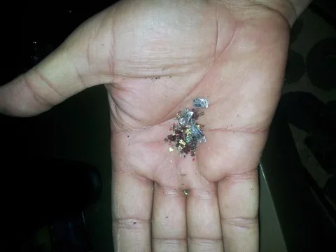

one of the burnt fuses that melted to the RB2 case
ok...so....not stopping or giving up...i finally got the fuse box and RB2 terminals out (except for the melted in ones, 3 of them)...but couldnt remove any of the relay terminals in RB1......any help anyone???

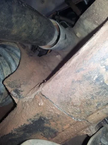

Any more info on the cracked chassis? Location? Maybe post a pic.
chassis
This thread is awesome.. I will be cheering you all the way till the truck is finished.
thanx for the support....:popcorn:
before

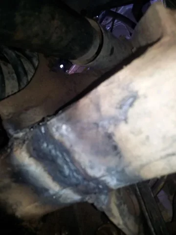

after...a temp solution till i get the engine out for paint...waaaaaaay waaaaaaay later
the guy used around 1 meter of TIG (or whatever its called) to weld all round, top and bottom...i know i needed a plate, but i just wanted a quick solution so it doesnt expand or even break

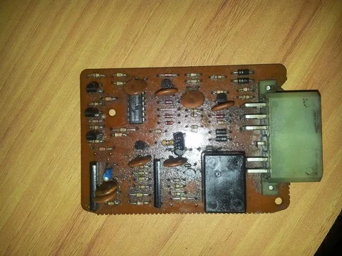

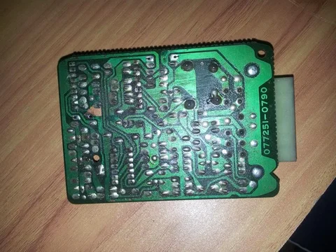

what is this???
so..im gathering all the relays, ICs, fuses to see whats working and what needs renewal...but....dont have any idea what this is...has no box...was in the glove box
Audio amp thing ???
