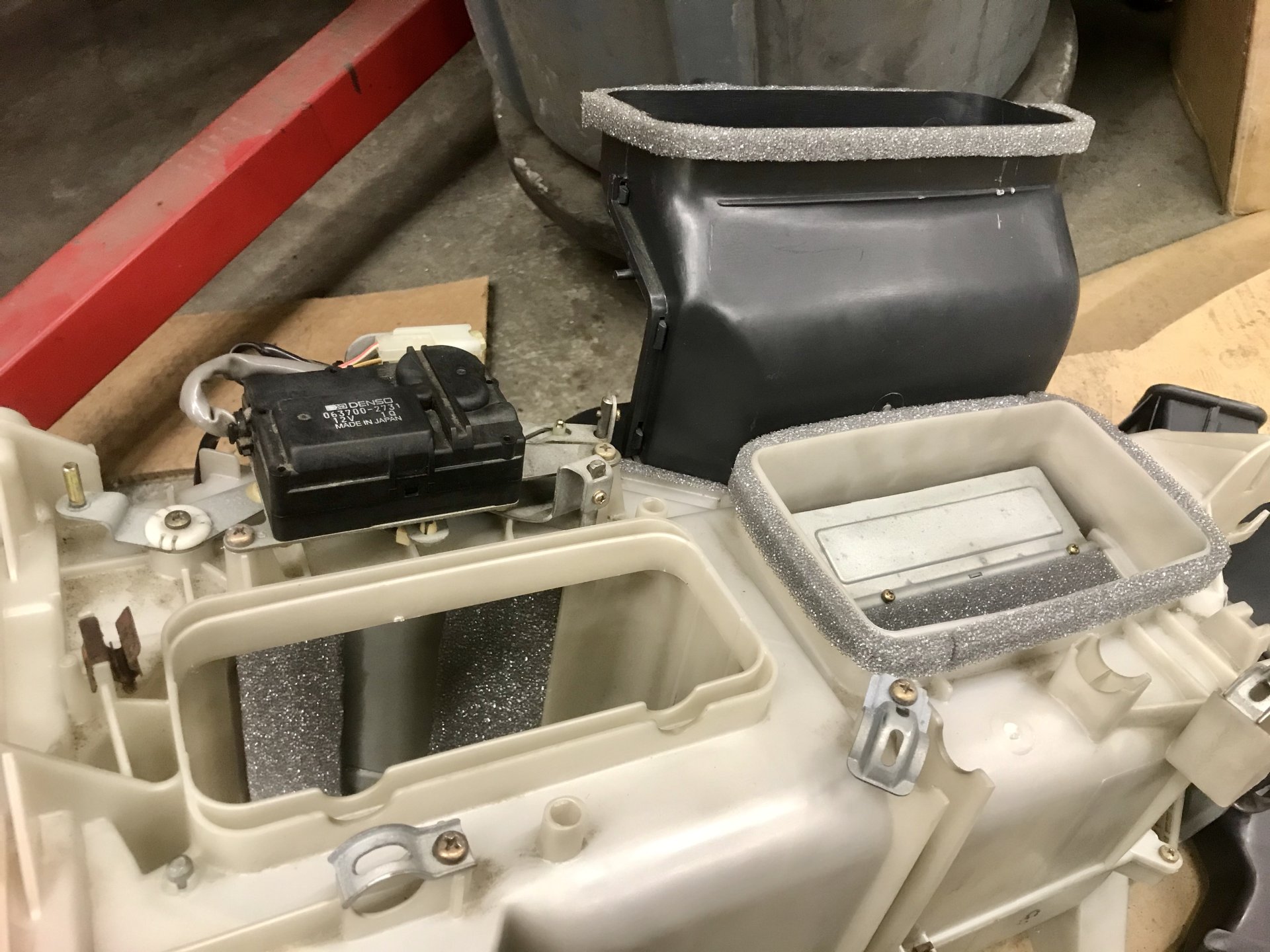

Got the HVAC system all ready to reinstall. Flushed, pressure tested and fix the heater core hard line that was deformed. I just need the firewall grommets and the thermistor to finish it off.

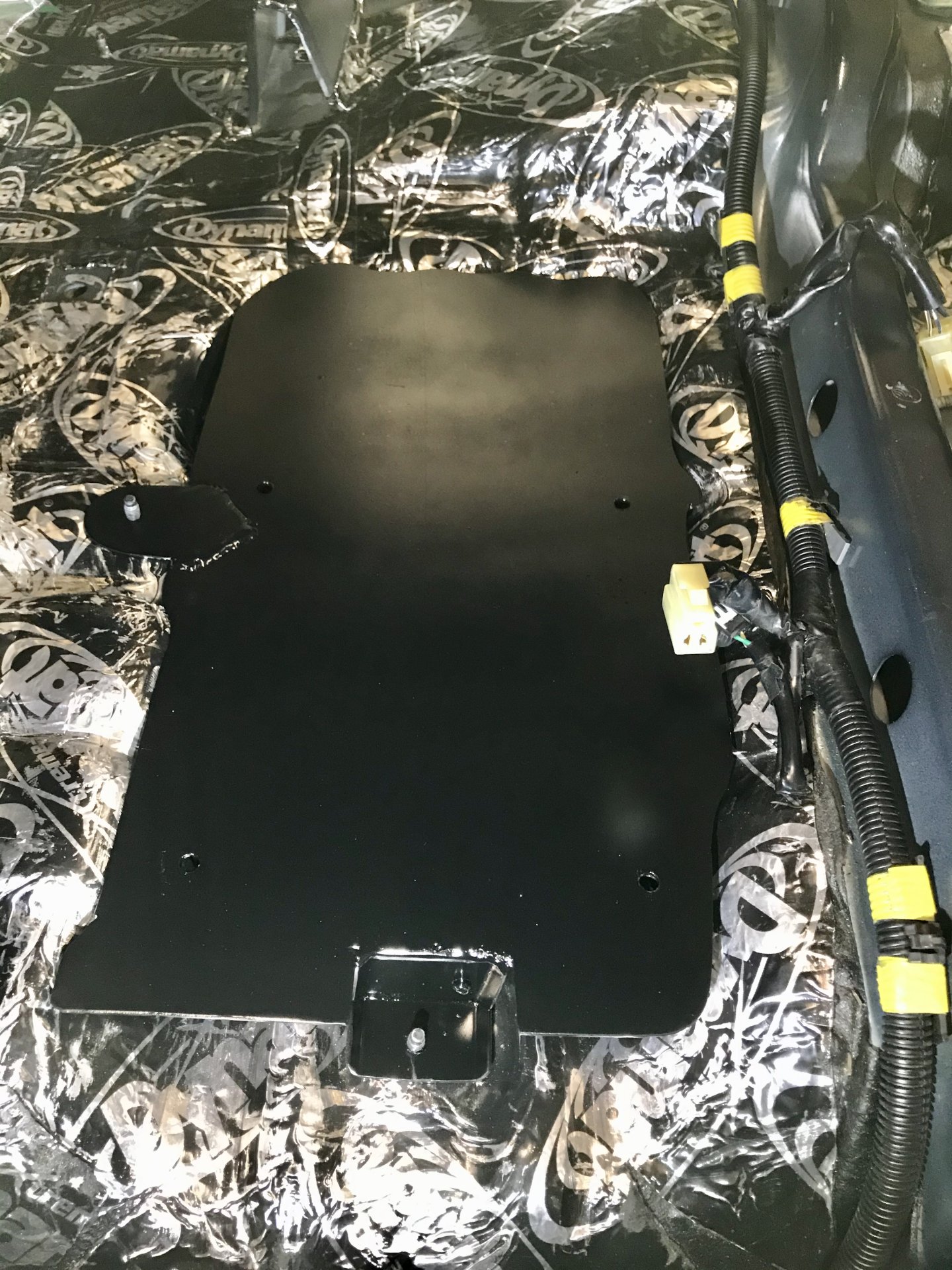

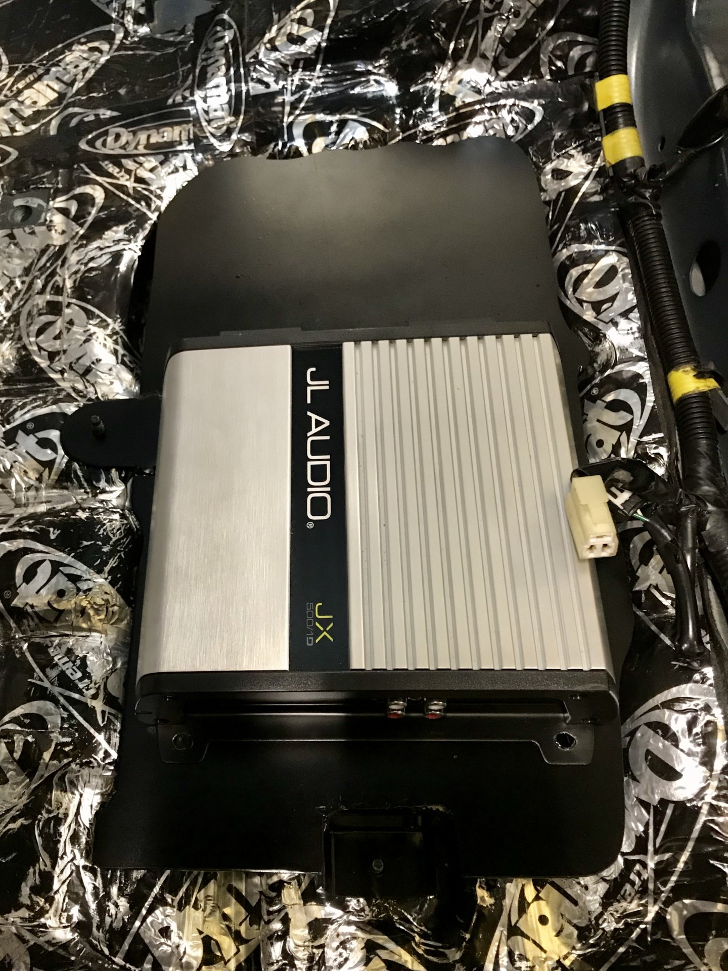

Started making my mounts/brackets for the sub amp and mount for the amp circuit breaker.

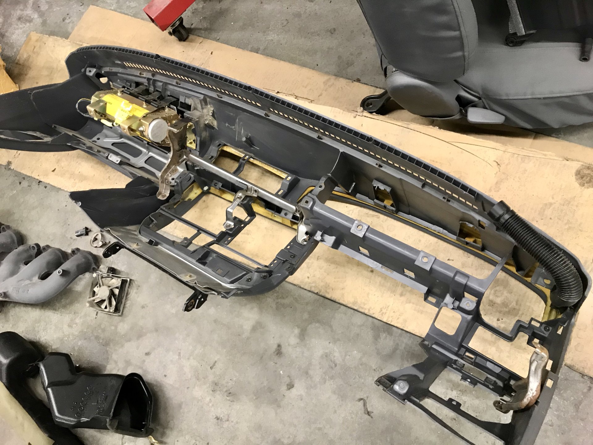

Getting dash pieces ready to install.

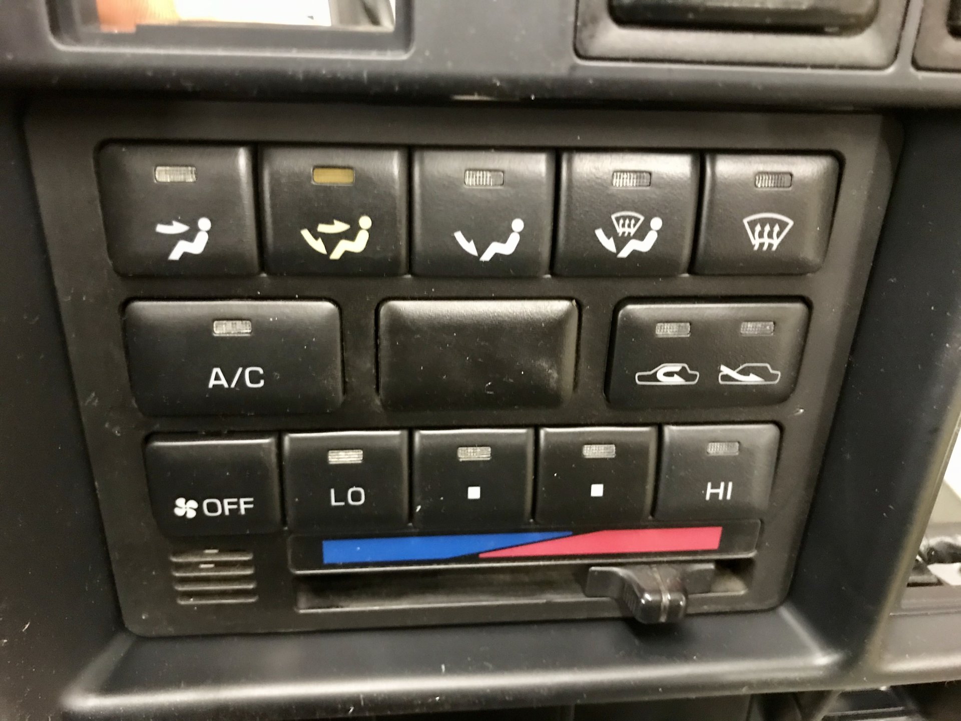

Still missing one button on this refresh, can you tell which one?
Getting the backside of the dash all cleaned up.

Is this a all new parts build or are you cleaning / refurb parts and putting them back?
Both.
Dash/dash pad is not new, it is NLA. A lot of trim, dash vents, ect are new.

Foot/face.

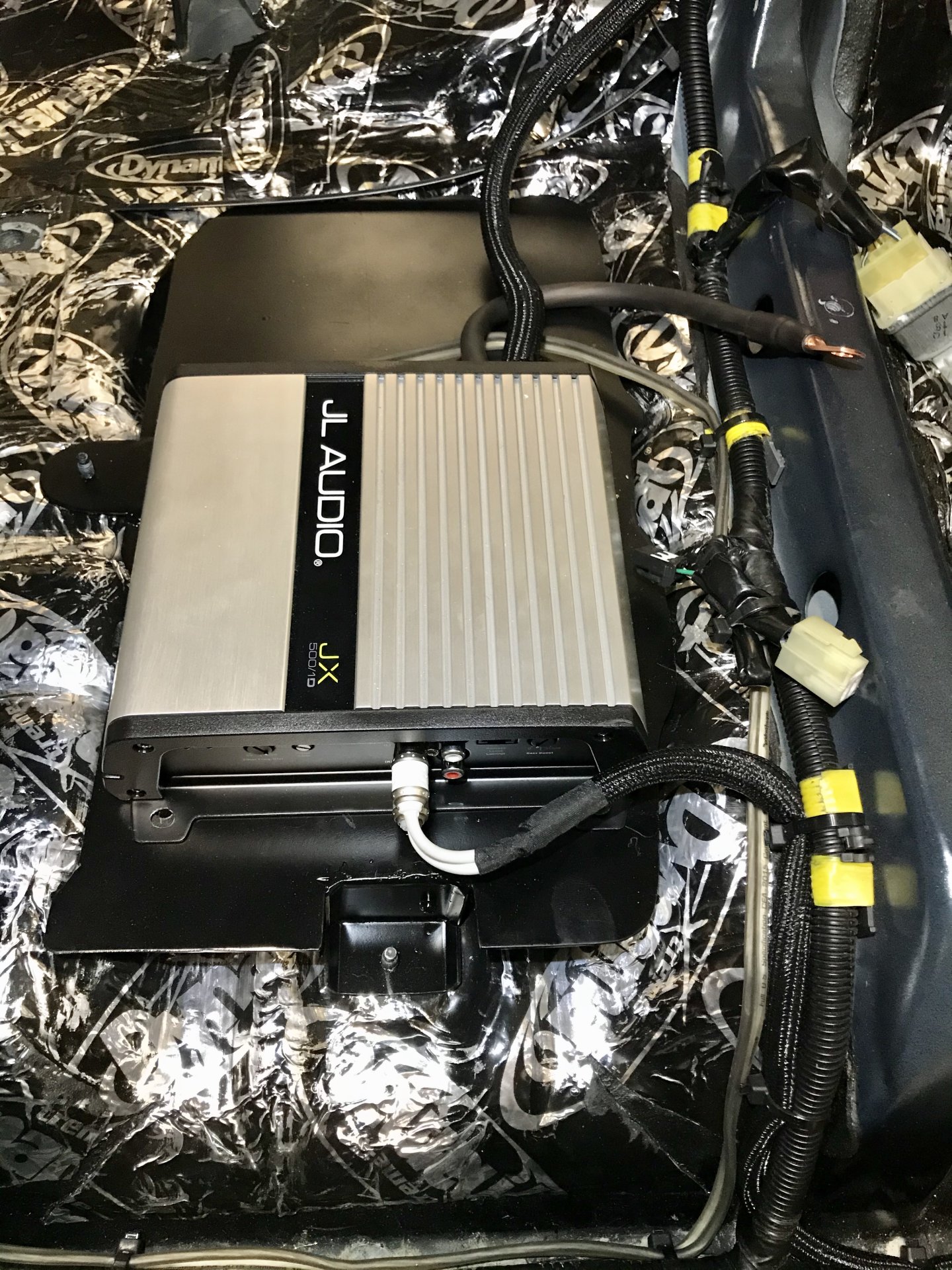

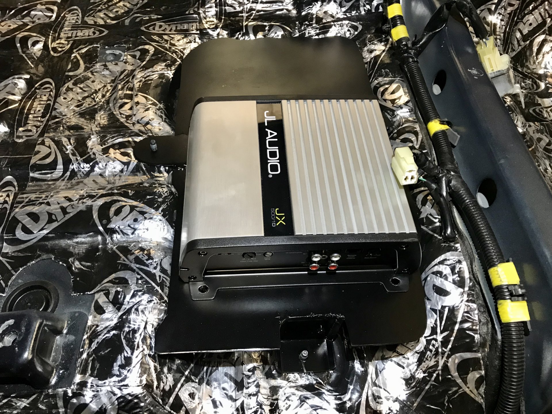

Just about wrapped up on sub amp.
Ran these with the factory harnesses all the way to the head unit.

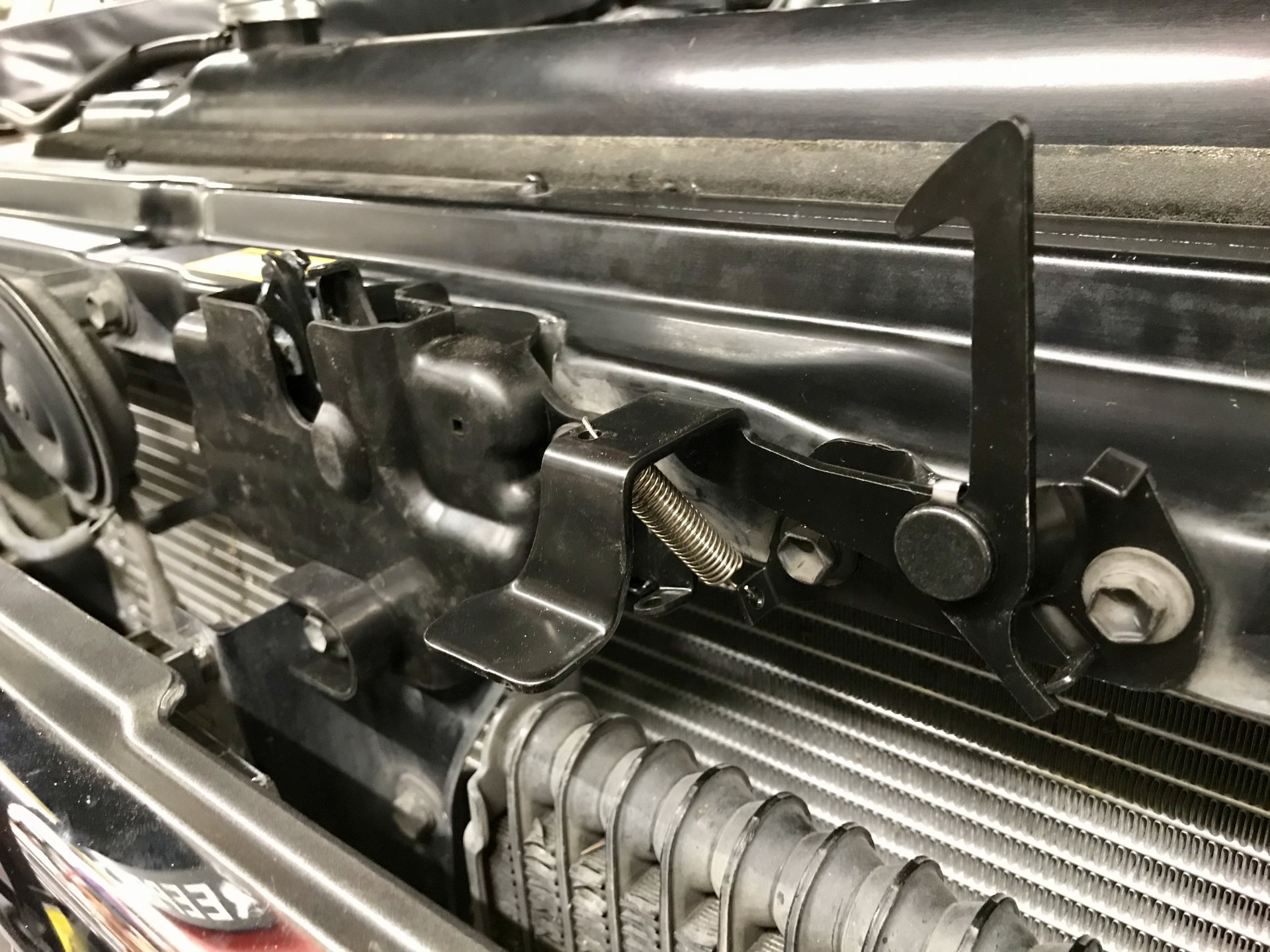

New hood lock and catch.
